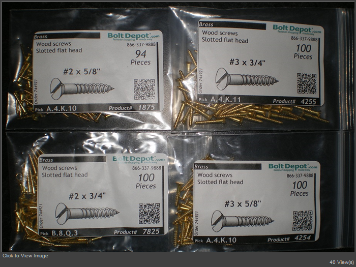

Offline analogmike
#12 Posted : 18 February 2017 18:06:31(UTC)
analogmike
Joined: 02/08/2014(UTC)
Posts: 816
Location: NEW JERSEY, USA
Bolt Depot.com USA
I just ordered these not long ago. Good company.ThumpUp
I think I paid $25.00 for the lot.
Mikey
