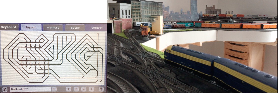

#4 Posted : 04 February 2017 01:18:47(UTC)
midwestbls
Joined: 04/06/2012(UTC)
Posts: 76
DCC (digital 2-rail) can manage the reverse loop short easier than when running analogue as the digital system can sense the short and correct for it (vs. having to throw a manual switch), BUT you still have to isolate and separately wire to the section that reverses. 3-rail in digital is still much simpler, cleaner in wiring these reverse loops - there's never a short to have to plan/isolate/wire for.
I was long a DC guy especially because, "Real RRs don't have bumps in the middle of the rail ties" ... I made a complete switch to 3-rail a few years ago because I simply could not deal with having to worry about the reverse loop shorts, even while trying to move to full digital. I wanted "plug-n-play" ease! I also needed a layout that I could assemble, disassemble, reassemble with several moves, and I wanted to physically play and experiment with different design ideas along the way. C-track is ideal!

With wiring, It's not just about reverse loops. Try wiring something like this photo in 2-rail, then you'll understand the attraction of 3-rail. And why yes, I used to be a big-time "rivet-counter". Until I started looking into laying track...
Those huge flanges and pukos started looking pretty good at that point! Then, there was programming all that DCC stuff, especially back when it was in its infancy. No thanks! Then, a dealer showed me something called MFX...
And folks, I do a large amount of electronics repair and DIY for extra income. All that wiring was too much like work! Sometimes you just want to run trains!
Likewise:
