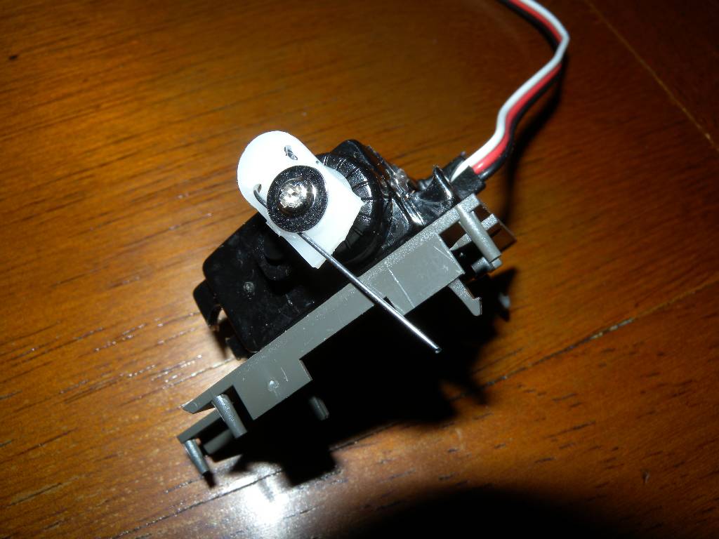

Using servo instead of solenoid motors in C track turnout requires precise positionning of the servo under the basement.
Here is a solution that avoids that difficulty: it consists in fixing the servo directly on the turnout. That necessitates a rather big hole in the basement, but does not require any precision. Furthermore, that hole is smaller that the one many modelists make for fixing the standard solenoid motor, leaving the point in place.
If necessary, the servo can be removed for fixing:
Fred

So, as I see it, you have mounted the motor on the plastic cover of the point mechanism, is that correct?
How well does it work, i have wondered about doing a similar thing myself.
Yes
That works perfectly, but, as it's new, I can't say anything about reliabilty. I guess it's at least as reliable as the mounting under the basement which is very often used.
Fred

That looks exactly like what I should do to replace a number of failing Märklin motors in my hidden station area!
Do I see it right that you have preserved the spring loaded action of the blade so that points can still be taken backwards without being set?
Hi Jacques,
Presently, the link between the servo and the turnout is a 0.5mm piano wire, and the spring effect is too strong. I'll make some trials with 0.4 or 0.3 mm piano wire in order to improve that function.
Fred

With a 0.25 mm piano wire, the spring effect is roughly the same as the original one (i.e.without motor or with marklin motor).
I think that a 0.3 or 0.35 mm should also work
Fred.

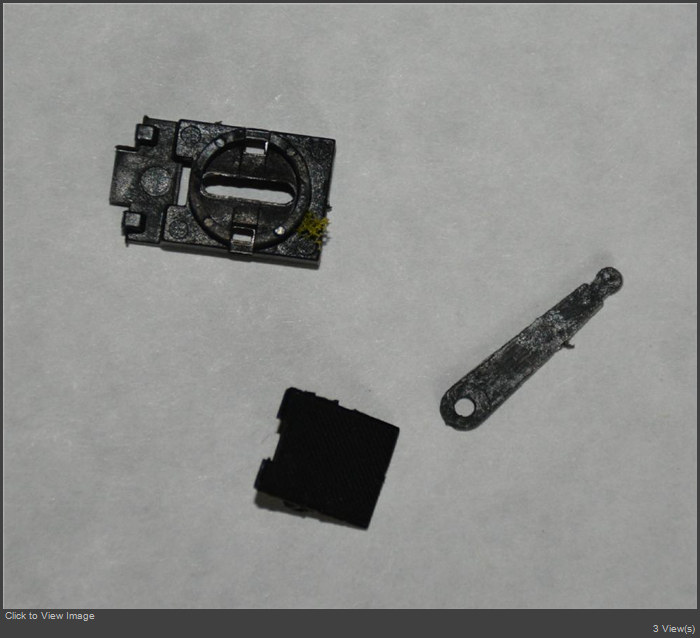

I was not aware that Marklin did an under board adaptor for C track. Do you have a reference number for this?

The under board adapter shown is for K track, and I have used these extensively with servos. Marklin do not manufacture an under board adaptor for C track as the decoder and switch mechanism is already hidden beneath the plastic housing.

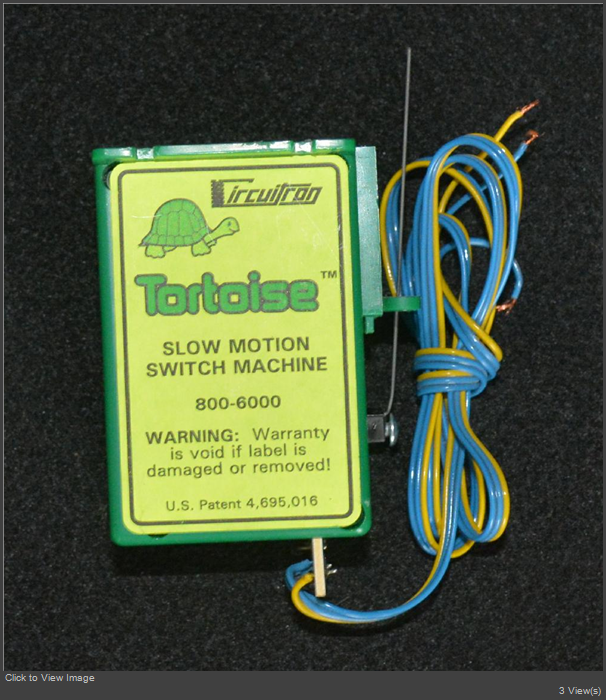

For switching when I want to hide the motor/solenoid actuator I use Circuitron "Tortoise" motors with the Marklin under board mount adapter.
I don't like the Tortoise switch motors, they are LARGE (the picture shows around full size on my 16" screen, YMMV), and they are expensive, last price i saw was around GBP40 each. We have them on a couple of club layouts and I have found them a pain to get aligned correctly so the points throw properly. Agreed some of this is not the fault of the tortoise motor itself, but the way it mounts gives minimal, if any, throw adjustment.
Hello KiwiAlan,
Speaking from years of personal experience, I must respectfully disagree. Yes, the Tortoise switch motors are large (compared to a servo), but I never had any issues finding room for them under the plywood sub-board. I have over 50 of these on my layout and never have any issues with reliability. I've mounted some of my Tortoises more than 12 inches from a turnout with excellent reliability. Using tiny piano wires provides many options in mounting positions.
