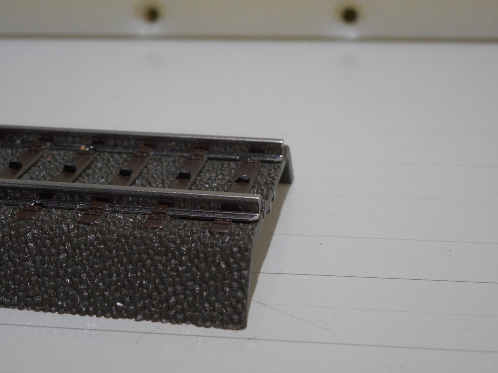

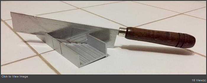

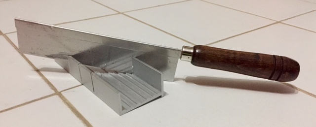

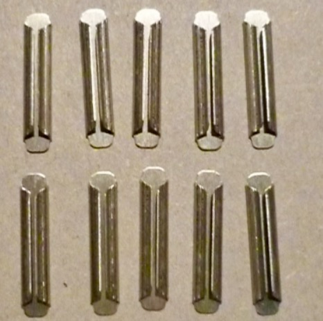

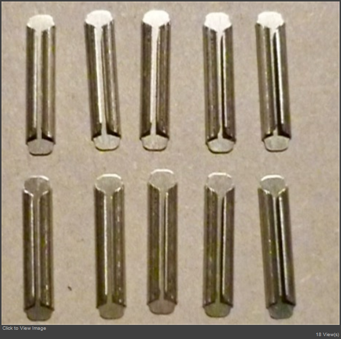

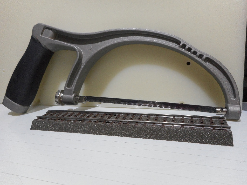

I agree with my previous speakers. However, in case you insist: I used this saw to obtain a straight cut.
And I used K track connectors to fix the resulting mess.

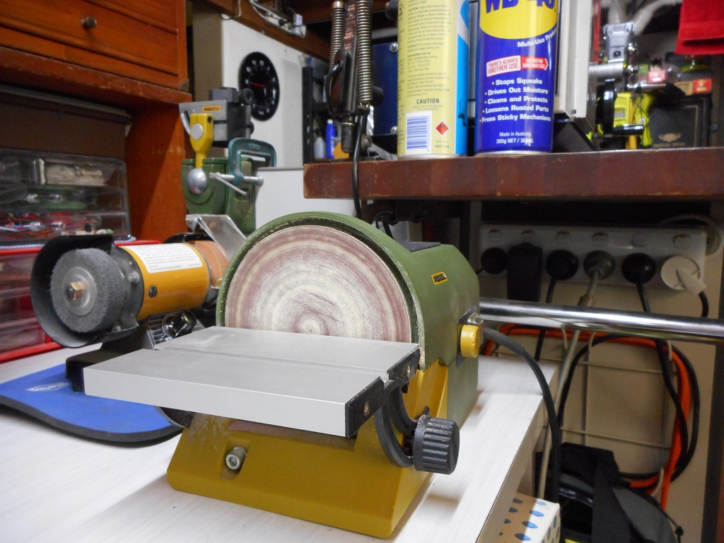

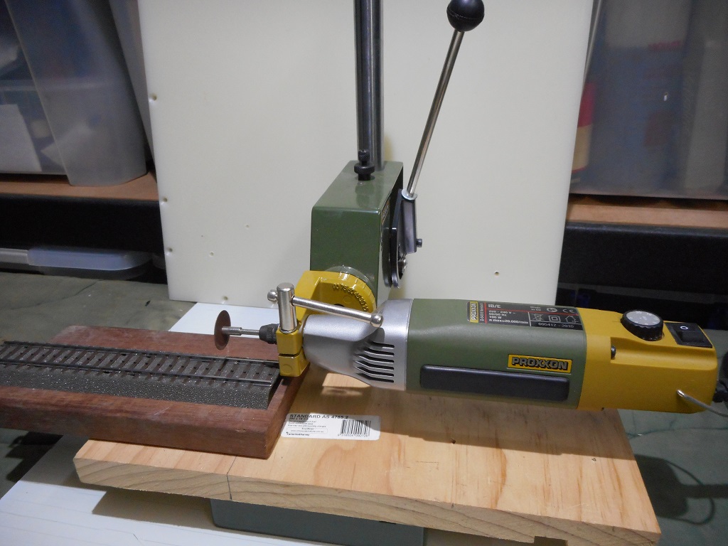

I have had occasion to cut a. just the track and b. the entire piece of track.
For the former I use the following setup with a thin cutting disc. I cut two pieces this way about 4 stud lengths from the end then join the tracks. This forms a short detector track with the marklin spade connectors available under the track for the contact wire.
This gives a nice fine cut which can be controlled so as not to cut the plastic bed.( the cut is just visible to the right of the shadow on the track).
For the latter I have used a drop saw with a cutting disc but care must be taken not to overheat the plastic. I have also used a fine bladed hacksaw as shown. I found the track wrecked my balsa saw in short order. I usually screw the track down via the Marklin provided screw points. Once cut I fine tune the end with a facing sander.
I had to sort out this method to cut precise track ends on my transfer table project.
