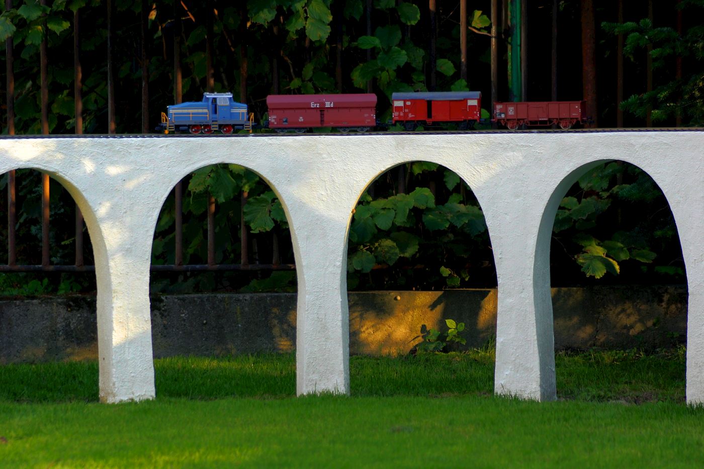

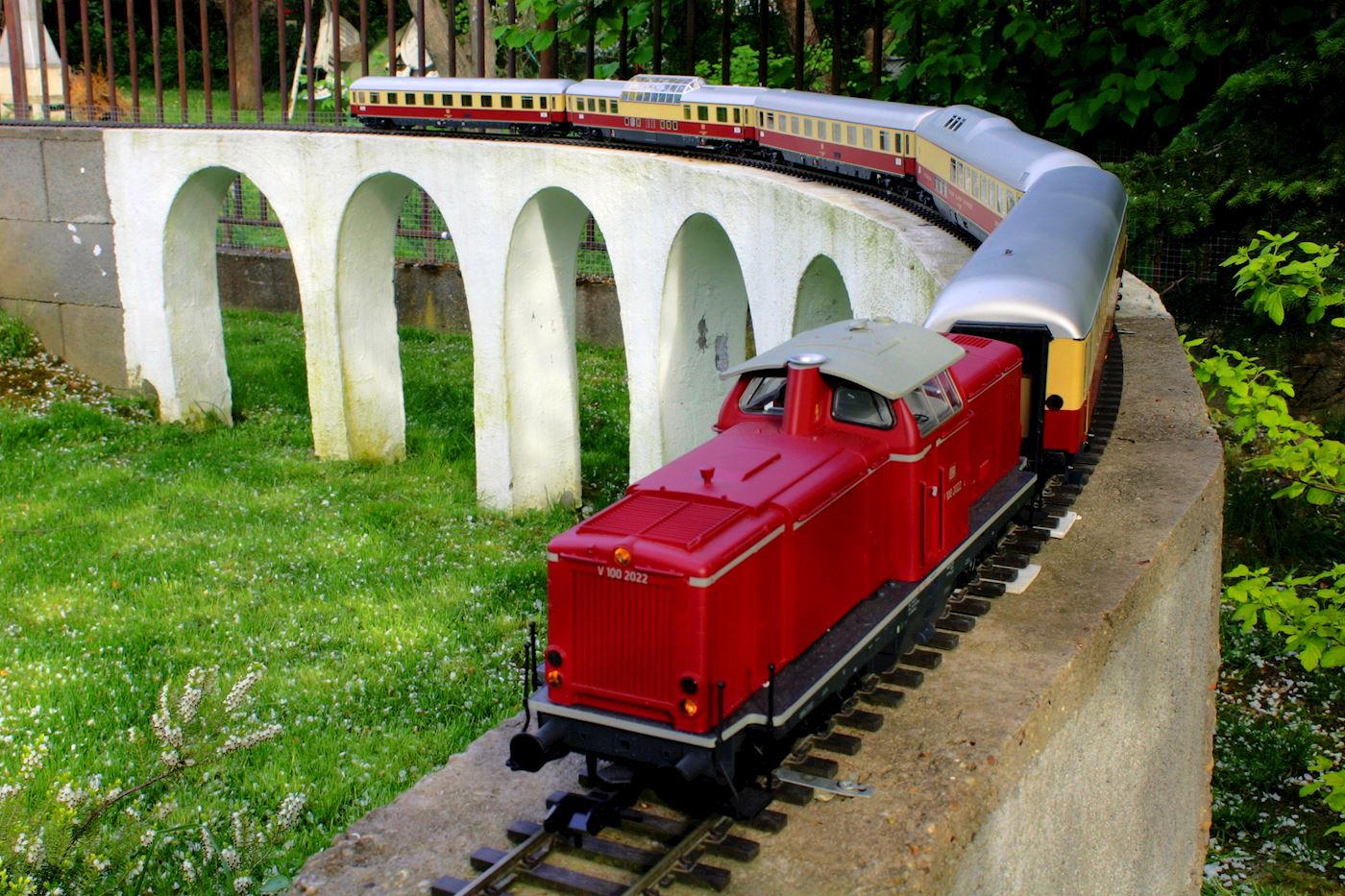

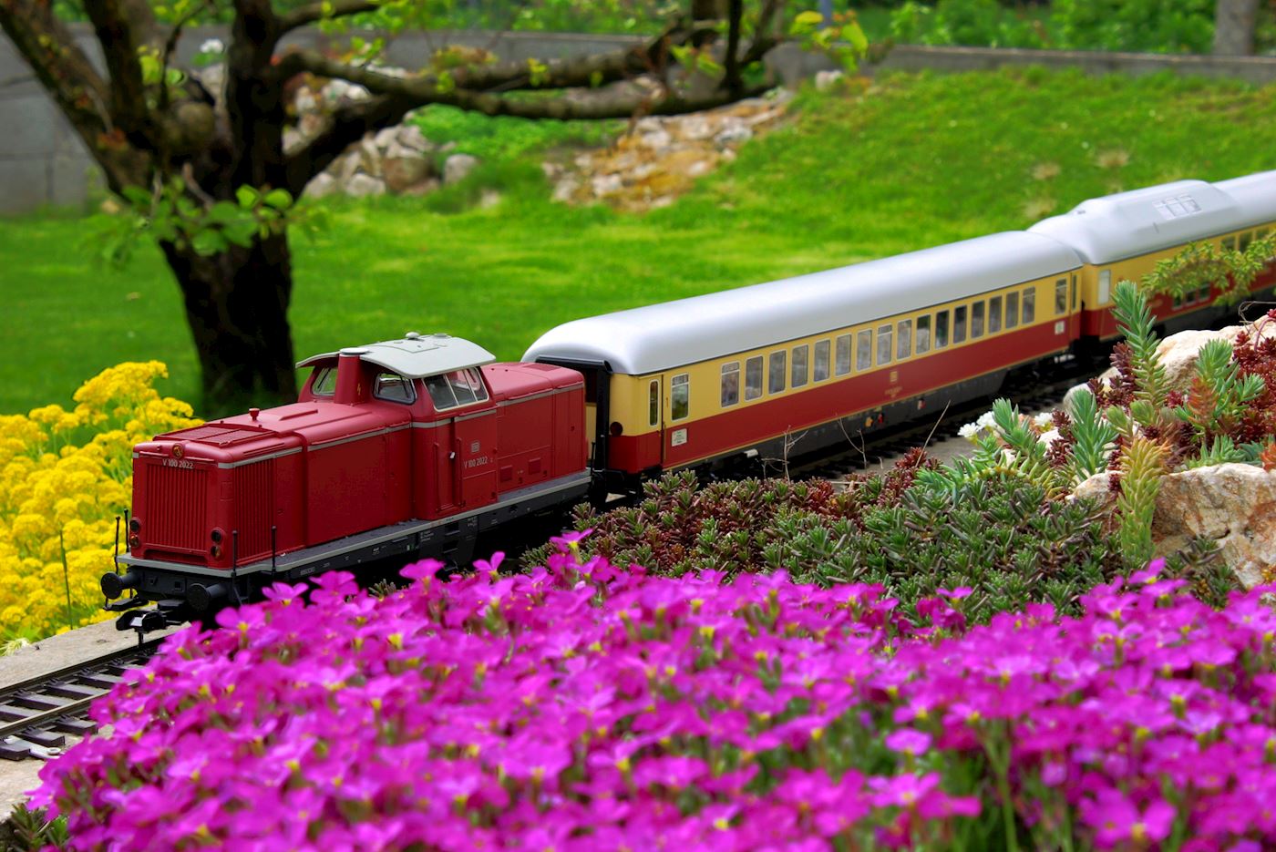

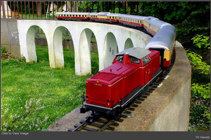

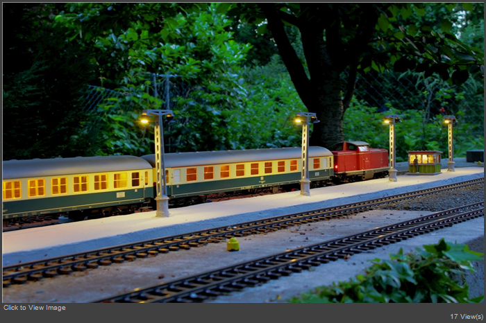

Yes sir, I don't mind if I do.
I don't have a large scale layout myself - neither indoors or outdoors - but a friend has:

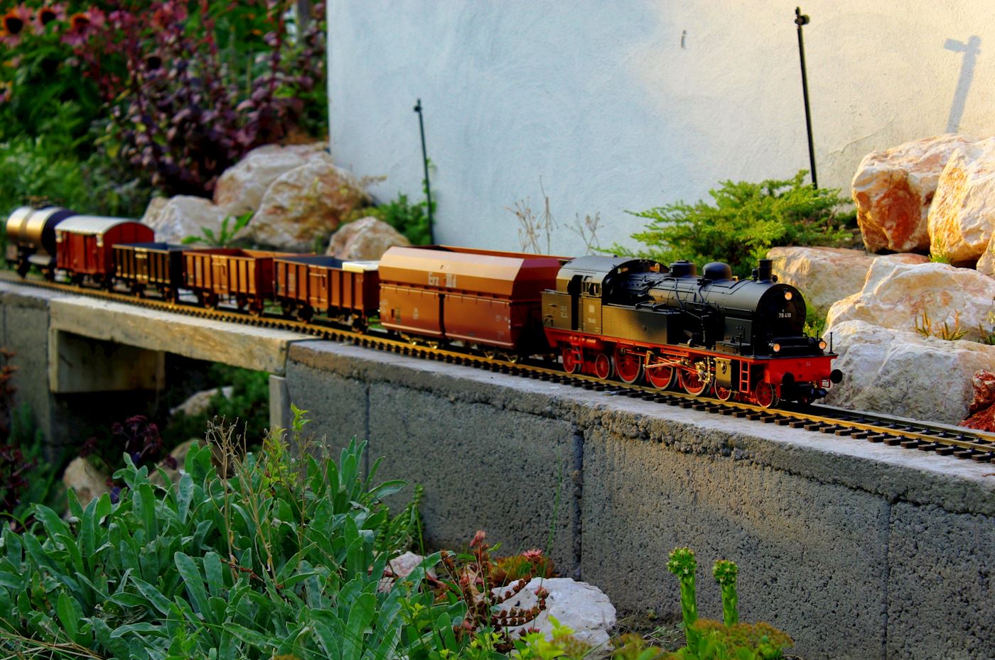

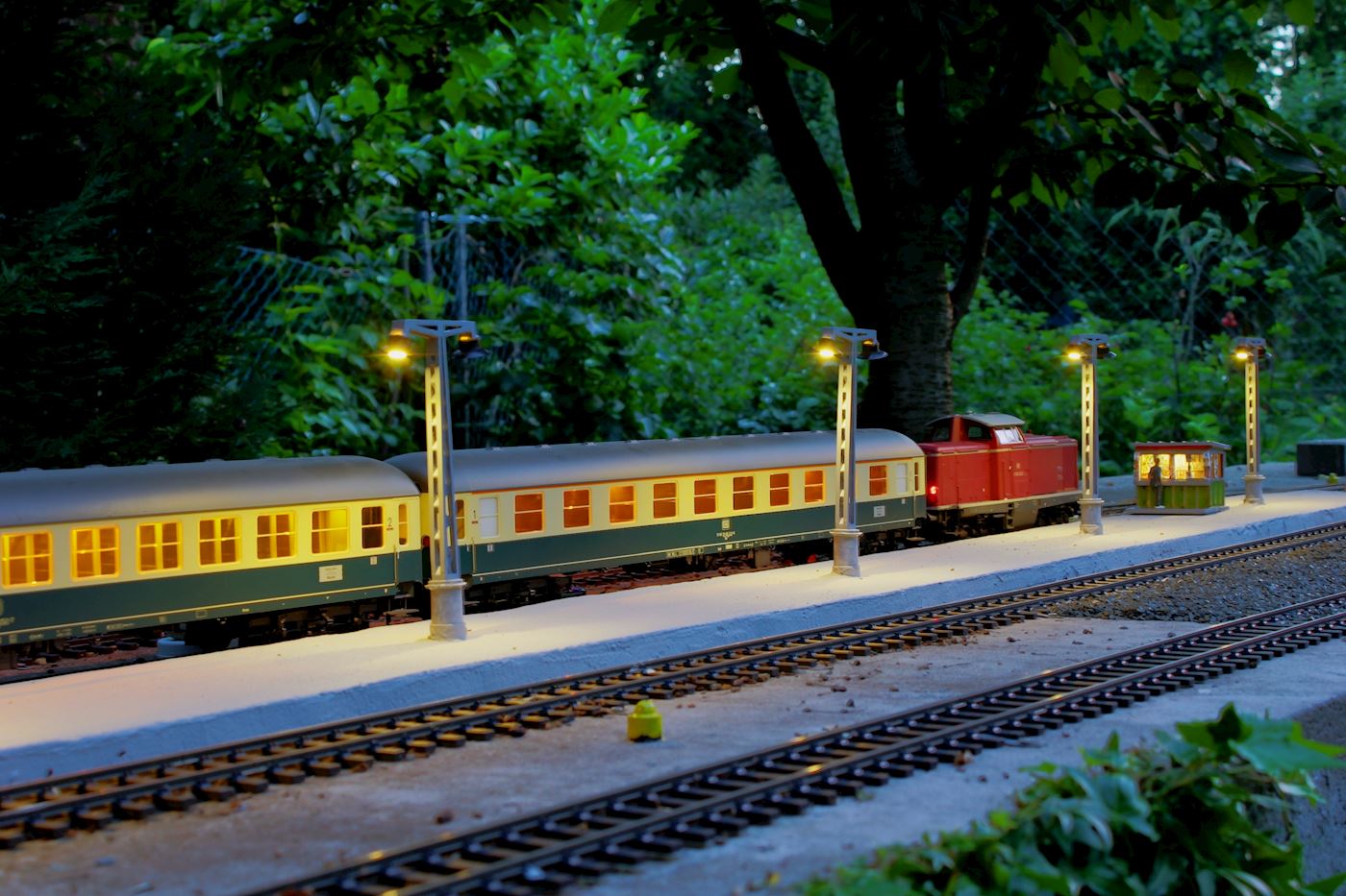

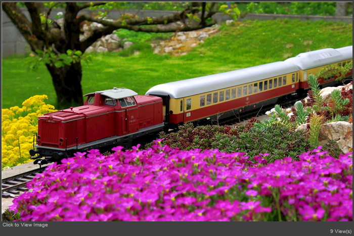

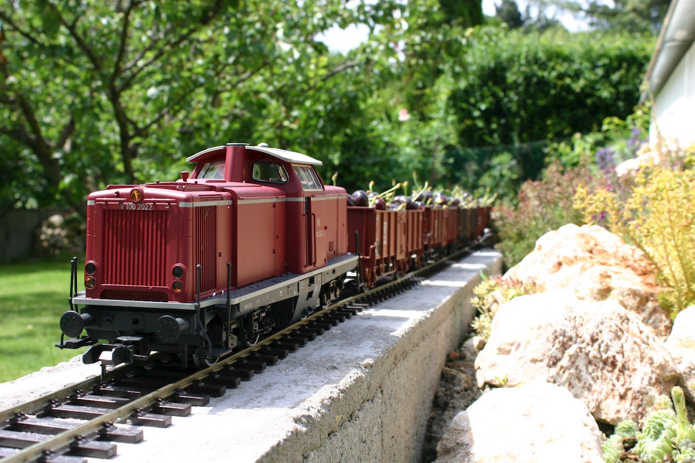

I only run them outdoors, I don't have an indoor layout. Marklin locos, and they are all fine. I did run them in the snow a few times without any issues. The wheels pick up more dirt outside, so they need regular cleaning (like once a year during winter). So far I have no issues. My outdoor layout is around 5-6 years old now.

Thank you for the very nice pictures. You have a very nice outdoor layout, done with great skill, and very attractive.
The rolling stock is excellent. Good job!
Thanks again for the pictures of your layout
