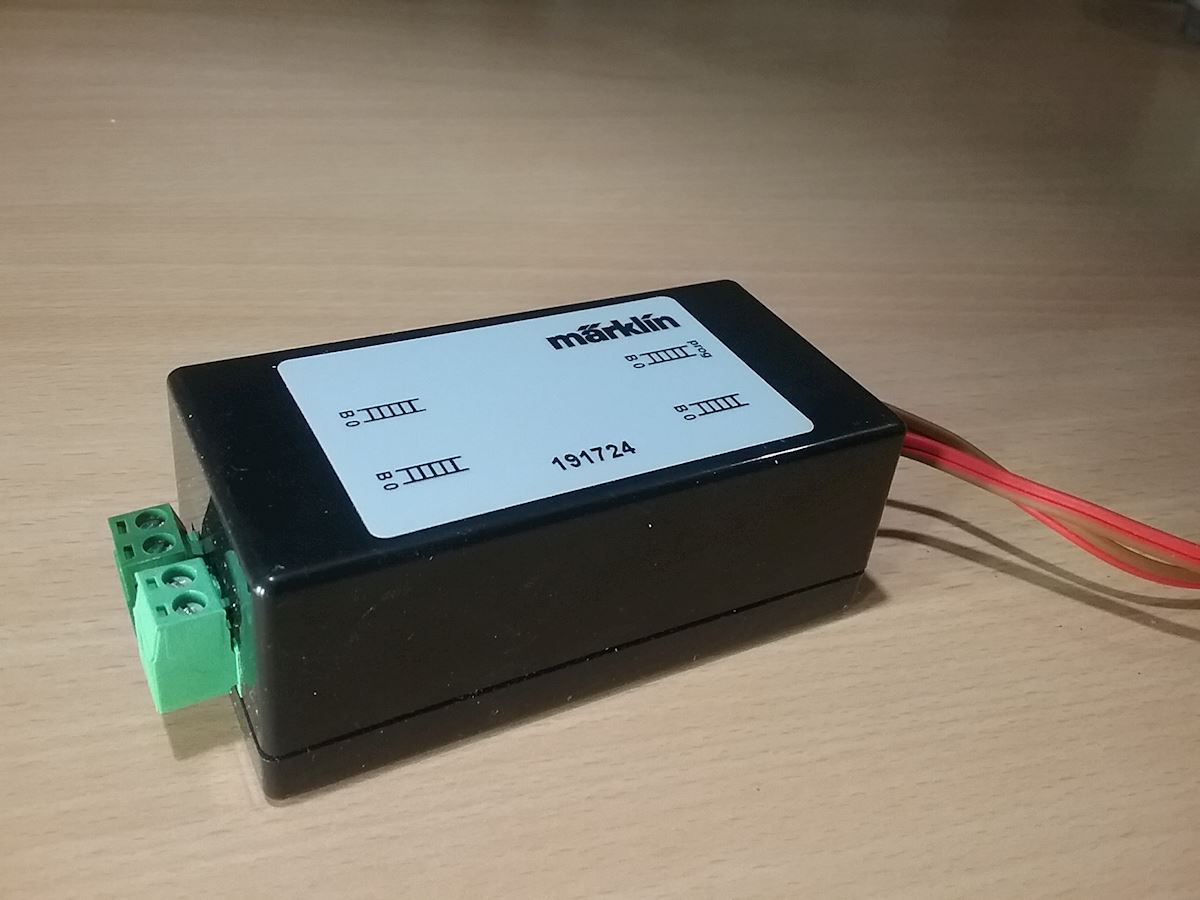

I have a question about CS2 and a black box 191724.
I connected the B and O to the tracks but I am not sure what to do with the programs. Do I have to connect the yellow and blue wires on it for lighting, turnout and solenoids in that terminal?
If not, how can I program the turnout and lighting?. It is possible to program from the Bus wiring?
Thank you guys for your help.
#2 Posted : 21 December 2016 17:03:00(UTC)
Posts: 15,488
The black box is just a radio-interference suppressor.
The two outputs of the black box, main track and programming track, can be used just like the outputs that are directly on the CS2.
See CS2 manual for further information.

#12 Posted : 19 October 2024 18:09:21(UTC)
Posts: 3,610
Here is the little I know about 191724
First a picture of my unit (opened)
Origin of this unit: a Märklin Mega starter set 29640 including 2 MFX trains, a 60215 with a 191724 RF noise suppressor and a loop with 3 turn-outs
As you can see, this is a dual filter (Ferrite cores) designed for CS2, two-channel, capable of 2 x 5A
It was designed to comply with the US market and appered around 2012.
It is now irrelevant both for CS2s and CS3s
