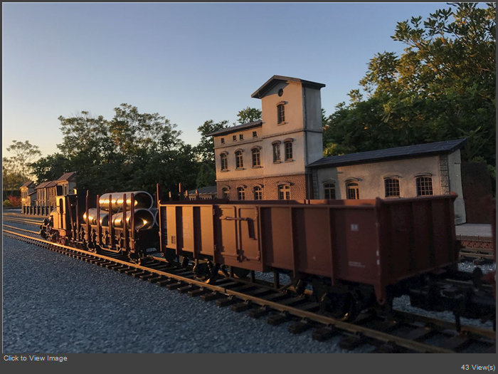

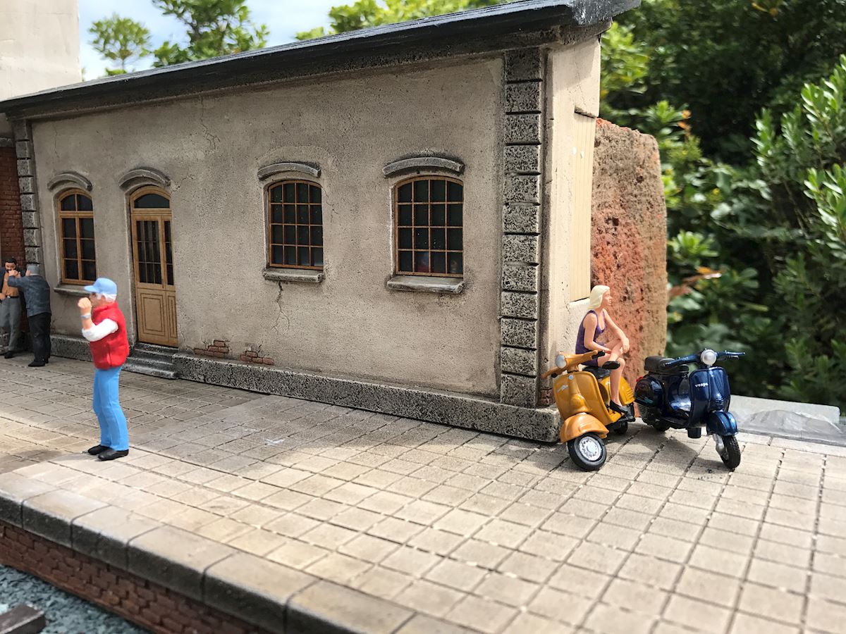

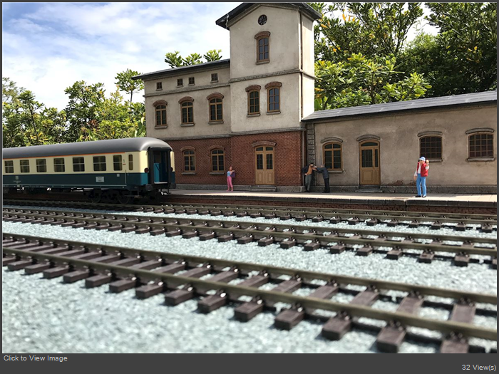

Yesterday I finished the track laying.
I want to thank for the help and all the recommendations made by members of the forum
Best regards from Chile
Jaime

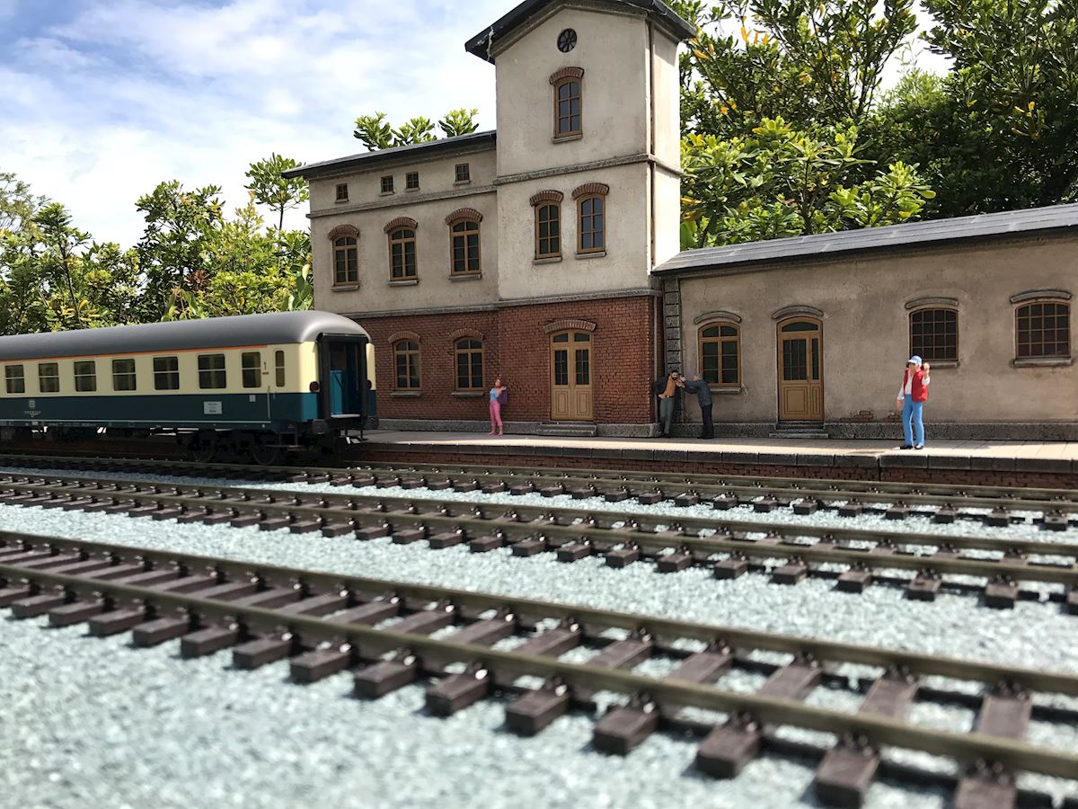

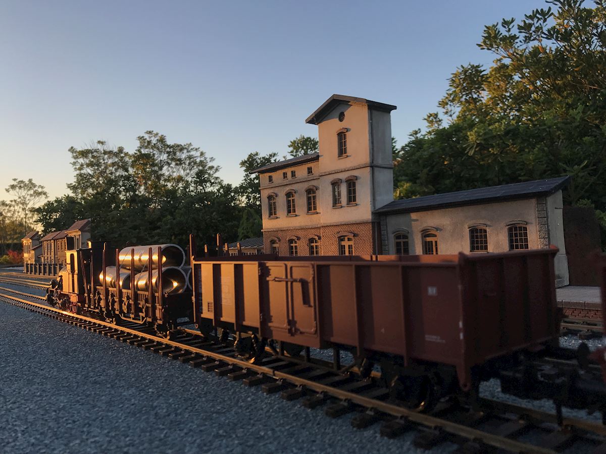

Offline Jaime
#14 Posted : 23 October 2017 11:50:51(UTC)
Jaime
Chile
Joined: 12/12/2016(UTC)
Posts: 34
Location: O´Higgins, Requinoa
thanks 9 users liked this useful post by Jaime

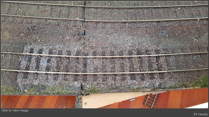

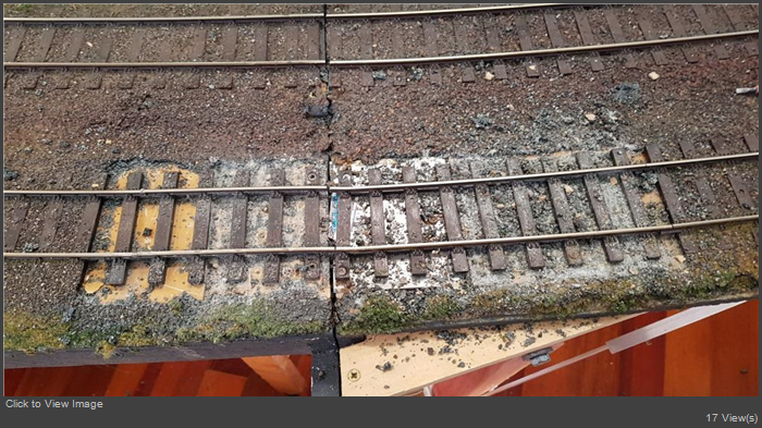

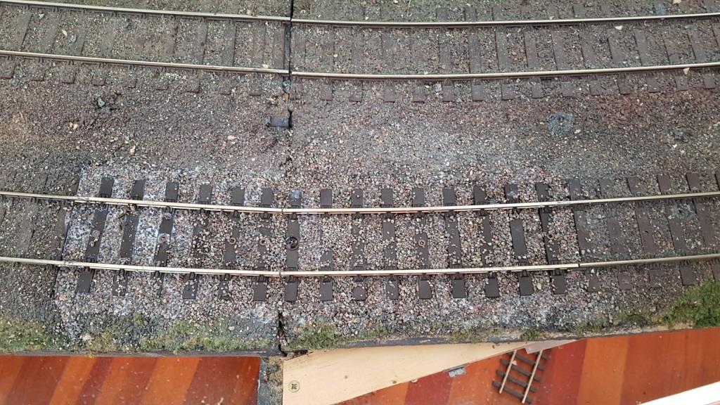

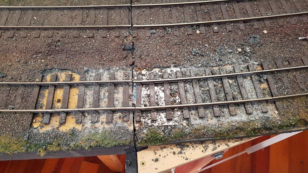

I recently replaced a length of PECO G1 track on two of our club's modules, because the join in track between the two modules was not so great. Here's a photo of what I replaced.
Note the difference between the new track piece and the old - the old is quite worn down compared to the new.

I would really like to see a picture from the side, instead of from above; or an accurate measurement of the height of new vs old tracks.

It's not so much a height issue, rather compare the rail to the right with the new piece. The edges have been worn down, and the new track rails have a more square profile.
Showing from the side won't show much, plus I don't have those photos.
OK, my understanding / definition of "worn" is that the profile gets lower and lower, or the edges are rounded.
On the top track it looks like the tracks have been damaged / bend during transport, which I don't think the PECO quality should be blamed for.
Also, I would rather have the tracks to be a bit softer than the wheels on my rolling stock, than the opposite.
No one is blaming PECO quality, I was just surprised at the difference between the new and older track, and the relative amount of wear on the rail edges.
The problem with the inner track (i.e. top) is that there is a height difference in the rail join, which tends to make locos an wagons leap and rock as they go over it, as this video from 2014 shows. I've packed it up a bit to make it much more even.
The outer track looked like it had been bent at some stage, hence why I replaced it.
