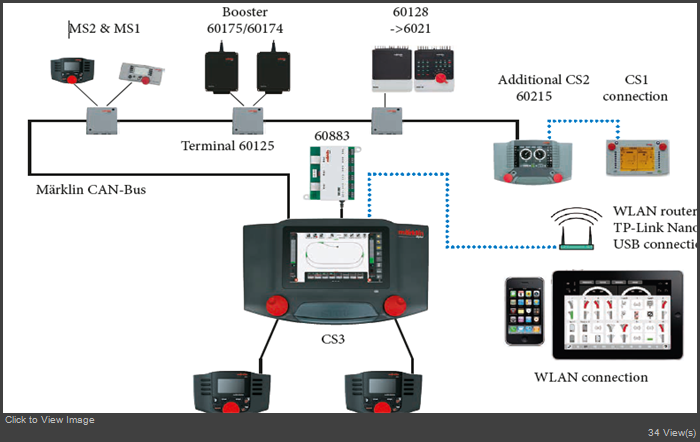

Comment: glancing sideways on ebay.de and checking for 72760, it is rather apparent, from the images posted, that some sellers have no idea what they are selling.
The fact that they may be propagating false images that Marklin had provided at some stage is no excuse. The 72760 has 4 buttons not 8.
ref: https://www.marklin-user...7-72760-Shock#post505817
