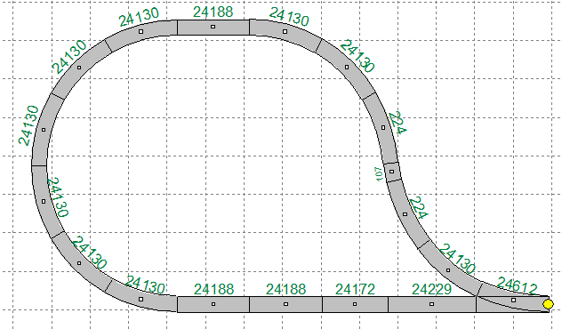

I ask because in figuring out how to configure a Christmas layout on the carpet in the room I want a dog-bone with two R1 return loops at the ends... because it fits nicely around my speakers/xmas tree and connects in front of my media console. But there is no switch for that configuration, so I had to get out the software and find a way to do it with the Straight/R2 turnout and some R2 bits, and other bits, and a lot of R1. and then deal with the tolerance error, and that the whole things geometry from the back(Top) down into the curve part of the switch is wider than I would like.
So why isn't there an R1->Straight turnout?

To get a reversing loop with a 24611/2, add a 24206 to the turnout and use one 24230 in the reversing loop and it will fit without bending.
Thanks, that would work good it seems.
Clearly I need to read up on how to get into the mindset of using C-track to do layouts, to acquire that natural understanding of what filler pieces or other adjustment parts need to be used in conjunction with the main components I want to use. There was no way to have the 'auto-close' feature work with just a big circle of 24130 and a detached 24611 turnout... I would have had to connect (and did) one of the turnout legs to the loop.. but both sides need some of that wisdom to either use the 24206 or the 24230.
