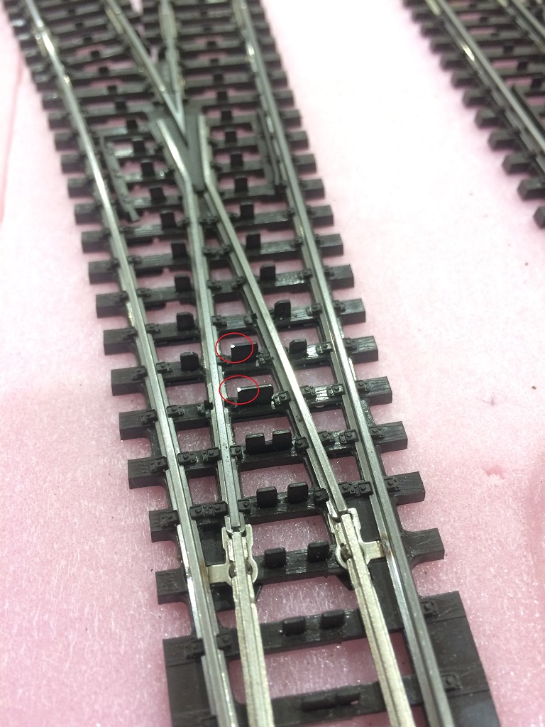

Hi everyone,
Thanks all for the replies and assistance. As previously discovered, my loks ran fine on the other wide radius turnout I had so my investigations have been focused on the turnout that fails.
I took notice that the short circuits appear to happen on the middle pukos, so I took out my ruler to measure.
I have discovered the faulty turnout has a distance of 3.5mm from puko to rail, while the others are 4mm.
While this is very small, it is clearly enough to cause an issue.
First, I tried some large pliers to pull the puko further away from the rail. I couldn't really move it but even the minuscule amount fixed the issue with the BR50.
The BR44's still had problems though, which is because their tender axles have a wide flange.
My method of rectifying this issue - trim the side off by a tiny amount using my dremel.
I can report this change has now fixed the problem!
For reference I have highlighted the pukos that were trimmed. Before laying each turnout I will have to measure this distance and modify if required to avoid this issue.
