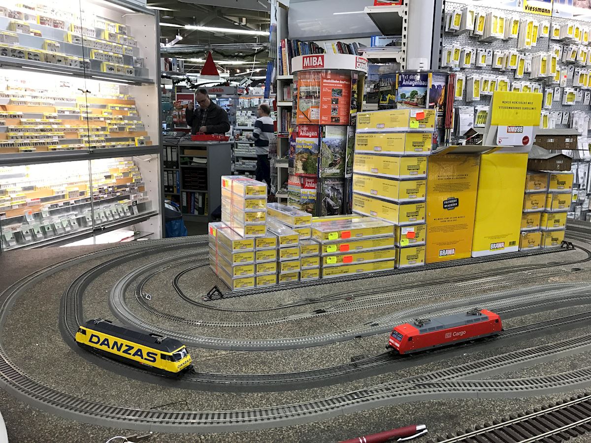

I just spent an amazing week in Dusseldorf, Germany and the guys at Menzels Lokschuppen & Töff-Töff helped me to change the Roco Danzas decoder address in literally less than a minute. I bought a BR146 DB Cargo (with LokPilot V4.0 decoder) off them and here is a picture of both trains running together on the same address. Together with ebay.de purchases I bought back a significant amount of rolling stock to go with the two trains.
In fact I just bought 45 C track pieces including 24671/24672 minutes ago to expand my big oval set up compromised of 85 C tracks and I am holding my breath for being able to run it all on a single 36VA transformer :)unnamed.jpg
thanks 1 user liked this useful post by dietcoke777
