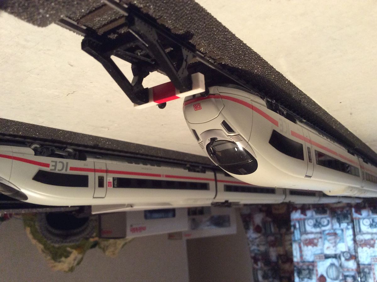

Hallo
I got Fleischmann ice 3 br 407
Runs perfect
Vidar
