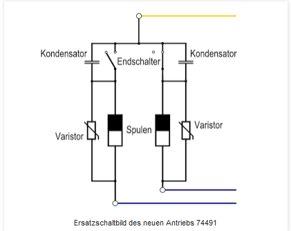

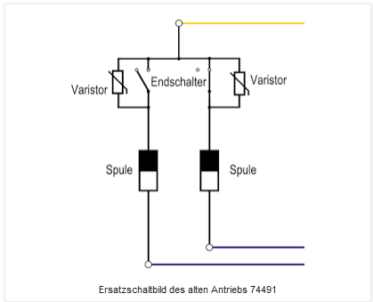

Ok, I did some more research (I really should work through some research BEFORE posting, my bad). and found a Modelbahn blog entry related to the C-Track switches and the update.
http://mobatechnikblog.b...-weichenantrieb-von.html
So the nature of the switches hadn't changed but the usage of other electrical components and the design had - the result of which is, according to the blog article, that there would no longer be enough voltage to produce any amount of arcing at all on the switch contacts. So this should then prevent any accumulation of oxides formed by arcing (that might be burned off by substantial AC switching arcing, but not burned off by lessor digital switching arcing).
So the change doesn't make the track switch fail-safe, it just makes it less arcing and thus less oxidation build up.

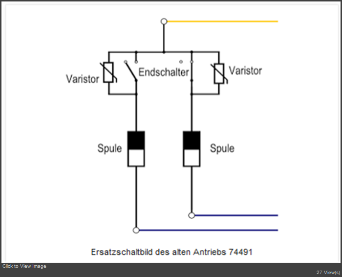

From the blog, the two circuit diagrams:
Old C-Track 74491 circuit (pre 2015?)
When you short circuit the switch, you short circuit the varistor, so the ability to power the coil is always there - power on the input powers the coil.
New C-Track 74491 circuit (modified early 2015?)
Here, shorting the switch takes the capacitor out of the loop and leaves you with the varistor parallel to the coil(inductor) (unlike the old circuit where you'd have the full control voltage applied to the coil only); so I'm guessing something about the supplied voltage on the switch inputs (the voltage of which is highly dependant on what/how that switch input signal is provided ) results in a switch that stalls out in some un-switchable state.
