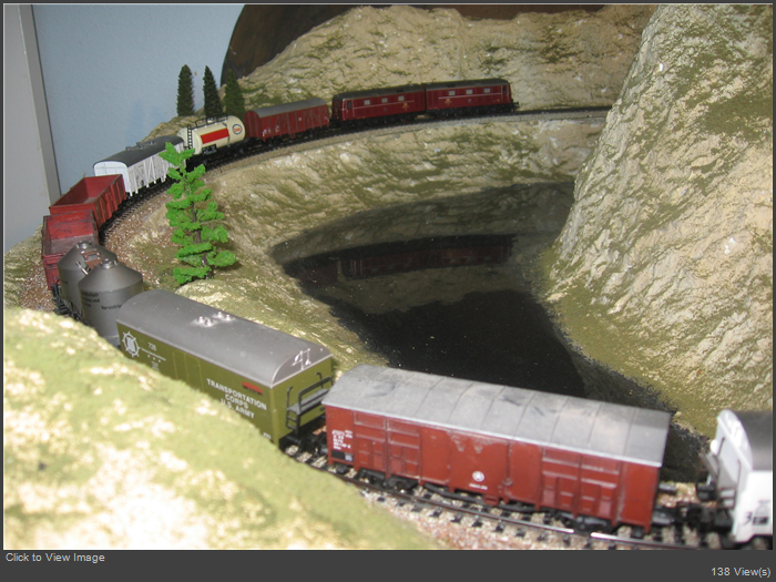

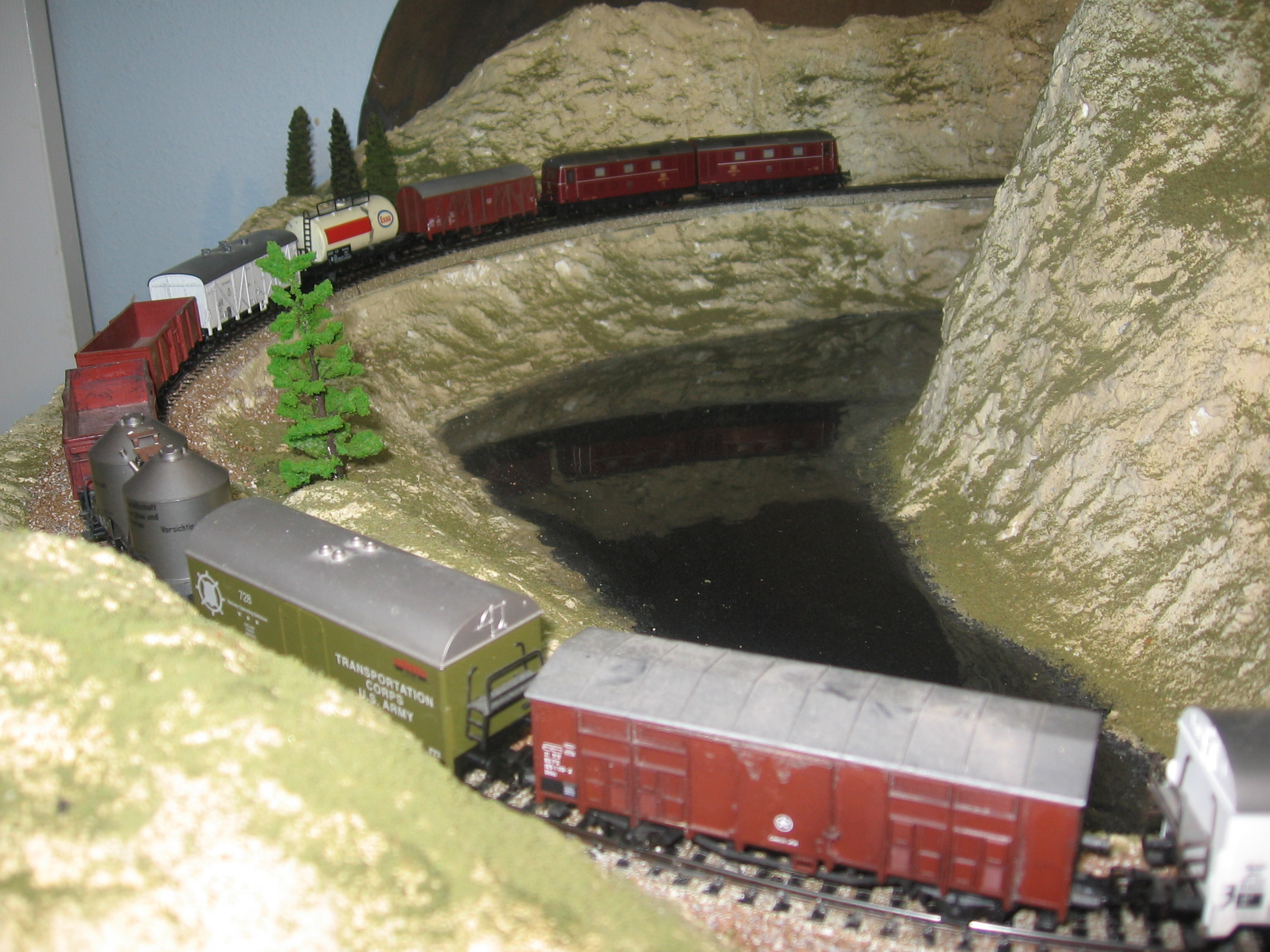

My 37284 only needed cleaning by a Marklin dealer. The attached photograph shows the engine pulling a twelve car freight train smoothly up my long 3.5% Bergdorf grade at a realistic slow speed. BigGrin
