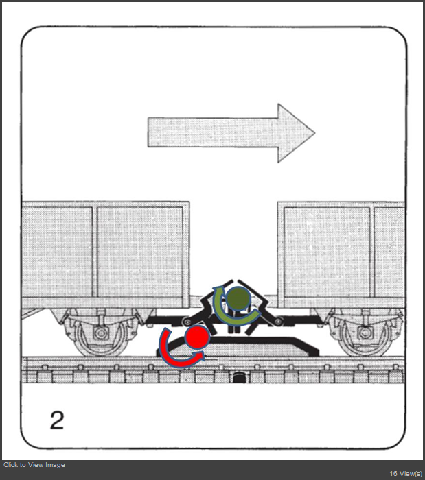

I purchased the Marklin decoupler 24997 to use on my straight track and while using MS2. I have used the manual lever to decouple the locos. I had hard time decoupling the locos and cars which have conducting couplers. While I noticed, it takes a quick tap on the lever to have the coaches decoupled. And I wasnt able to repeat this frequently with success....So, I decided to use the toothpicks. And I damaged a couple of connectors as I was probably using it where I wasnt getting enough lever to lift the locking loops....
Looking at the picture attached, I have been using the toothpick where the red dot is...How would you decouple the cars?

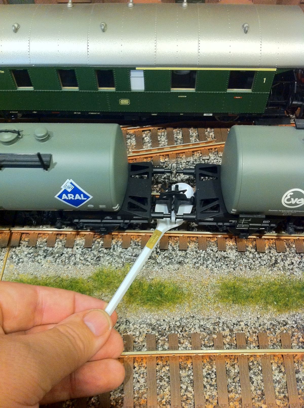

I am left confused now...How do you use an Ice cream stick to uncouple? May be a picture with the Ice cream stick in use would be very helpful...
Neither Maerklin nor ice cream stick, but the same principle applies.
Now is the spoon turned upside down....You will probably be looking around for a baseball bat to beat me up, right???Flapper
No,I got it.Thank you for the picture.

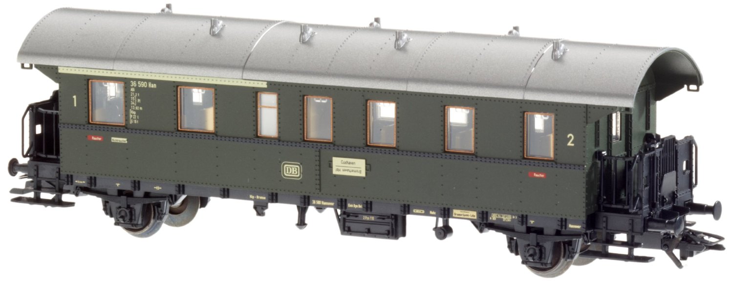

Current conducting coupler.jpgClosed coupler.jpgAll,
I am back again...
I am still trying to get my head wrapped around the types of couplers and their compatibility. Attached are the images of the two couplers I was trying to connect. One of them is on the loco 36082 (the current conducting) and the other one on the passenger car 4313 (is this relex or closed coupler?? or NEM??). I was having hard time to uncouple them.
The uncoupler works perfectly when used between Current conducting couplers or closed couplers. But not with a mix of the couplers for which I have attached the images of.

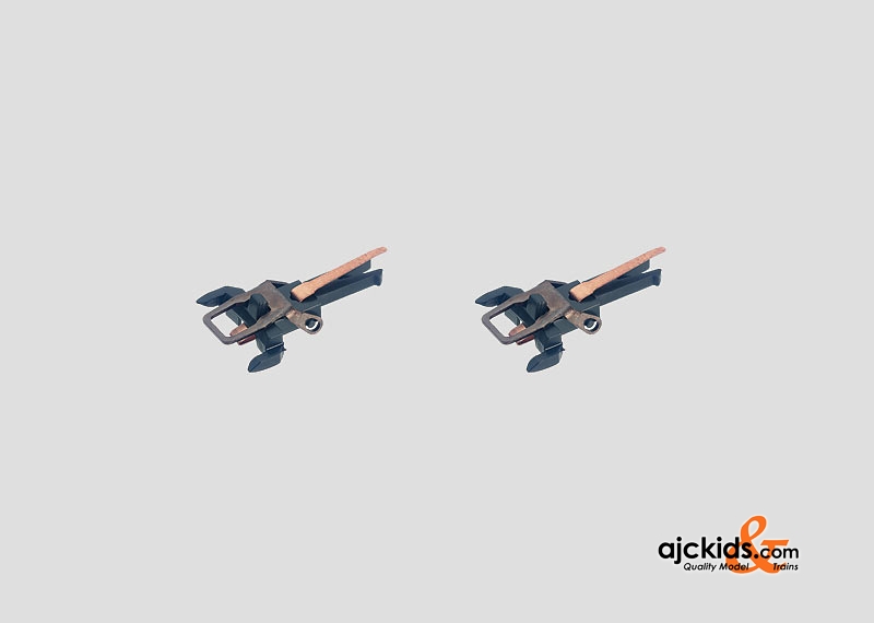

The 36082 is equipped with the 72020/72021 type current conducting coupler. The passenger car photo shows a pair of 7203 close couplers, which are not current conducting. To use this car with current conducting couplers, you will have to install the metal guide which conducts electricity from the coupler to the inside of the car and replace the 7203 with either a 72020 or 72021 coupler like the one on the locomotive.
When using current conducting couplers, especially the 72020/21 or other which can be coupled to regular Maerklin type couplers, you have to use caution because the current conducting coupler carries live current from the slider or decoder and some older coaches have metal couplers which are in contact with the metal chassis of the coach and the wheels which would cause a short.
The 72020/72021 couplers function similarly to the 7203. I have found that they can be slightly harder to couple or to disengage than the non-conducting versions. So far, I have used them in a few trains taking power from a slider on one coach. I have not used them to transmit power from the locomotive to trailing coaches.
Most often, when I want to uncouple these coaches, it is to put them back in their boxes. I usually do this by taking one coach in either hand and gently twisting them in opposing directions, which releases the couplers.
If you want to uncouple them but keep them on the track, I would recommend the uncoupling tool that comes with the 7203 coupling box or the Roco 40397 couplers (box).
