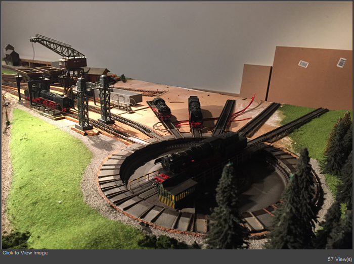

I need some help around the design/prototype practice for the locomotive serving facility on my Marklin HO layout, and specifically whether in Europe during the steam era turntables were ever/typically used on their own without roundhouses or engine sheds.
My Marklin HO layout features a mainline running through a four-track station with a locomotive serving facility (Bw) with a 7286 turntable. I've installed the turntable and the two entry/exit tracks connecting it to the main (four track) station which have coal and water and sanding facilities which the locomotives can use before being turned on the turntable. That's all fine. However I'm having trouble with the design of the spoke tracks that will come off the turntable where locomotives can be parked. Space (as always) is limited. I can fit a three-stall (or possibly a six-stall roundhouse) in but it will only just fit. Alternatively, I can place 9-12 spoke tracks without a roundhouse or engine shed (using the 7.5 degree spacing) quite easily.
Call me unusual but I actually prefer the look of the turntable with spoke tracks *without* the roundhouse. Roundhouses take up a lot of room and a roundhouse squeezed into this space might overpower the layout as a whole (the idea of the layout is of a medium sized village - think Vollmer's "Neuffen" station where a double tracked mainline meets a branchline - in an otherwise rural/forested setting). Without the roundhouse there will be more spoke tracks to store more locomotives. I also prefer dispensing with the roundhouse because (a) you can actually see the locomotives you have parked, and (b) you can keep the track clean and deal with derailments more easily.
But what is more prototypical? In New Zealand (where I live) in the steam era turntables at stations without locomotive shed facilities were quite common (especially at the end of branch lines), but that is possibly because the locomotives might not have stayed at the station overnight (and we tended not to use tank locomotives for branch line work). However my research on the internet indicates that the German state railways had a requirement that 75% of locomotives needed to be stored in sheds during the steam era and I've looked at lots of photos of German locomotive serving facilities and the photos of turntables almost always include accompanying roundhouses.
What sort of activity (e.g. locomotives per day) would have justified a turntable and/or roundhouse in the steam era? I definitely want to include the turntable but wonder if I should water down the size of the coaling and other facilities so it fits with the theme of a medium sized village where a double tracked mainline meets a branchline.
Richard

Thanks everyone for the replies - that's really useful - it seems a "naked" turntable is quite realistic, as is a turntable serving a smaller two-stall straight engine shed. Those prototype photos are really useful.
I've tried to attach some photos here of my layout showing the Bw - any thoughts on might be realistic in terms of locomotive sheds and the coaling and other facilities would be appreciated. For example, I love the massive Faller coaling tower you see in the photos, but I am beginning to wonder if a smaller coaling stage with a crane and bucket (e.g. Faller 120147) might fit the overall layout better.
I've found that the turntable, just by itself, adds a lot of operating potential to a small station - trains come in from the double track mainline, the locomotive uncouples and either goes to the turntable to be turned and start a "return" journey or is replaced by another locomotive. Heaps of fun to be had!
Richard

Very nice layout pix. I allow myself to post them inside the thread for ease of viewing.

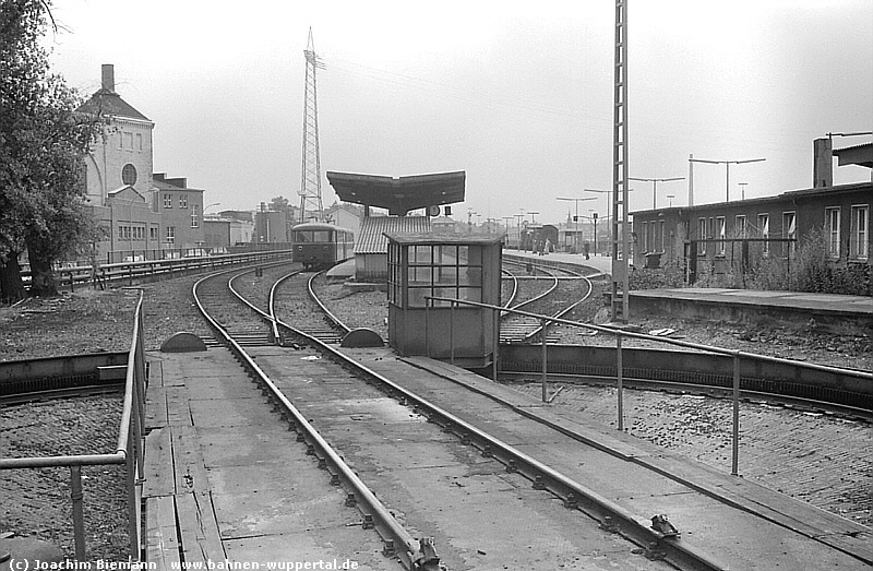

And this one at Bhf Remscheid-Lennep (Wuppertal):
Fotos (2) Joachim Biemann
Jimmy
