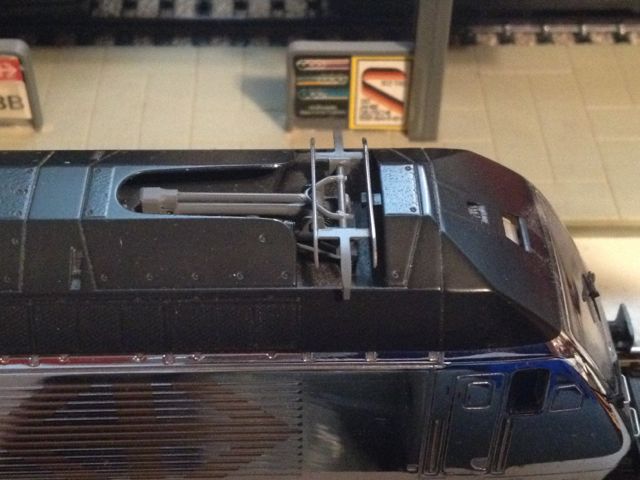

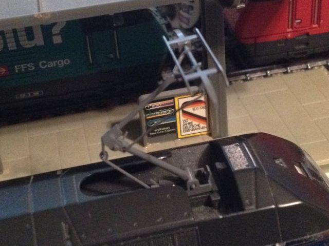

I received my E140787 pantographs and they cannot easily be installed on a Maerklin Re 460 (sorry 37462), but they can be installed on a Hag Re 460 with ease. At this moment, I am trying to decide which one of my Hag Re 460s will receive the first set. The wiper blade is not 100% identical to the one used on the Re 460, but for use with model catenary, this is probably better than a modified or smaller blade would offer.
What is very nice to see is that the base of the pantograph is identical to that of the Sommerfeldt pantos used on the Hag and Maerklin Re 460s. The arms are a little longer than the SA200 type used by Maerklin and Hag, which is why it does not fit without small modification in the cutout of the Maerklin model's roof. I am also pleased to see that the shape of the Y of the upper arm is prototypical, not like the more cup shaped version offered by Roco.
The other option was to use the E140788 which has a different wiper blade. I might test these on another locomotive to see whether it improves electrical connectivity: http://web-hgh-moba.de/i...7790_tgv34_panto_700.jpg
I wonder whether Roco pantograph blades can be installed on the Maerklin pantographs?
