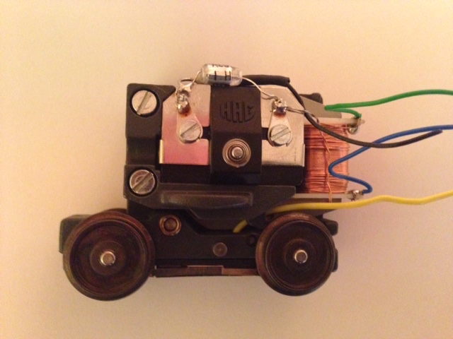

Well the chassis is stripped down and I have ended up with this,
I am hoping that I just have to strip it down, add the new permanent magnet then put it all back together but does anything else need to be done? cheers Rob
#6 Posted : 30 January 2016 20:43:34(UTC)
Ok, so far , so good.
You'll need to remove that capacitor between the brushes: it is troublesome and will ruin your decoder because it will act as a short circuit with the PWM higher frequencies used in modern decoder.
Also be extremely careful with teh following:
1° when you remove the side /brush plate , make sure you don't loose the very small and thin washer on the motor axles
2° do not oil the ball bearings, they are sealed and will last more than a lifetime. But do lubricate the gears , since you'll have direct access to them.
3° with most HAG permanent magnets, the magnetic material is fairly britle. It's easy to get a few bits inside the motor, and they will rub against the motor's frame, worse even block the rotor or create shorts on teh commutator.
4° before connecting and programming the decoder, test the converted motor with a plain DC source. It should run smooth as silk , little mechanical or electrical noise. And perfectly round even at very low RPM.
After these tests, wire the decoder and start programming with the "auto -tune" feature of teh ESU decoders, then eventually slowly fine tune , following the excellent instructions in the ESU manual.
Good luck, and tell us about the results.

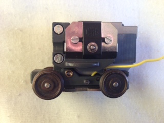

The new magnet has arrived and I now have this ready and waiting for when the body and chassis come back from Hag,
I have given it a small test on 12V DC and it runs really smooth in both directions. This took a total of four days to arrive from Switzerland, my body and chassis took twelve days to go the other way for modifying, having paid for what was described as being their most secure service Royal Mail managed to send it to Tel Aviv in Israel, luckily someone there learnt to read at school (unlike at Heathrow seemingly) and redirected it to Switzerland. I have been told that Hag usually turn the work around in two to four weeks so I have another wait on my hands.
BTW this is not a conversion to sound, it will have upgraded lights and an up to date decoder as per the video when finished, cheers Rob

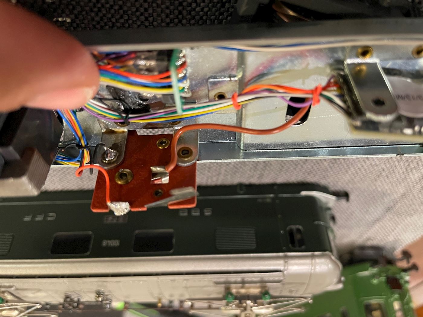

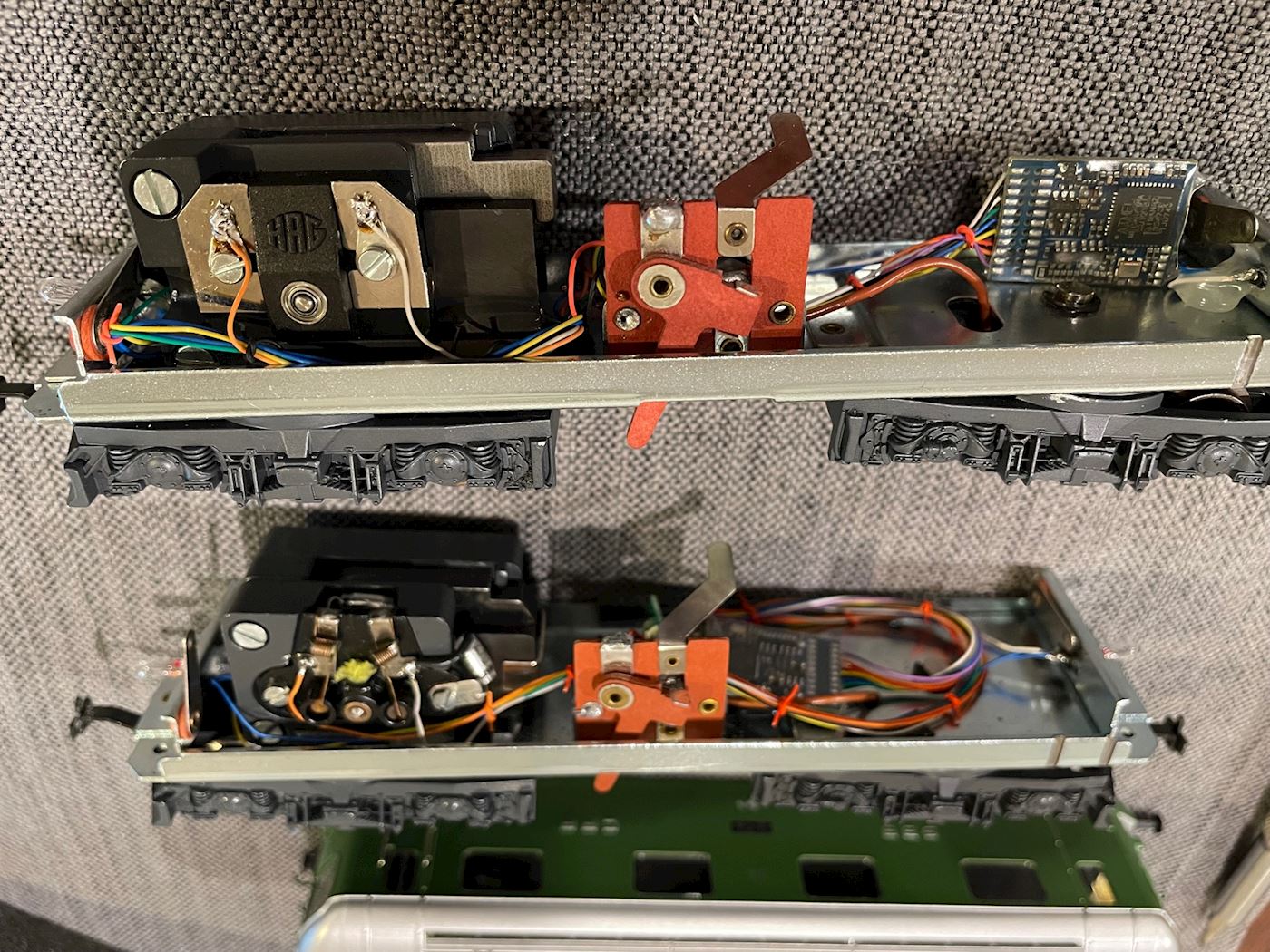

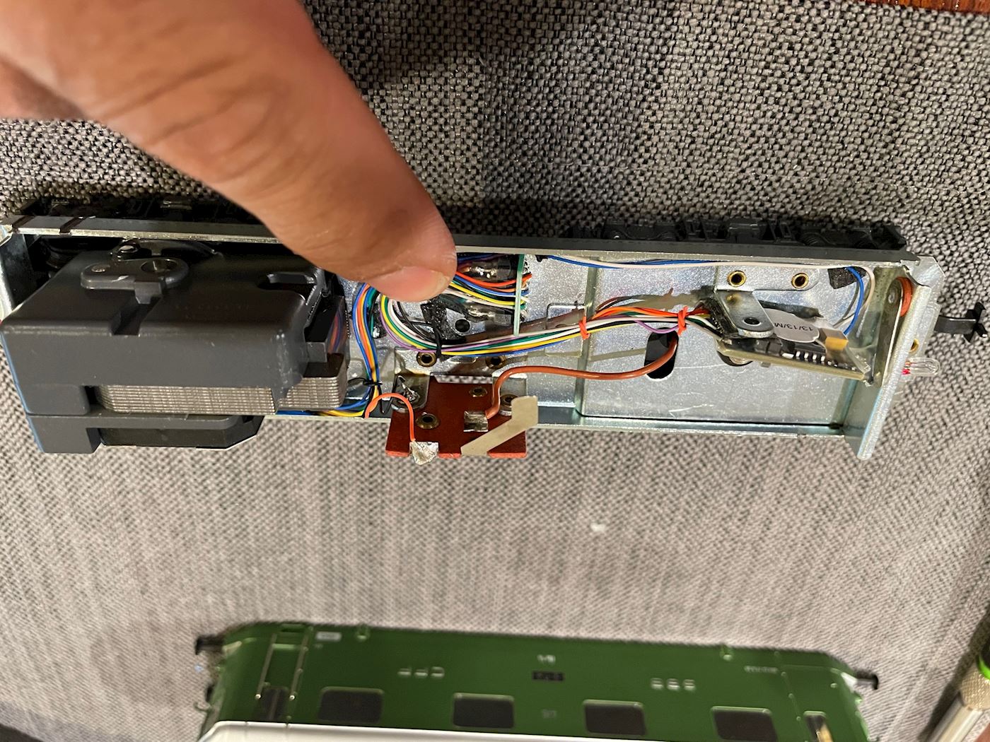

Hi everyone,
Haven't seen Jacques here in a while, but an interesting learning on this capacitor. I just did a conversion (sans capacitor) and it seems to be working fine, however I am having some sort of a feedback issue in Digital, causing erradic behavior. Might any of you be able to help diagnose? Some notes:
What is working:
- Pure DC applied to the motor via test leads works flawlessly
- Seemingly so does the decoder. I programmed it, the headlights work directionally, and all else seems fine
- I previously did another RE 4/4I with the old generation motor. Process identical, except that one works fine and this one doesn't. This new one uses the "new generation" ball bearing motor, and the other used the old style
What isn't working:
- Audible feedback noise
- Some sparking under the powered bogie when running.
Ideas? It seems to be in the chassis grounding somewhere. Perhaps I need to attach the black grounding wire to a different point? Or does the motor need a pair of chokes? Motor block need a second grounding point? I've attached a few images. Including one showing both conversions- the loco on bottom is the one working fine...
Edited by user 22 November 2022 18:04:50(UTC)  | Reason: Not specified

I am a complete digital layman, but have you removed the washer underneath the screw on the brushes side? See the English version in this document:
https://www.hag.swiss/wp...Grundanleitung_Re420.pdf
#24 Posted : 22 November 2022 18:03:10(UTC)
Posts: 3,042
Talk about an important detail- that fixed it! I'd never have noticed- especially since I didn't disassemble the motor...
Thank you SO MUCH Stefan!
