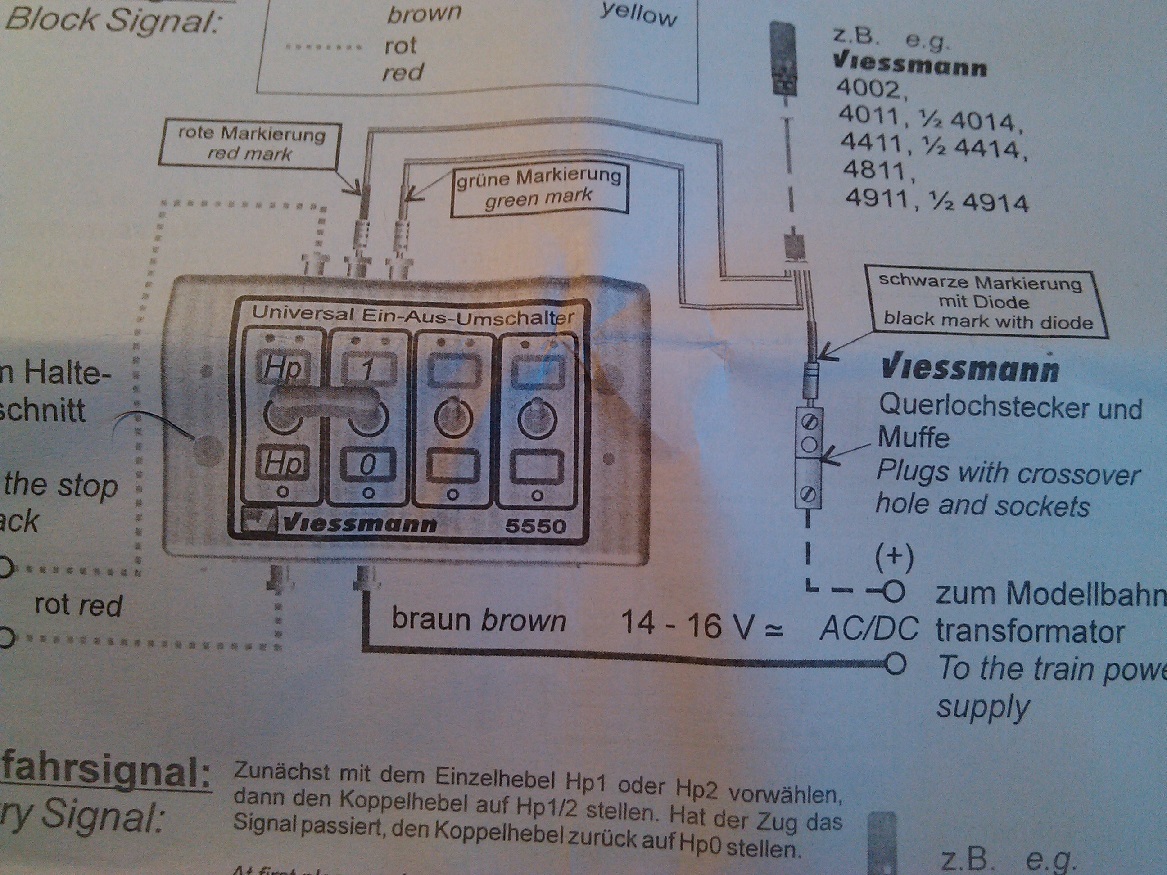

I apologize straight off if I am asking some really dumb questions here. I recently bought some Marklin 89391 block signals and a Viessmann 4811 block signal (I believe that they are effectively the same product). Looking at the documentation that came with the signals, the Marklin signals need a 16V power source and the Viessmann needs 14-16V. The accessory output on my 67013 controller is marked as 11V; so am I correct in thinking that I am going to need an alternative power source to power these signals? If so, can anybody recommend a solution (I only have four signals)?
Secondly, I was going to control the signals manually via a Viessman 5550 universal switch. This comes with a series of plugs that I guess you use to attach the relevant wires to the switch. Are you just meant to stick the wire through the plug and then ram it into the relevant hole on the switch? It doesn't seem to give a very secure connection. Also how much bare wire should protrude from the tip of the plug?
Finally, when I was playing around with one of the 89391 signals, a resistor fell off one of the wires. When I examined the wire, it looked like the insulation had never been stripped i.e. it looks like the wire was just stuck onto the resistor with a bit of insulation tape and there may never have been a proper, soldered, metal to metal contact. Has anyone else come across this problem? Obviously, on this example I am going to have to remove the tape still stuck to the resistor and resolder the connection, but I am not going to be too impressed if I have to do this for all of them. Cursing
Thanks,
Carim
1. Voltage - Check your signal manual again. Mine says maximum of 10V for the signal LEDs but separately 16V are needed if using the 7244 relays. My layout is digital, so I'm driving my signals from an ESU SwitchPilot using 10V external power supply.
2. Quality - I own about a dozen of the Marklin signals, and mine are just fine. Hoping you just happened to get one with a substandard solder joint.
Cheers!
Hi Gene,
Yes the Marklin document says exactly what you said.
On Viessmann 4811 it says:
Technical Data
Poweer supply: 14 - 16 V
current (for each LED): approx 10 mA
and in the diagrams shows the signal wired to the 5550 switch and the wire with the diode going to a 5200 (transformer).
So I tried to recreate the above circuit using the 67013 controller/transformer; but nothing worked. Then I noticed that the accessory output was 11 V - hence my original question. So I am wondering why nothing works - is it because I am using too low a voltage or is there something wrong with the wiring (I know for one signal that is the case)?
The documentation with the Viessman 5550 suggests that you do need a 16 V supply:
So if I want working signals, do I need to buy a transformer with a 16 V output? Crying

#7 Posted : 13 December 2015 12:37:20(UTC)
Posts: 15,488
Did you check the polarity of the voltage?
The signals need DC - and if the DC from your 67013 has the wrong polarity then you won't see lights.
Hi Tom,
If you look at the second Viessman document in post #6, it suggests either AC or DC. Prior to seeing this, I thought that LEDs needed DC and that I would have to use a bridge rectifier in the circuit if my power source was AC (as it is). I thought that there may be something in the 5550 switch acting in conjuntion with the diode on the signal that effectively converts the polarity - or am I totally wrong?
If I added a bridge rectifier to the 11V AC power source, I would get a DC current but it still looks like insufficient voltage to operate the 5550 switch. (Also what voltage on the bridge rectifier - is higher better than lower?). Confused Confused
I am fast coming round to the conclusion that I need another transformer or I have to be happy with non-working signals on my layout! Crying Crying Cursing

#11 Posted : 13 December 2015 16:59:34(UTC)
Posts: 15,488
Are you sure your power source is AC and not DC?
The 67013 comes with a DC wallwart and I don't think it will generate an AC output when you feed DC into it.

#15 Posted : 14 December 2015 03:32:31(UTC)
gwolski
Joined: 17/12/2001(UTC)
Posts: 171
Location: Central Virginia
The Viessmann 5550 is simply a switch and does not have a minimum voltage (although it does have a 24V max rating). As long as your wiring from the LED signal and power pack are correct, it will simply apply power to either the red or the green LED (if we're still discussing the two color block signal).
The red and green LED wires from the signal should connect to the 5550 along with the grey (?) accessory output from the transformer. The other wire (with the heat shrink diode) is attached to the yellow accessory output.
Now that I say that, did you re-attach the diode backwards? They are direction sensitive.
Cheers!

#18 Posted : 14 December 2015 07:32:37(UTC)
Posts: 15,488
Turn the diode around and you risk the LEDs in the signals.
Try the diode at both poles. With märklin you might find that yellow is minus, not plus.
Cheers!
Gene,
Thanks for this - this is the sort of level that I need - all makes sense now. I haven't touched the wire with the diode on it, just one "green" resistor fell off. I had got confused as I thought that with LEDs, the resistors had to be placed ahead of the LED on the +ve wire. But according to DCC Concepts' literature, whilst that is best practice, it doesn't really matter. I will repair the broken signal and make a test set-up and let everybody know how I get on.
Carim
