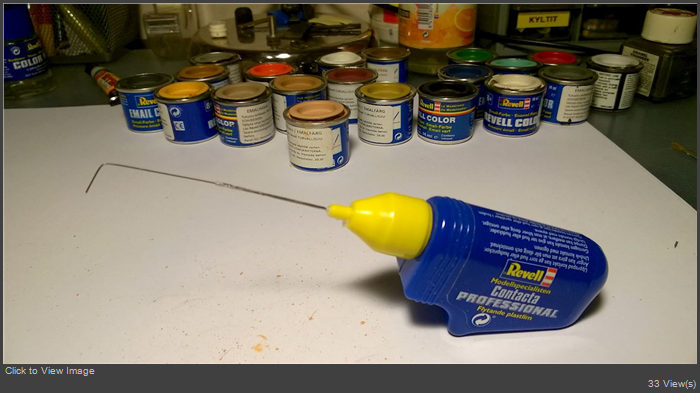

I use Faller glue too. I keep needle clear using the wire of a common bag tie with the paper stripped off. Works great.20170225_085004.jpg
thanks 3 users liked this useful post by bfriedland@cox.net

I use the small cleaning wire that comes with a smoke generator to clean the needle. Usually does the trick.
Jakob.[/quote
Me too
