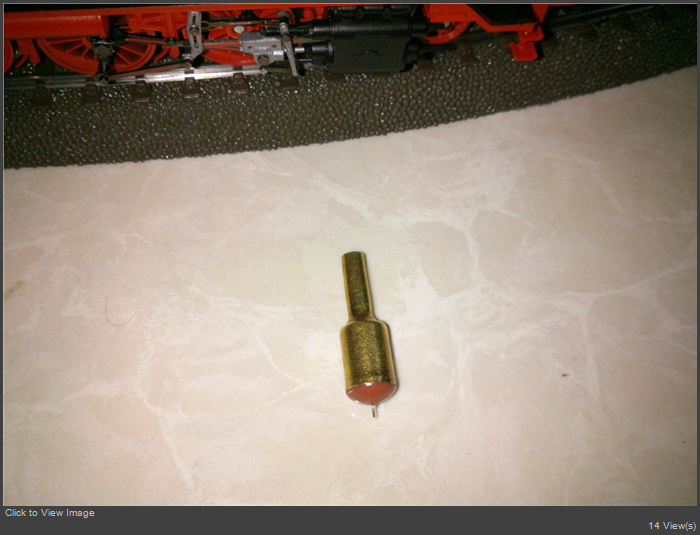

My 36243 arrived!!!
The Marklin dealer in Stuttgart has sent ESU 51990 smoke fluid and 72270. Are these compatible?
Also can I use ESU 51990 with other AC backmann engines? Please help as I'm in an urgency to watch my first mfx smoke:)

Hi Madhu,
All smoke fluids work on the same principal, the smoke unit heats up the fluid thereby emitting smoke.
provided that the fluid is from a reputable manufacturer it would not be a problem, and ESU is a reputable manufacturer.
Enjoy your smoking 36243 :).

Hello all,
This is my third attempt in fixing the smoke unit on my 36243 and I failed terribly. The following pics say what I'm trying to do. Also the smoke contact gets bent inwards and I doubt if the smoke unit wire is able to close circuit at all.
First I tried installing 72270 with its contact wire bent. Then I straightened the contact wire as the onboard metal contact piece was getting bent too much.
As soon as I fix the smoke unit, I could hear
a short circuit sound and the MS2 switches to "STOP" mode
. What am I doing wrong? Please help
Madhu

Madhu,
If the smoke unit contact is getting bend over that indicates to me that you're not pushing the unit far enough into the smoke stack to get it fully seated. Look on the inside of the boiler in the front where the smoke unit is installed. When the smoke unit is fully seated, the flared area of the smoke unit should be touching the inside of the boiler casting. If the smoke unit is NOT seated all the way into the boiler it will be down too low and then when you install the boiler onto the frame, the smoke unit contact gets bent over and touches the side of the smoke unit which is electrically grounded. The smoke unit contact being electrically hot causes the short circuit. You will also need to carefully bend the smoke unit contact back to it's original position.
If you send a clear pic (inside and outside) of the smoke unit installed in the boiler before you reattach the boiler, I can see if you have it installed properly. It may take a little force to get it fully seated. If that is the case, make sure you have the boiler on a solid surface with some padding to protect the paint around the lip of the smokestack for being damaged.
NOTE: I do have one engine, like this one shown below, where there is a plastic piece inside that prevents the smoke unit from being inserted too far. In this case, you would push the unit until it's seated against this plastic insert.
I hope this is helpful to you and you need additional help, ask here before you proceed. After waiting to get you nice new engine, you don't want to be in a rush and cause it some damage. Good luck.
Chuck

Anders, shop owner of Hobbycenter.se in Gothenberg, answered this way. I found this answer quite convincing. What do you think?
"Smoke liquid acts as a conductor inside the smoke unit. The moment it evaporates completely, the circuit breaks and it will not damage the smoke unit"
The smoke liquid acts as a cooling agent. When the smoke fluid evaporates, the write inside the smoke generator will become hotter.
The wire lasts until it burns through. You can park the loco on a siding where you can turn power off when the loco is not in use.
