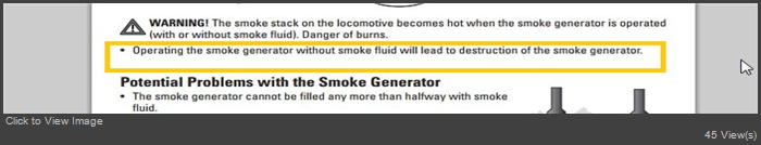

Sorry for so many questions. When I downloaded the 36243_betrieb.pdf, I noticed that "Smoke Generator" is always on. So does this mean that when the Loco runs out of Smoke Fluid, I should remove the 72270 unit out from the loco?
Madhu
#19 Posted : 08 September 2015 15:39:47(UTC)
Posts: 8,462
Originally Posted by: madhu.gn.71 Go to Quoted Post
Thank you Joe.
Madhu
No, it just means it will stop smoking. It should be quite happy in this state.

@KiwiAlan, the reason why I asked that question was in one of the instruction manuals http://medienpdb.maerklin.de/product_files/1/pdf/36243_betrieb.pdf I saw the following text.
2015-09-08 19_17_40-https___medienpdb.maerklin.de_product_files_1_pdf_29240_betrieb.jpg

...must admit, first time I've seen this.....my buddy has the 36243, and I'm sure he can control the smoke unit from his MS2-switch on/off. Don't quite know what they mean by "always on"; ...I will check with my buddy....

In the operations manual for the 36243 it says F1 controls the smoke generator contact
No. It says "Smoke generator* Always on". Same information in the product database.
Right! I did an ultrafast pass in the manual and as it is in the place of F1 I misinterpreted.
Thanks for correction. I edit my previous append.
I don't think it is good to have the smoke device always on because it is energy consumption when it is empty. Obviously not considering here the "realistic look" of control it.
Miguel
Mostly Märklin H0.

Has the Jury come to the following conclusions? :)
" 72220 Smoke Unit will be always in 'On' position on 36243"
"it's better to take the unit out when the loco runs out of smoke fluid"
OR
As Tom (H0) mentioned, I can make it digitally controllable so that I need not worry even if the smoke unit sits inside the loco
#29 Posted : 09 September 2015 08:39:02(UTC)
Posts: 15,870
It sounds like the best idea (unless you want to attack the model with a soldering iron) is to either always fill the smoke generator or not install it at all.
I'm not a great fan of smoke units anyway, so I won't be bothering to install one.

The "always on" is what you get from the factory.
Considering you use the loco as it comes from the factory, it is not practical to remove the smoke generator when you are not using it, so keep it there (IMHO). In analog locos it is usual to have the smoke generator retrofitted and many times not have it filled with the smoke liquid. It is just not ideal.
About the change, if you do it you will loose warranty.
Miguel
Mostly Märklin H0.
Offline madhu.gn.71
#31 Posted : 09 September 2015 15:59:29(UTC)
madhu.gn.71
India
Joined: 16/04/2014(UTC)
Posts: 775
Location: Bangalore, India
Hello Miguel,
36243 does not come with factory fitted Smoke unit as per the PDF manual available from Maerklin site. I've pasted the following instruction snippet from PDF for our info:
• A smoke generator can be retrofitted to the locomotive -also for analog operation.
• Only the smoke, running, and light changeover functions are available in analog operation.
Now I'll come back to my question. Can I do the following?
Madhu

I forgot to update the response from Maerklin regarding 36243's Smoke unit. It is official that we SHOULD NOT run the loco without smoke fluid and it can not be digitally controlled. Here is my question and Maerklin's response highlighted in yellow.
Dear Mr. Madhu,
in this model you cannot switch the smoke generator off. The smoke generator cannot be used without any fluid inside. If you run this model on a digital system, you should prefer to use the smoke generator Seuthe no. 24.
Sincerely yours,
Your Maerklin Customer Service
