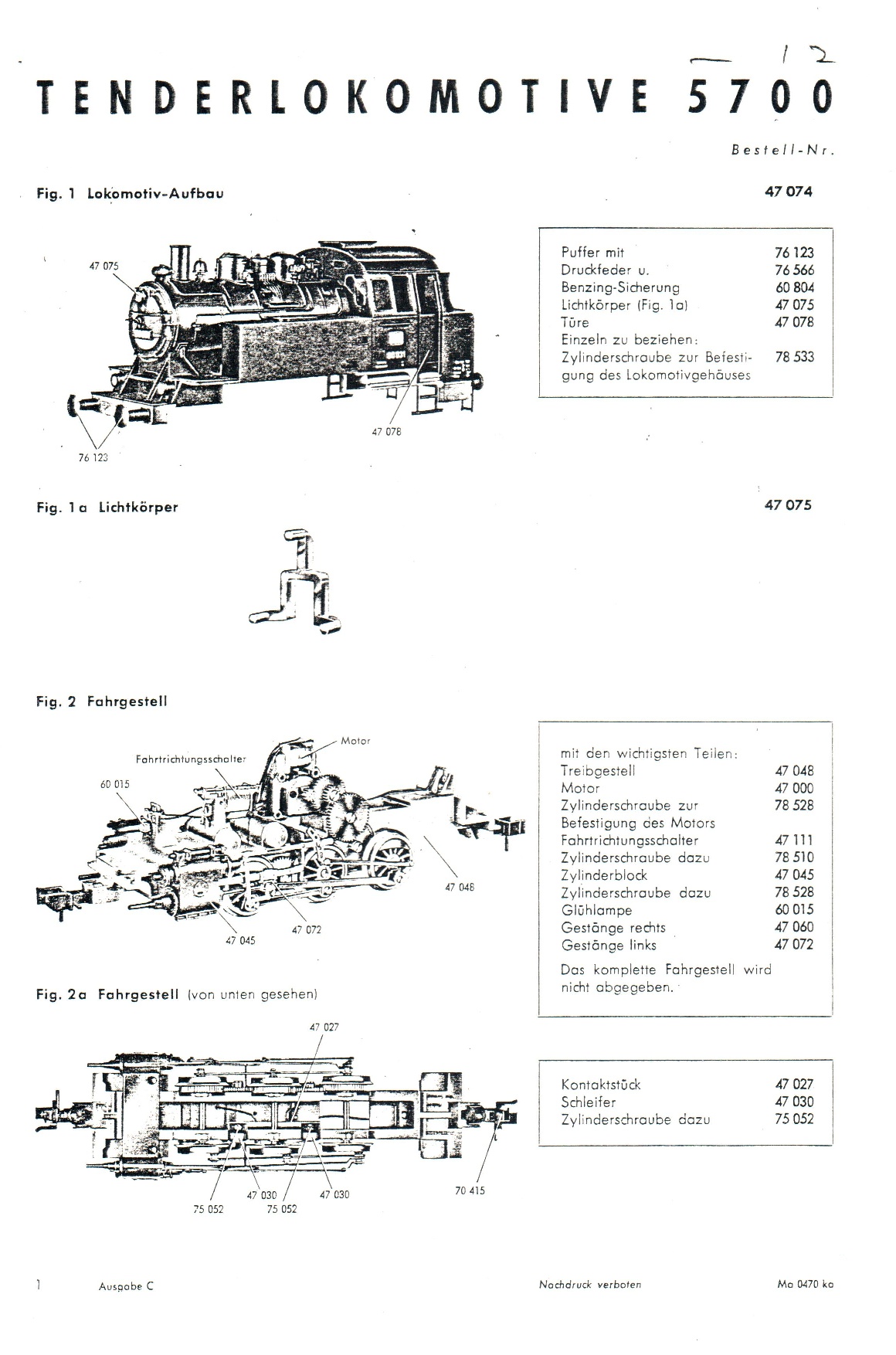

Hi.... trying to get my old analog Marklin 1 gauge engine ( model 5700) ready for the holidays and so I tested it recently. It ran rough and lubricating helped a little. However, I believe the brushes may need to be replaced. Unfortunately I lost or misplaced the user manual some time ago and am not sure which type of Marlin brushes would work. I've noticed that they look very similar to the brushes I have on some of my older Marklin HO engines that I own. Any info would be much appreciated.

Hi Ken,
Here are the original service sheets for this model from April 1970.
The original part number for the brushes was 60041, this was for a pair of Graphite Brushes. Later they moved to a single graphite brush and a single copper brush, the copper brush aids cleaning of the armature commutator.
As far as I know, 60041 became 600410, and is now sold as 600350 which appears to be a current item in the online shop....
E600350 - Accessory Set Bürstenpaar
€ 6.00 recommended retail price E
This older thread might help also
https://www.marklin-user...are-parts-and-battery-rc
Hope this helps you find them
Steve
