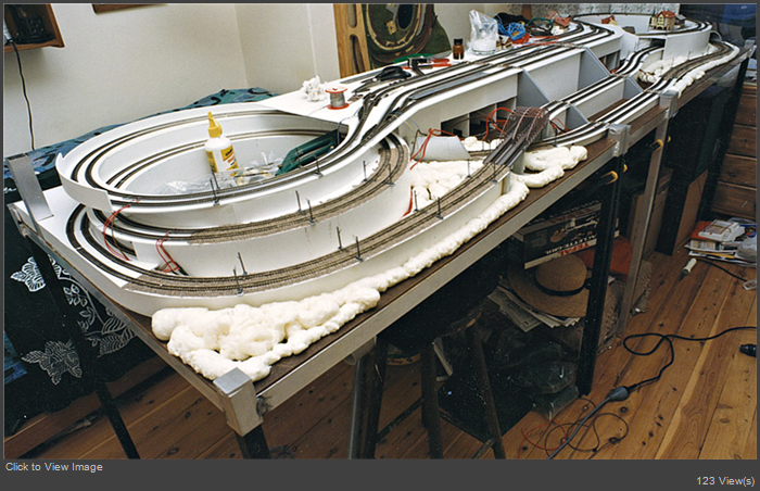

I have limited space for my helix which gives me something of a problem. The helix will have to be round, M 5100 and 5200 radii and I do not think I have enough space to add straights to lessen the incline. I use powered catenary so the height to be achieved in one 360 degree turn is 104.5 mm according to Marklin if I use the catenary posts. However, if I can fix wire to the underside of the helix and dispense with posts this could be reduced to approx 83mm.
Still steep though!

Make the spiral partly visible to effectively increase radius thus reduce gradient and make the layout more interesting.

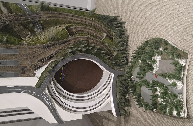

Threaded rods, nuts, washers and something like 6 to 7 mm plywood is a good start.
Threaded rods make for an easy adjustment.
For derailing protection, use a medium-soft material like yoga mats or foam camping mats (not the self-inflating type). Glue or tack it down to the sides of the plywood. This will allow you to push the fencing down when handling derailments and not hurt your hands and fingers. It doesn't have to be very high, 3-4 cm above the side of the ply will do.
Keep at least 2-2,5 cm free space outside the track bed on both sides.
The example with a partly visible helix is an excellent use of space and scenery.
I also second the tip with a double-track helix. If you only have the limited space for R1, then make it oval since a circular R1 is just 226 cm in diameter, or consider making a long straight ramp at the back or front of your layout.
