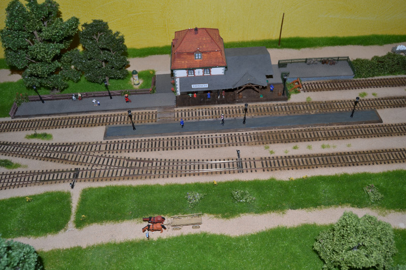

Why to use K tracks as 2 rail?
You have other brands which are similar as prototype.
Tillig elite...Peco...Weinert etc.
Pictures from my layout...It´s Tillig elite code 83.
