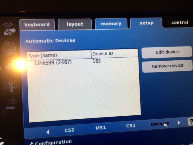

First you have to be sure that your S88 device is ready for programming. For this, and future also, I recommend you to make testing layout into your CS2
Here is an example of that:
Connect your S88 device so that you can see when contact is occupiend and when it is free. Those dots in the testing layout will change from the white to yellw when contact goes occupied and when it goes free it will change from yellow to white.
BE CAREFULL when you connect S88 device, you should cut off power of CS2 before connect. If you have older version of CS2 it is possible to burn you S88 channel if power is on during the connection.
After you have identified contacts on your layout it is easy to make trigger for memory sequences:

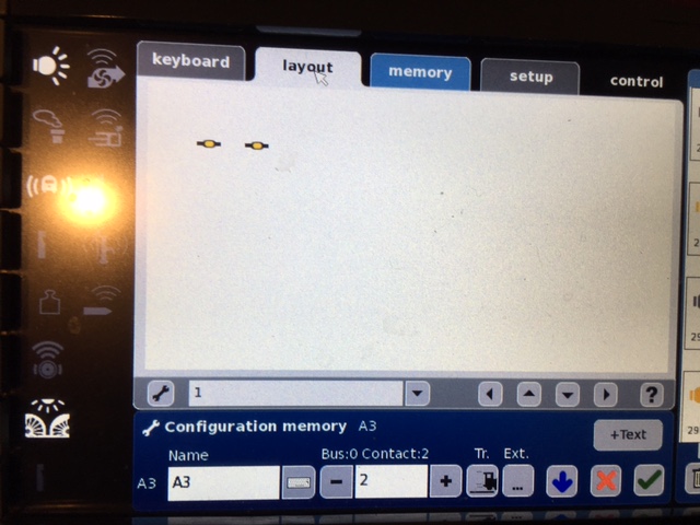

First put your memory to programming state:
It looks like this:
Here I have decided to trigger memory sequence B5 By first S88 deviced first contact.
If you have several S88 devices they must be in chain and just click + sign to get the contact number which you want to use.
In this example It triggers when contact goes occupied. In the Tr.-window coming train means that triggering happens when contact turns occupied. Leaving train means that contact turns to free.
In the picture on the right you can see how to make conditions for triggering.
From the post 481938 you can see more of how to make conditions.
I hope this will help you
Happy training
Jukka

Success ! I did exactly as you suggested and I managed to trigger Memory Sequence A2 from A1. I would never have thought to set up a testing layout in Layout. From that I can now select trigger points for other Memory sequences.
One interesting thing I noted that there does not appear a little field showing the S88 symbol on the right hand side of the Memory page. I have to remember that there is a trigger point.
Anyway I am very grateful to you that you have shown me the way to do it. I have found new interest in the CS2 and the programming of it so I will hope to post some more observations.

I'm using the L88 native ports (right now using only ports 1 and 2 for my 2 test contact tracks).
I only have one l88 (no s88s - though I can hook one up, I bought a s88 but after reading the manual, it seems that is not required with a l88 for basic contacts).
The l88 is powered - and I haven't turned it off - it shows up correctly in cs2 (screenshot attached).
Changing the hand/loco sign on the right does not make any difference
The ground is connected to the outer live rail of the contact track.
Im attaching screenshots - my guess is I do not have my contact tracks setup correctly. im using 24995 contract track set.
I also do not understand the status icons when you launch a memory route (sometimes its yellow, sometimes its blue, sometimes it just executes the commands and no change in status). IMG_2843.JPG
thanks 2 users liked this useful post by aquaanox

I have solved my l88 problem and everything is working now. I had the ground connected to the contact track, and it needs to be outside of that block.
I also tested the power on delay on the l88 and did not see any delays once the basic config was working. this is a very informative post overall, thanks a bunch.
