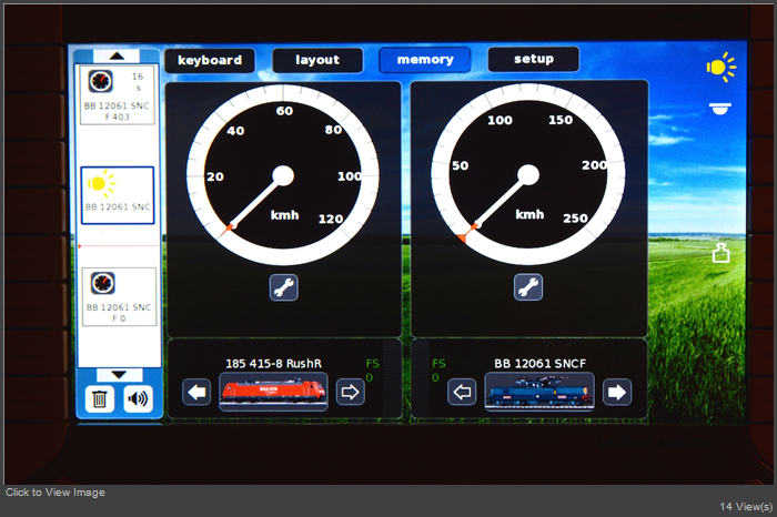

Hello, it seems to be so difficult to get picture in, that I just write.
My proposal is:
Would it be nice to have real good instructions how to program CS2 routes...or memory.
What can be done and how to do.
My problem is that I cannot read good enough German language and automatic translators are not so good fron Deutch to English, not to mention to Finnish.
And I have not found proper instructions and help for programming CS2 memory and all it´s possibilities.
That picture abowe is only example what we could do to visualize when we write detailed instruction.
So does anybody know if there are somewhere writed instructions and explanations of what to put into those several fields whe programming memory.
As far as I understand you Märklin people know very much about CS2 and it´s possibilities. Only it is quite hard to find right information. Therefore I suggest that you put your experiences around memory programming and perhaps I could collet them together and put finally the whole collection of best practises of memory programming into this thread.
Please give me info about where to find that kind of information.

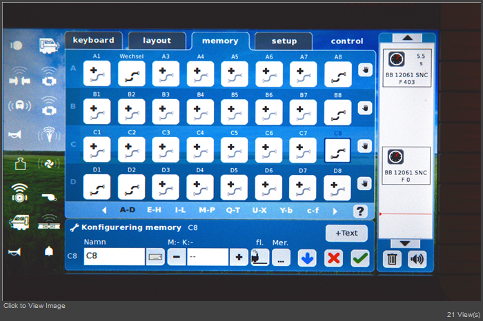

#8 Posted : 11 February 2015 19:11:02(UTC)
amartinezv
Joined: 25/08/2004(UTC)
Posts: 332
Location: Madrid,
I am not a expert with the memory but I know some things:
In the pics that you have upload there's route A1, A2.....A8, B1....B8 etc, thas has a meaning
routes A are set and release by the first s88 module
routes B are set and realease by the 2nd s88 and so on
In each single s88 the contacts 1, 2, 3 etc sets the routes 1, 2, etc, and the contacts 9, 10, 11 etc releases the routes 1, 2, 3 accordingly..
The time between a route is set and release the route is locked, thats mean that none othe route can change any element of the route set.

Just to avoid confusion , you should qualify you comments as referring to the Marklin 6043 Memory
The CS2-Memory function may be a modern variant with similar intent, but it does operate quite differently in most areas
Edited by user 14 February 2015 10:42:33(UTC)  | Reason: Not specified

Ref: "A route is a particular path to be traversed by a locomotive (or a train) and for which all of the corresponding turnouts and signals are to be set at
the press of a single button"
This may have been the initial function and may still be the function most often deployed, but it is only one aspect of many - some usages may not use signals or turnouts at all.
Maybe a qualification of some kind
May I suggest that the buttons in the memory be called sequences - of which a route may be a subset usage.
Ref: "A small yellow dot is shown on the button for a route as long as the memory is setting the items for that route.
The dot may be other colours - blue/grey appears to indicate a wait/delay
Ref: When the dot changes to green, the route has been set
Comment needed : if a route(sequence) contains an audio file or the same item in different states (e.g. horn on/horn off) the green dot will not display
Ref: In pure manual operation a route can only be activated with the button for that route in the Central Station.
Clarification: a route(sequence) associated(triggered) by a loco function on the CS2 will also work in manual mode only
Ref: The UserPostedImage button is used to store the newly generated or altered route.
Clarification!
The UserPostedImage button is used to store AND EXIT the newly generated or altered route.
The UserPostedImagebutton is used to apply/store and return for further editing the newly generated or altered route(sequence).

Folks,
can someone explain why the Cs2 behaves like this?
I create a very simple route; start, run for 5 seconds, stop. The route looks like this:
The upper box shows I have set the sped to F403 (whatever that means...) and the lok runs for 5.5 seconds.
The lower box tells us the lok has stopped (speed = F0)
Now I want to edit the route, switching on the lok lights when it stops. I highlight the upper box, switches to "control" and pushes the "light" button. A third box appears, showing "Lights on"
Now to my question; Why has the running time in the upper box changed from 5.5 to 16 seconds?
All the best to Jukka and everybody else!
//Stefan, Östersund, Sweden

Offline clapcott
#30 Posted : 19 February 2015 09:26:06(UTC)
clapcott
Joined: 12/12/2005(UTC)
Posts: 2,448
In learning mode, any object you add will cause the previous one to be updated with how long you delayed in selecting the object.
In this case by the time you got round to turning the lights on, 16 seconds had elapsed
This can be good to capture what you did, but the chances are that what you physically did (delay-wise) is not what you wanted because you were thinking through the process and having to navigate to different pages. Therefore you are more than likely going to edit the object and tweak the times
So, I guess the simplest way to do this is to:
1. Record the sequence.
2. Note the times for every step.
3. Make the insertions.
4. Edit the steps and enter the original times, noted in step 2.
//Stefan

Stefan,
Rather than taking a photo of the CS2 screen, there is a screenshot function available if you are on the network and browse directly to the CS2s IP address.
Ok, I will try that next time, thanks!
/stefan

A brief description to get the ball rolling ...
The Ext(ra) or "Advanced" dialogue box contains two sections 1) Trigger 2) Condition
Trigger (top half)
With one exception this is exactly the same information about the S88 trigger that is seen on the main Memory sequence setup panel. The information is more spread out and easier to read especially the port numbering abbreviations. (although they are still not in english)
M:- C:- = S88 Module and Contact(port)
B:- M:- C:- = L88 Bus, then Module and Contact(port)
B:0 K:- =L88 non-Matrix - Contact(port)
B:- Z:- S:- =L88 Matrix mode ROW(Zeile) and Column(Spalte)
The exception is the additional Device ID field (Shown above with the a LinkS88 selected) which identifies which control device the S88 in question is connected to. As of Feb2015 the options are limited to the Master CS2 or a Slave(Auxiliary/Secondary) CS2. Next month we expect the addition of the L88 (60883 Link-S88) and with the unavailability of legacy S88s you can expect to see this more often.
The purpose of this "Trigger" section is simply to identify which S88 port will trigger the associated memory sequence.

Condition(s) (Bottom half)
While the Trigger fields may define which S88 port is to be used - the "Condition(s)" are what permit/allow it to work.
By default there is no condition defined which means the trigger will always work.
A condition is the definition of a (totally separate) S88 port plus a state (occupied or unoccupied)
If any entries are added to the list of conditions they must ALL be in the correct state for the trigger to work.
In the example below S88 port 1 is the trigger but it will only cause the sequence activate if both ..
- S88 port 2 is occupied
and
- S88 port 3 is Unoccupied
As a comment/tip...
It is possible to set a S88 port on the layout diagram without an actual S88 physically available.
touching this S88 will toggle the virtual state of the sensor between Occupied and Unocupied
thanks 5 users liked this useful post by clapcott

Re: ... page 3, under picture 2
When activated BR94 start run three seconds in speed of 53 ( at the moment I don’t excatly know what that 53 stands for)
Below is from the help file "hilfe/de/fsitem_speed.html" translated using google ...
In summary the CS2 uses a 0-1000 scale for its internal speed range - this is divided into increments based on the decoders definition of # of steps.
Possibly the easiest way to conceive this is as a percentage divided by 10 - thus 53 = 5.3% of maximum speed
This is rather an over simplification as ...
- the speed curve set into the decoders of modern locomotives is rarely linear
- for a given decoder speed step (say 14 on a 28 step decoder) the scope within the 1000 range could be from approx 482 to 512 )
however it does give a starting reference.
- the magic around a 27 step decoder interpreting a 1-14 command range depends on acceleration v deceleration.
I have my reservation about the calculation shown
I suggest you would be better to learn the speed by driving the loco the way you want and noting the values anyway.
FWIW, on the normal CS2 throttle control page, the FS (Fahstufen) value shown next to the green speed bar max's out a "-1" (1 less) than the specified decoder. i.e. for an mfx 126 step decoder it is 125 and for an old MM 14 step decoder it is 13.
