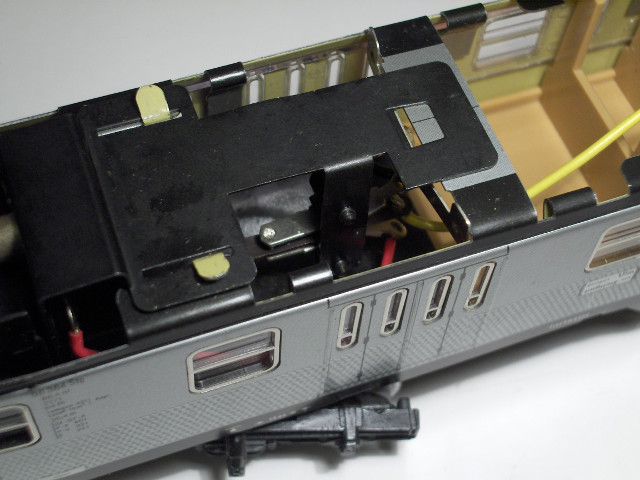

The front wheels of the front bogie are equipped with tyres to avoid sliding.
The front axle of the front bogie is covered with a tube which rubs on it.
The tube moves a lever up when the coach goes forward and down when backward.
thanks 7 users liked this useful post by TrainIride
Offline TrainIride
#3 Posted : 17 January 2015 11:41:27(UTC)
TrainIride
Joined: 23/10/2010(UTC)
Posts: 2,084
Location: FRANCE

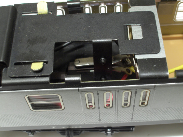

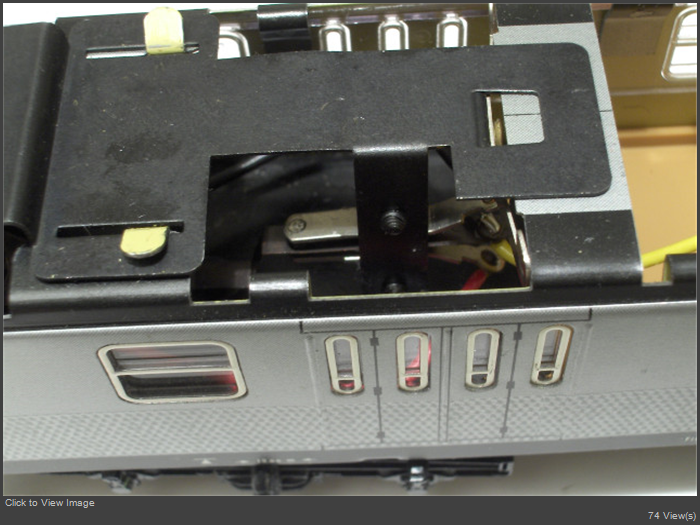

Depending the lever position, a switch is activated in the coach
feeding the red or the whight light with the yellow wire from the pickup shoe
of the rear bogie.
thanks 6 users liked this useful post by TrainIride
Offline TrainIride
#4 Posted : 17 January 2015 11:44:26(UTC)
TrainIride
Posts: 2,084
Location: FRANCE
A closer view of the inside switch.
Again, if someone know how to unmount it properly without damage, please post....
Joël
