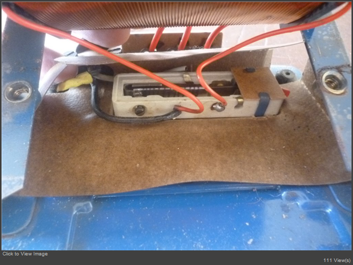

So I opened the transformer (I was already planning to do so) and took it apart completely (which is not even that easy).
And surprise-surprise, inside the transformer the insulation of the 230 Volt cable was decomposed.
The insulation was sticked onto the bottom lid of the transformer, and the metal 230 Volt wiring was open and exposed over a length of 6 cm.
YIKES !
So lesson learned here.
I’m very happy that it was me who was fried, and not one of my boys.
I will replace all main cords of my 4 280A's this week.

I suspect that as the insulation deteriorated it became hygroscopic and absorbed moisture out of the air. Also looking at the way the paint on the base plate is showing rust coming through they have probably been kept in less than dry conditions (in an outside shed or unheated loft space?) that has allowed the moisture level to rise, and then once you plugged them in the 230V did the final eat through the moisture until there was enough contact with the base plate to give you a kick.
As others have noted, even though these are designed to be double insulated, I would fit a three core mains cable with the ground wire properly connected to the base plate.

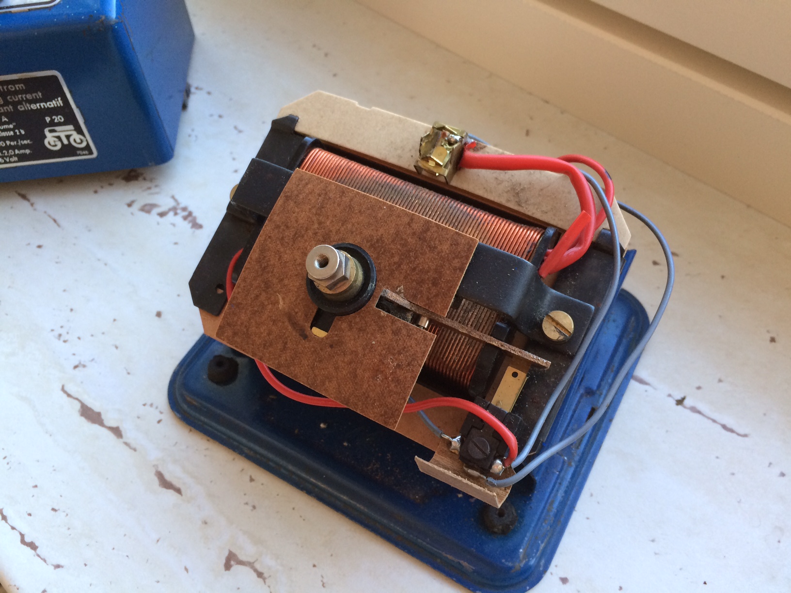

Having just acquired a 280, I shall be taking heed of the sorry tale from Marco. I shall investigate the insides before I plan any use.

i have 4 of the later blue traffos (metal) and 2 of the plastic blue ones. after marco's experience they will all get 3-wire with ground.

You should be able to simply solder the new wire to the old one without having to redo the entire terminal connection. What you need to do first is to install a length of heat shrink tubing over the new wire and after you have soldered the connection, slide the tubing over the weld and then apply heat with a hair dryer or paint stripper so that the heat shrink tubing form fits to the wire and covers it completely.
Marco/Mike that component looks like a thermal overload switch and as such would be generating heat during an overload event. In fact this heating was probably what caused the oxidation and subsequent "freezing" of the screw within the connector in the first place.
Marco you should really not solder a wire to this wire stub as the heat generated by another overload event would probably melt the solder and cause more problems.
You really need to use the original mechanical termination which means replacing that broken screw. The new slot using a Dremell is a good idea but I fear that the brass screw has been well and truly frozen. Perhaps some CRC to attempt to loosen it up first before another attempt with the screw driver?
You will also have to be gentle with it as the attachment method of the connector to the brass/copper? strip behind it would also be fragile after so many obvious heat cycles.
Keep us posted.

Hi Guys,
I am searching for a wire diagram for my Marklin super 280a transformer.
I only have to know the wires connected to the thermal porcelain protector inside the transformer.
I buy this transformer with some loose wires, that why.
Thanks in advance for you're answers.
Hendrik
Zoetermeer

Hi Guys,
Thanks for you're reactions and you're concerns about my dangerous adventure ThumpUp
The connections off the porcelain overload protector where broken of and i can't see witch wire must be connected on it, see pictures.
Maybe somebody can tell me, with some pictures from the inside of a decent transformer, how the wires are connected.
Thanks for you're respons and sorry if i am not writing perfect english.
Greetings Hendrik.

Don't worry about your English - "BANG!, PFFFT" is the same in any language !! LOL LOL
So here are the connections you are looking for.
AC in has two wires, we call them Phase and Neutral. Whenever I rewire a Trafo I always put the Phase through the Thermal Overload Cutout. For those of us with an earth pin it's easy, you cannot reverse the plug. If you have a reversible plug, it is possible to get the polarity incorrect - this will not cause a problem with operation unless you have multiple trafos controlling the same layout - Then you have a serious risk.
But that is another story.
So, you have two wires coming in from the AC line cord.
The Primary winding of the Trafo has two wires also.
The Overload breaker has three connections. Two on one side, (the side of the silver adjusting screw) and one on the other side (with the two black screws).
The single connector is for the incoming Phase wire.
On the other side there are two more copper connectors. If you look closely at the Breaker you will see that one of the copper connectors does not connect to anything in the breaker - it is simply a point to join the incoming Neutral with one side of the Primary winding.
The last copper connector (on your picture, it's the one that still has solder inside it) is where the other Primary Trafo winding connects to.
PLEASE NOTE: Is is VERY important that the brown card remains in place and is correctly fitted. As you can see, the incoming AC wire runs directly beside the 3 16vac low-voltage output pins. You MUST have a physical barrier between the Thermal Cutout and the low-voltage outputs.
Imagine if the live wire comes loose from the thermal cutout and makes contact with the exposed sockets on the rear. That would be extremely dangerous. Not to mention that all your Loco's would instantly reverse, and then explode and this would upset the Preiserlings very much. Makes a mess of the track ballast also. Better to avoid.
These pictures should make it very clear.
DISCLAIMER: WE (I) ARE NOT RECOMMENDING THAT ANYONE ATTEMPT ANY TRAFO REPAIRS UNLESS THEY ARE ABSOLUTELY CERTAIN, CONFIDENT AND COMPETENT IN WHAT THEY ARE DOING.
The best analogy I can give is this....
"No, you are not allowed to drive a car"
"But I'm going to drive a car anyway whether you allow me to or not!"
"Ok, well this is how you put on a seatbelt"
Good luck with it.

Offline Hendrik1959
#41 Posted : 15 December 2016 11:30:11(UTC)
Hendrik1959
Joined: 28/11/2016(UTC)
Posts: 3
Location: Netherlands, Rotterdam
Hello Cookee, Many thanks for you're perfect explanation with all the pictures.
I put everything together as you explained and it it working properly now.
Greetings Hendrik
