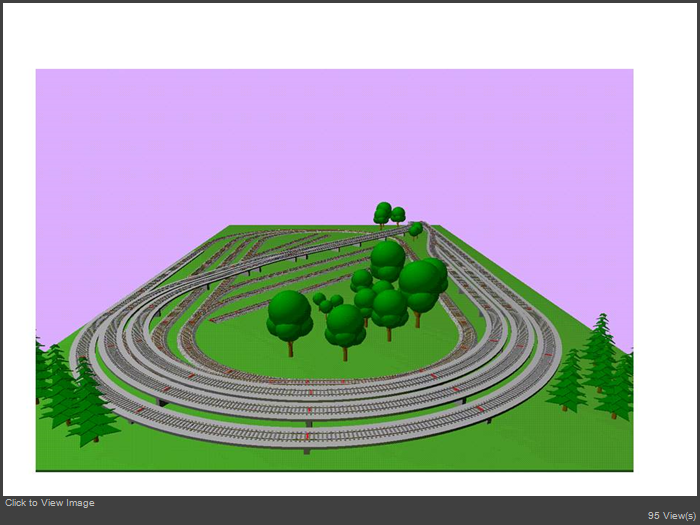

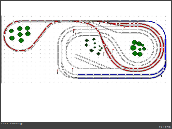

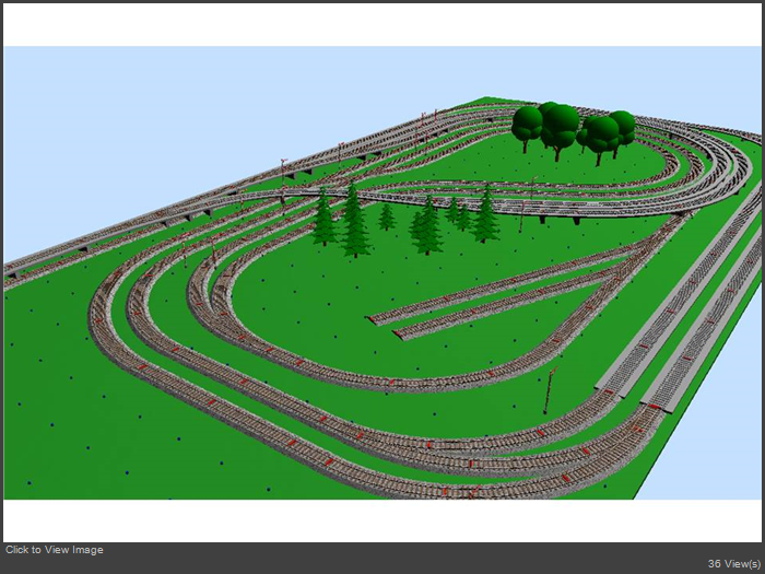

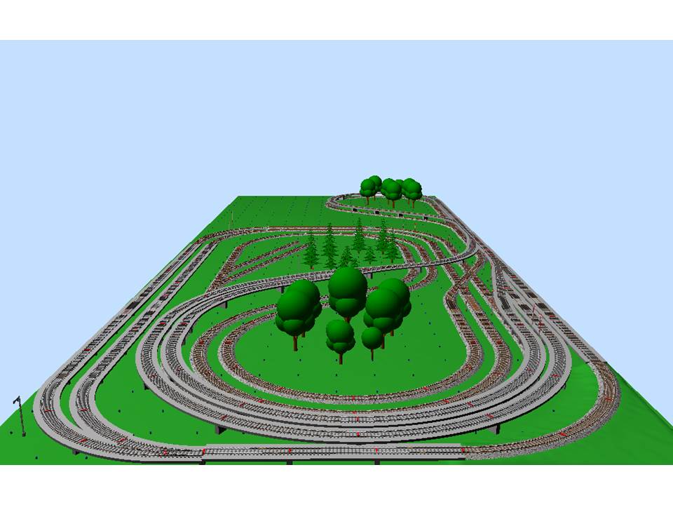

My existing "Matterhorn Layout" has provided me with great pleasure during the last 2 years.ThumpUp ThumpUp
But I am contemplating the construction of a new layout commencing during my holidays in January.
I am in the mood for running some trains with longer consists behind, like the ICE2 and DB103 and DB111 and DB01-097 each with several coaches behind, or Freight with lots of box-cars or coal hoppers, etc. I want trains of 1.5 meters in length to have space to ease around the layout, and stop at signals with braking modules.
There is some space is along the side of the garage wall, where I have a reasonable length, but which needs a removable end-piece. Why ? So that the cars can drive into the garage, access to the lawn-mower, bicycles, wind-surfers, etc, all of which also live in the garage. Of course !
So I am planning to make a detachable module with a reversing loop which I can easily attach to extend the layout when I am running the trains, and remove when the lawn mower and bicycles have their moments. You will see the idea in the pictures below :
Here are some thoughts which I am working on at the moment.
Single ascent / descent line around the right hand side, so trains will need to reverse loop on the top and the bottom, as well as circuits on top level and bottom level. Signals at all locations where stations / platforms can go. Narrow angle points for slim line train switches. Something like this :
Comments welcome.Smile
Many thanks to SCARM (Mixy) for allowing me to dream about layouts in my sleep, and then test them out on the computer before construction !
Regards,BigGrin

Offline Danlake
#2 Posted : 26 December 2014 18:50:16(UTC)
Danlake
Joined: 03/08/2011(UTC)
Posts: 1,572
Hi John,
Looks good and should give you lots of flexibility and fun.
Looking forward to follow the progress.
Brgds Lasse
Offline Janne75
#3 Posted : 26 December 2014 21:56:06(UTC)
Janne75
Joined: 23/03/2012(UTC)
Posts: 2,571
Location: Finland
Hi John,
Many possibilities to run long trains and park them on the sidings. What are the dimensions of this planned layout part and the removable layout part? I would also like to have longer sidings and straight track sections, but I'm really limited to my train rooms small size. If I will ever build a layout again (my current layout is a long project... Wink ) I will make sure there will be longer sidings, straight track sections and reversing loops in both directions.
Have fun with building your new layout. Maybe a good idea to have some kind of wheels under that removable layout section? RollEyes
Janne Smile

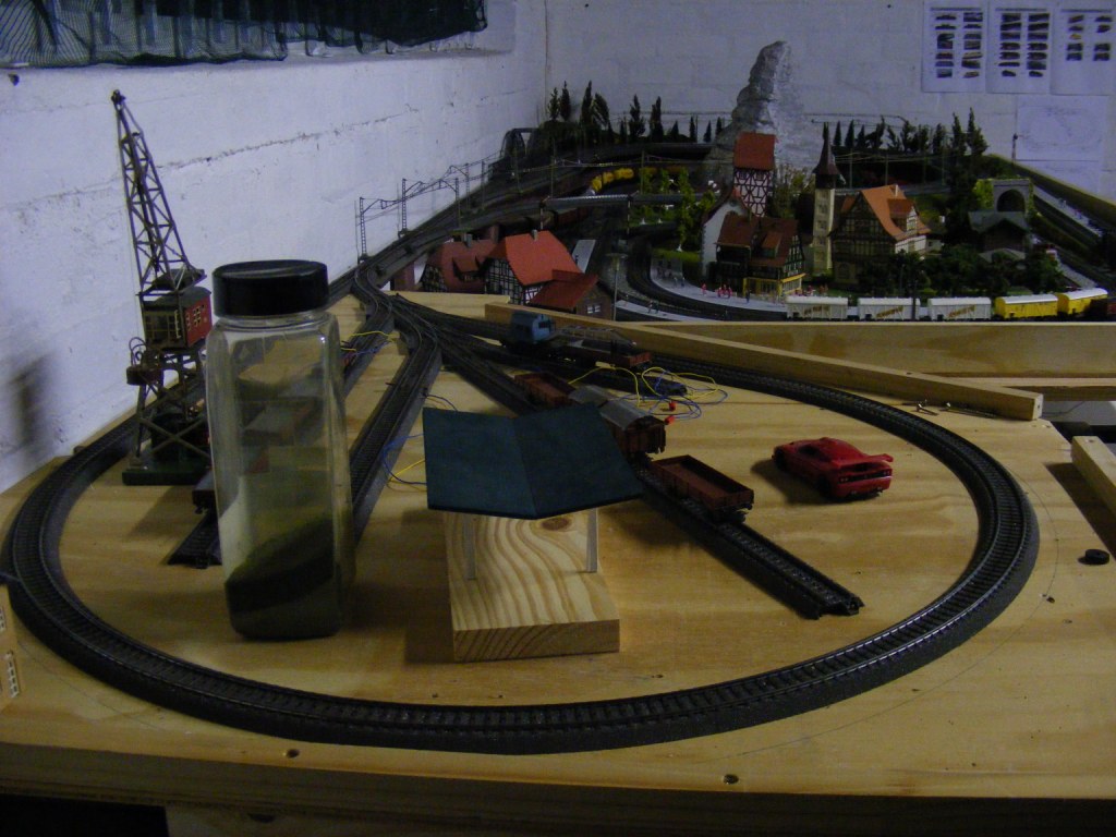

#8 Posted : 30 March 2015 19:34:31(UTC)
Johnvr
Joined: 03/10/2010(UTC)
Posts: 1,307

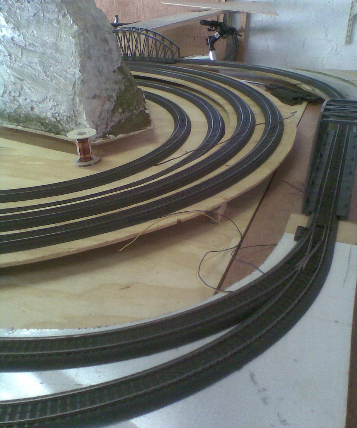

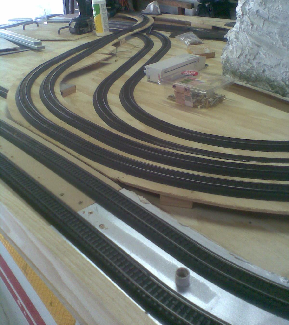

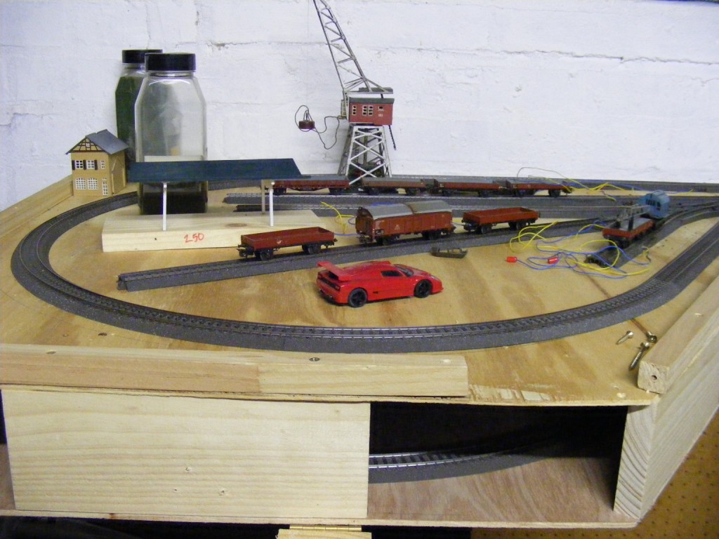

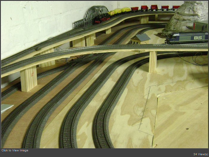

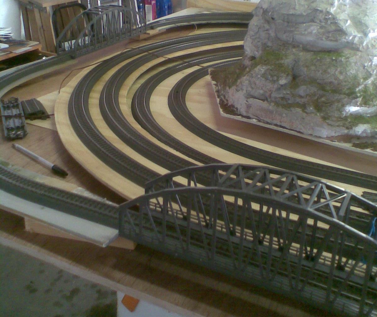

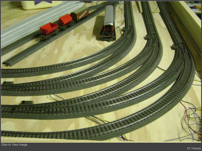

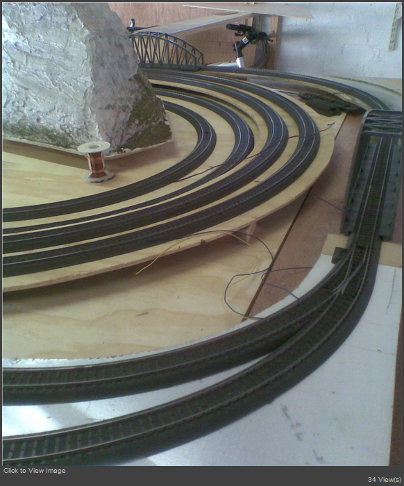

Finally getting going on the new Matterhorn Layout. BigGrin BigGrin
(This will be Matterhorn III, following on from Matterhorn I which was Analog, and Matterhorn II which was Digital).
My good friend Terry came to assist me with the woodwork during the past couple of weekends, and I managed to lay out some track. It's always exciting to see how the track plan develops, and I have been adjusting my SCARM drawings as I think of new things.
There will be lots of signalling systems here .. I haven't yet planned all of the signals, but there will be enough signals for train traffic to stop and go all over the layout, operated by Contact Track sections, and probably my first venture into Occupation Detection.
Regards,BigGrin

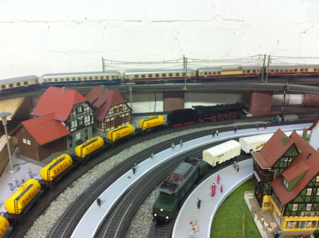

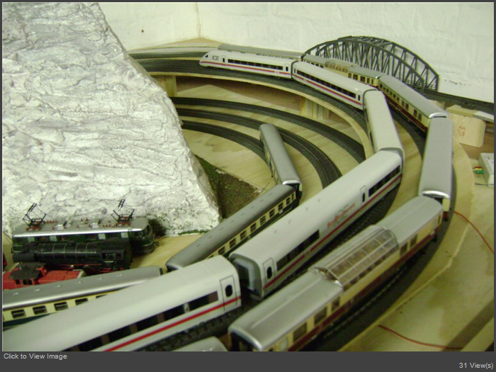

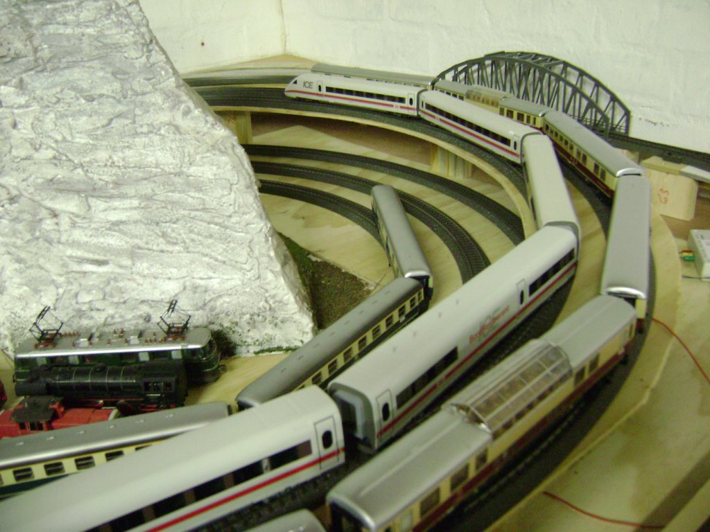

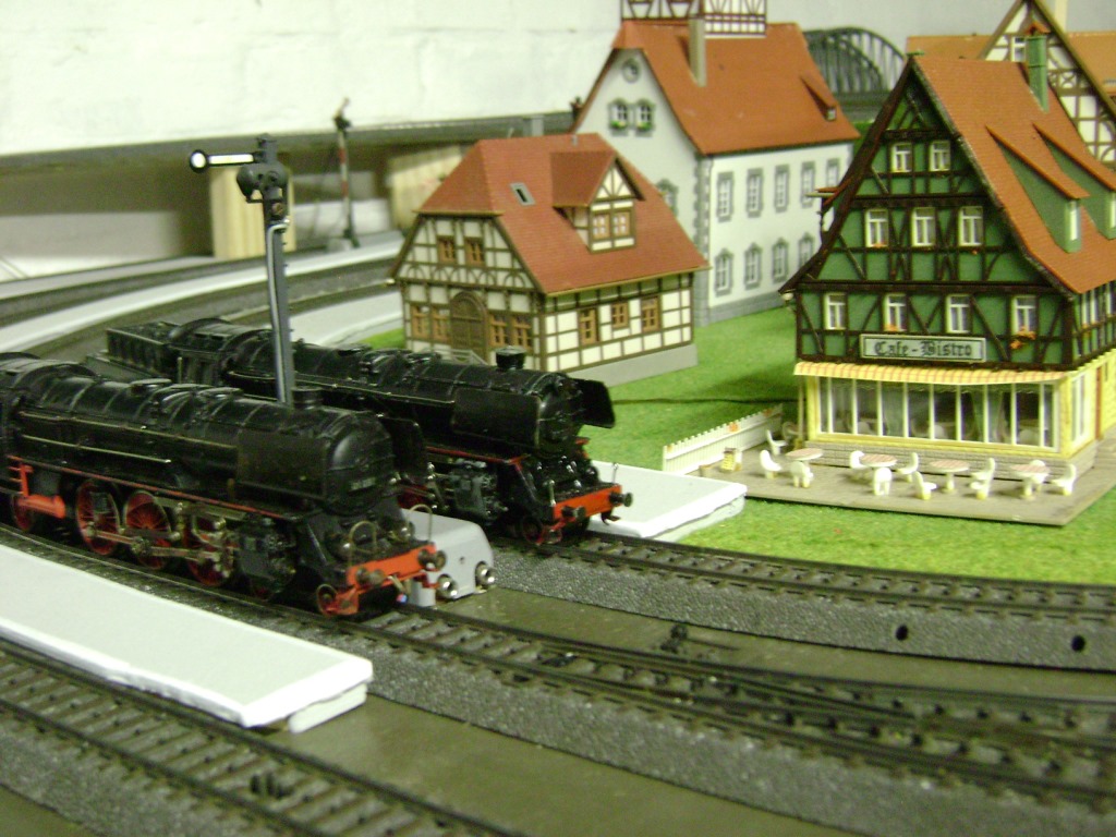

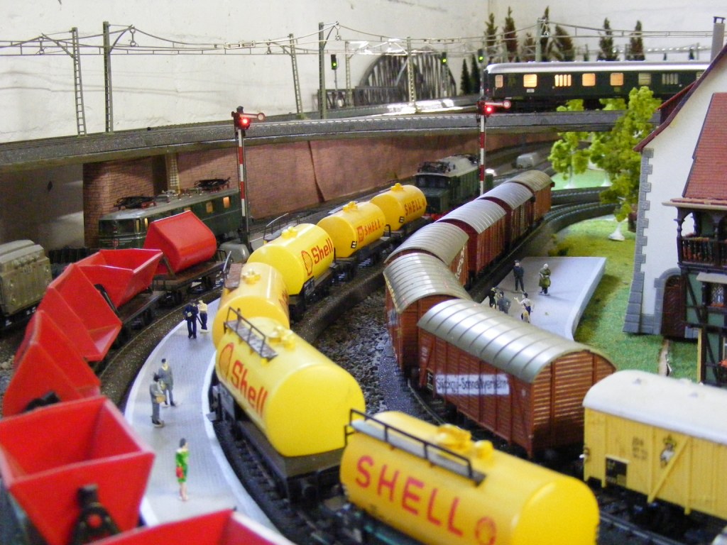

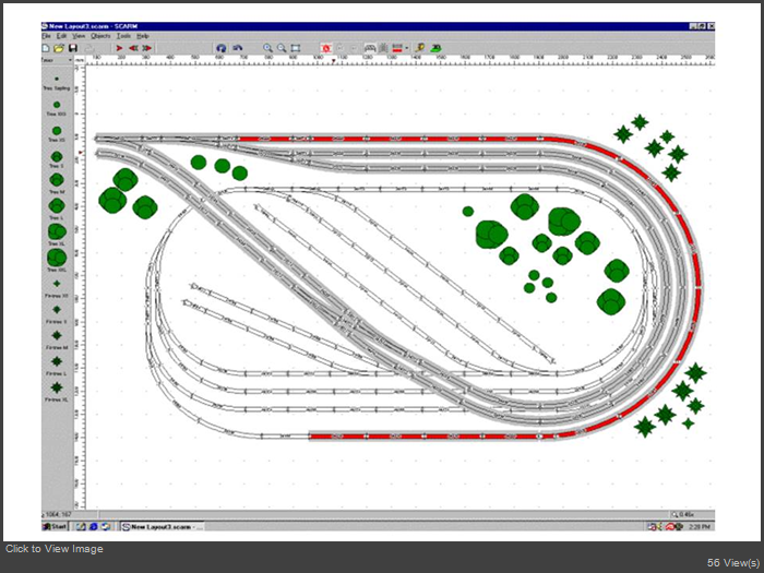

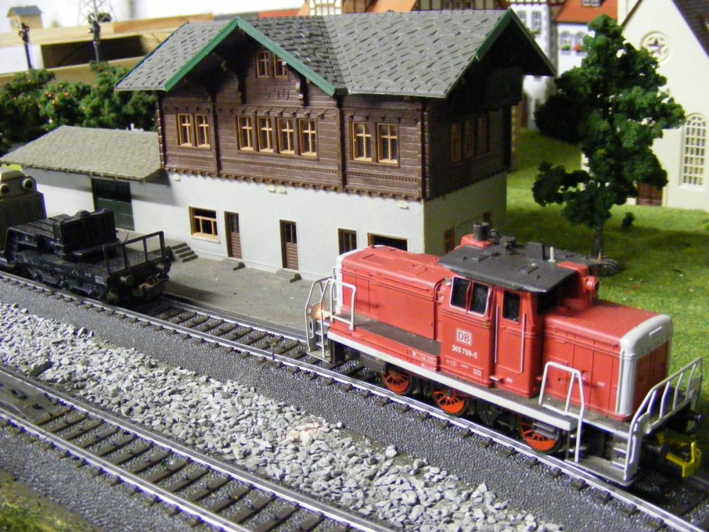

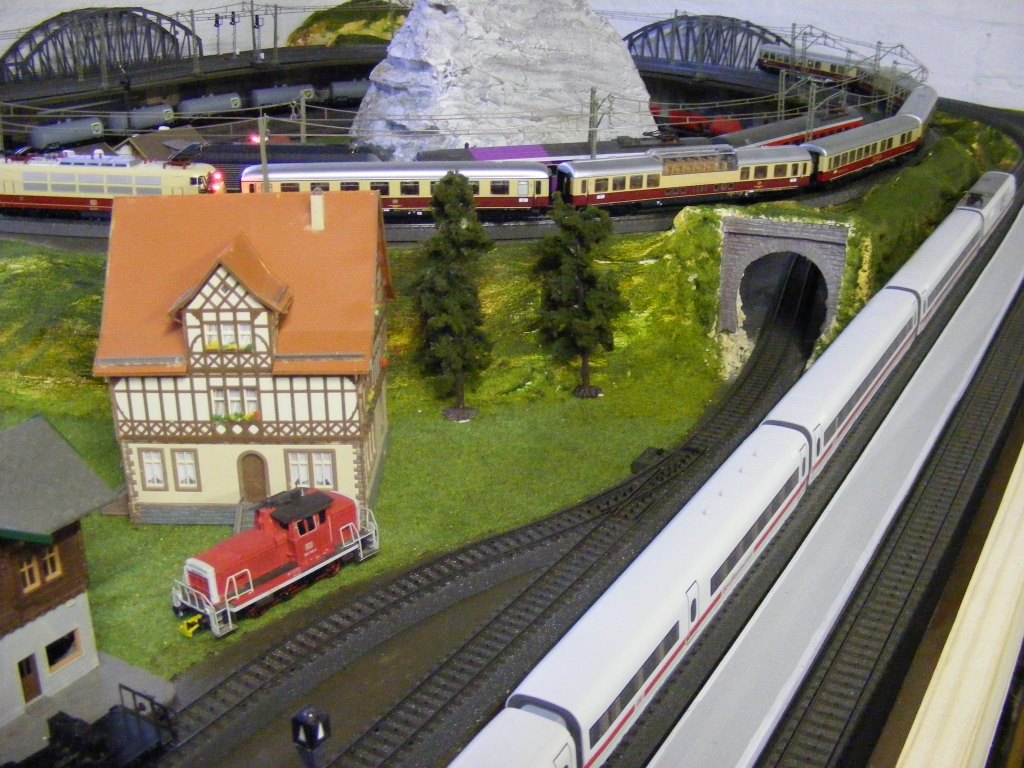

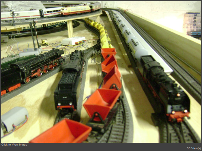

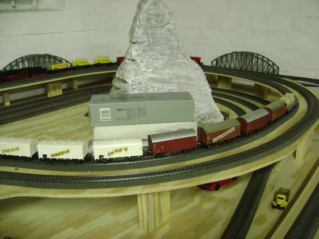

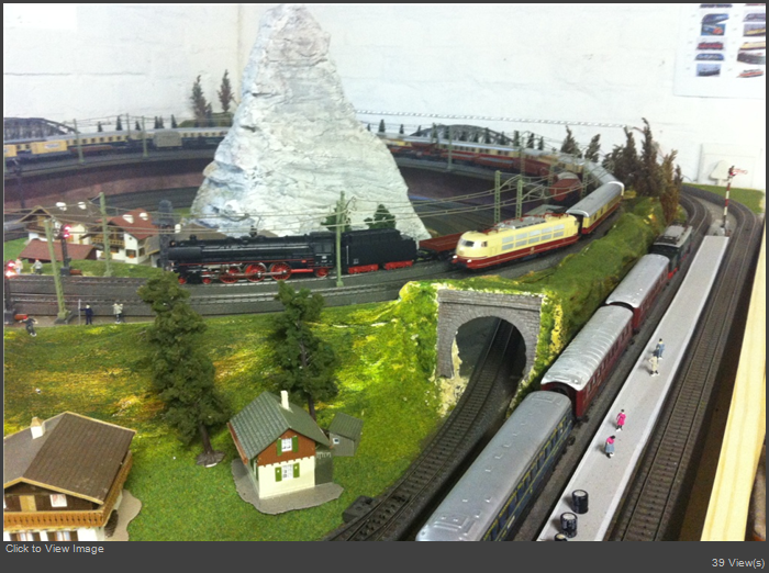

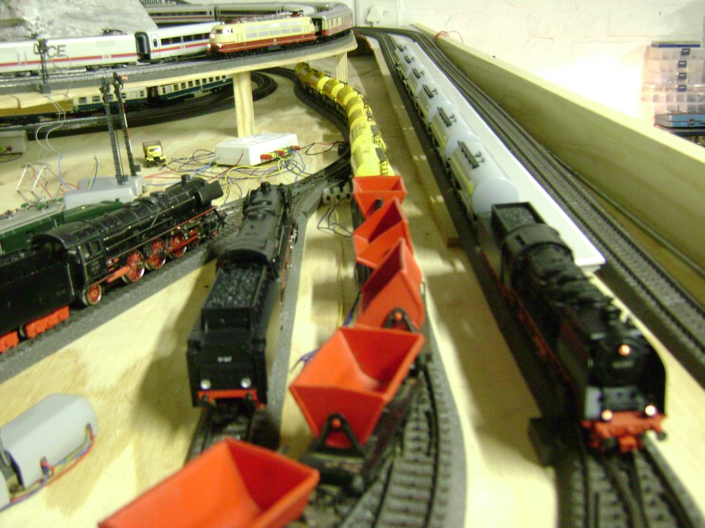

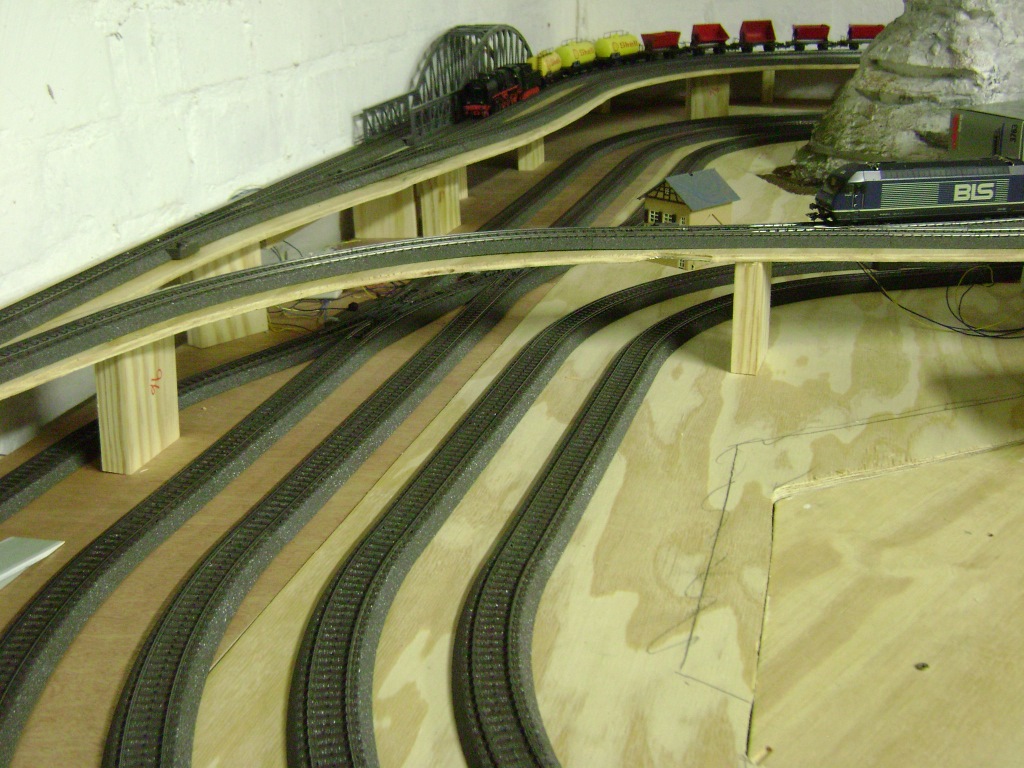

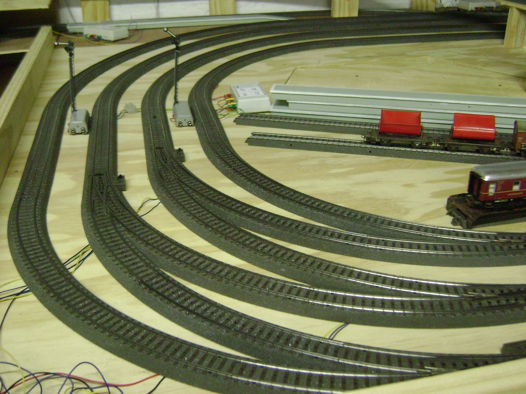

I have been running some trains on my new layout to test out everything before I commence with scenics and electronics.
I modifed the track layout with some curved turnouts so that you can switch from any track to any other track at the junction before the station area. You can see the multiple stacked curved turnouts in the photograph.
I also like the reversing loop out on the end which allows me to use R4 and R3 curves on the reversing upper level. My friend Terry helped me to add an extra 30cm in length and breadth to my original base board, you know, for that extra turning space. The lower level reversing loop is also fun to see the train disappearing and then re-appearing again from the same place.
It is for us a long weekend here, because Monday is a holiday, so I am hoping for some more progress on the layout.
Pictures attached :
Regards,BigGrin

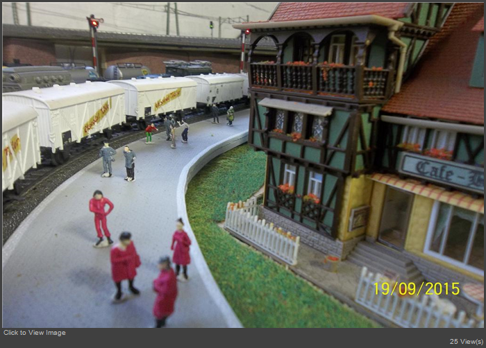

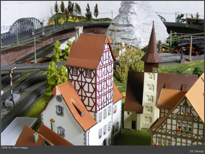

Offline Johnvr

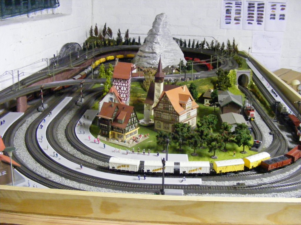

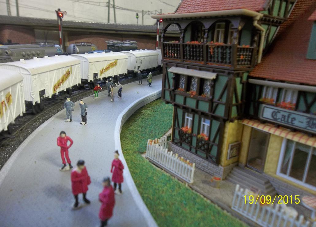

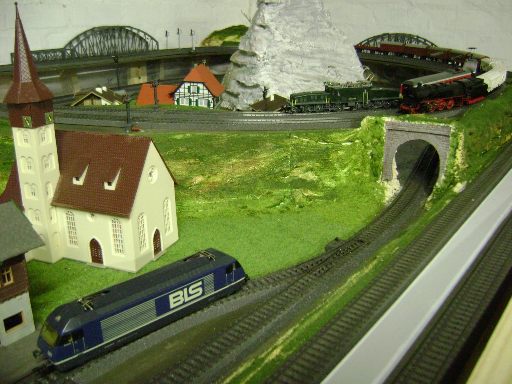

#21 Posted : 17 June 2015 13:32:52(UTC)
Johnvr
Posts: 1,307

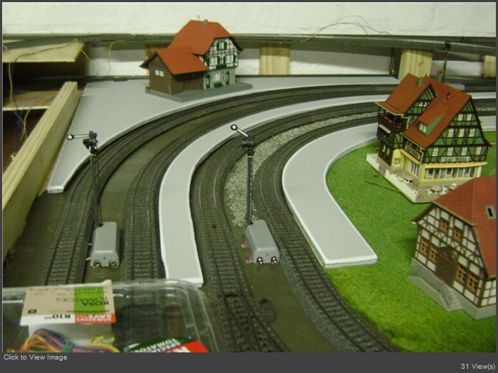

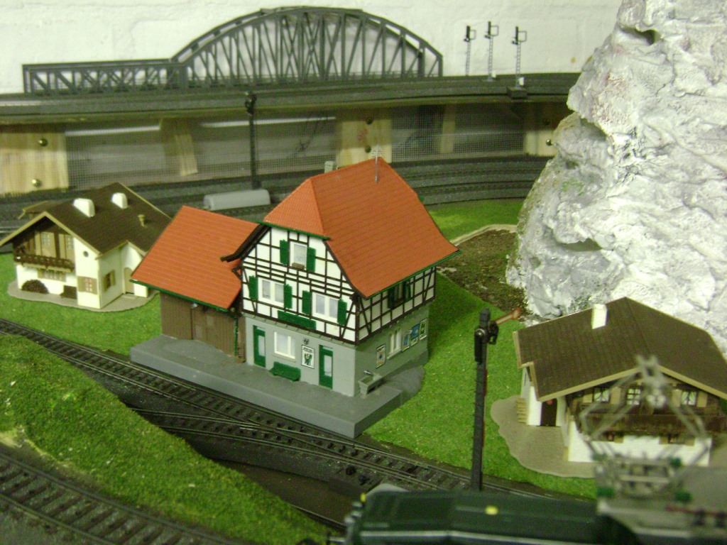

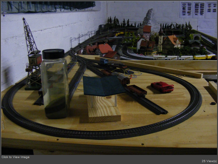

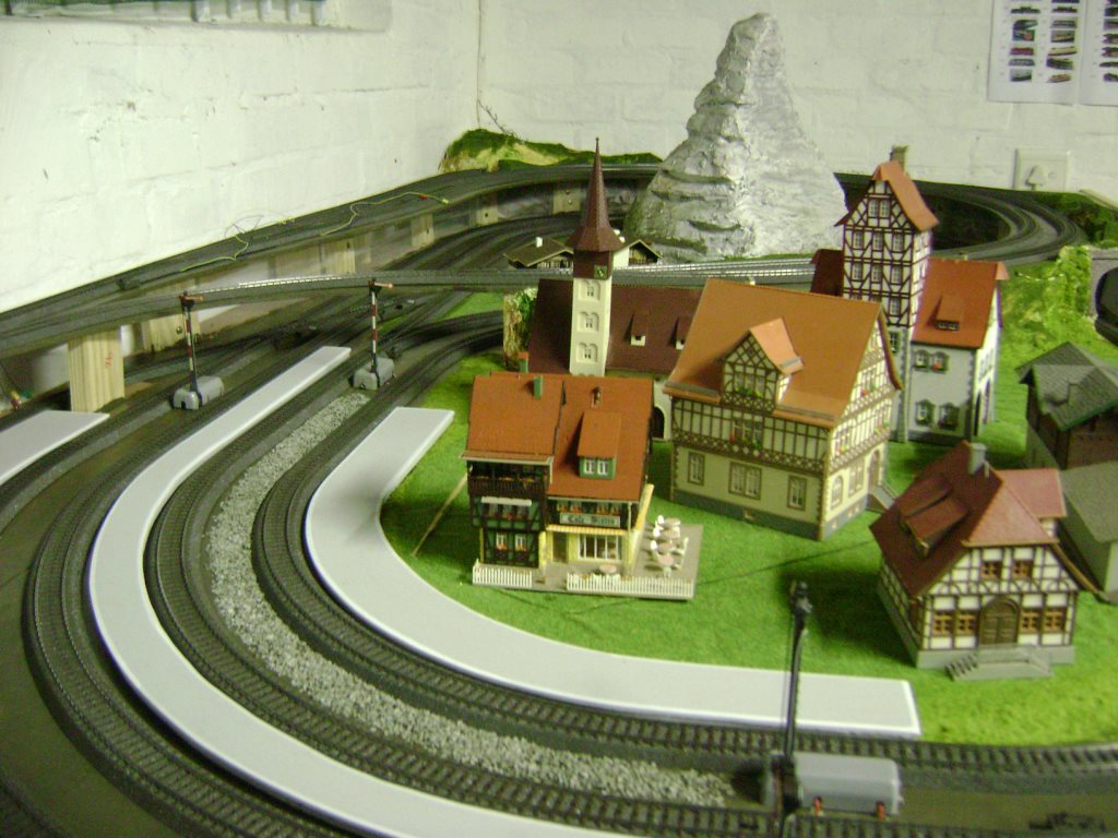

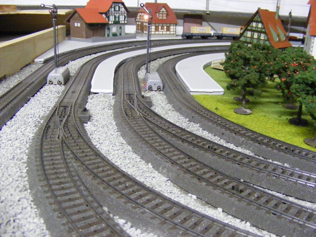

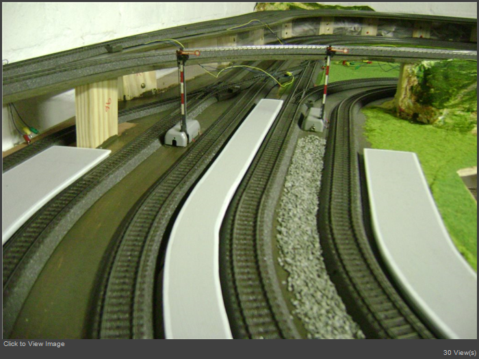

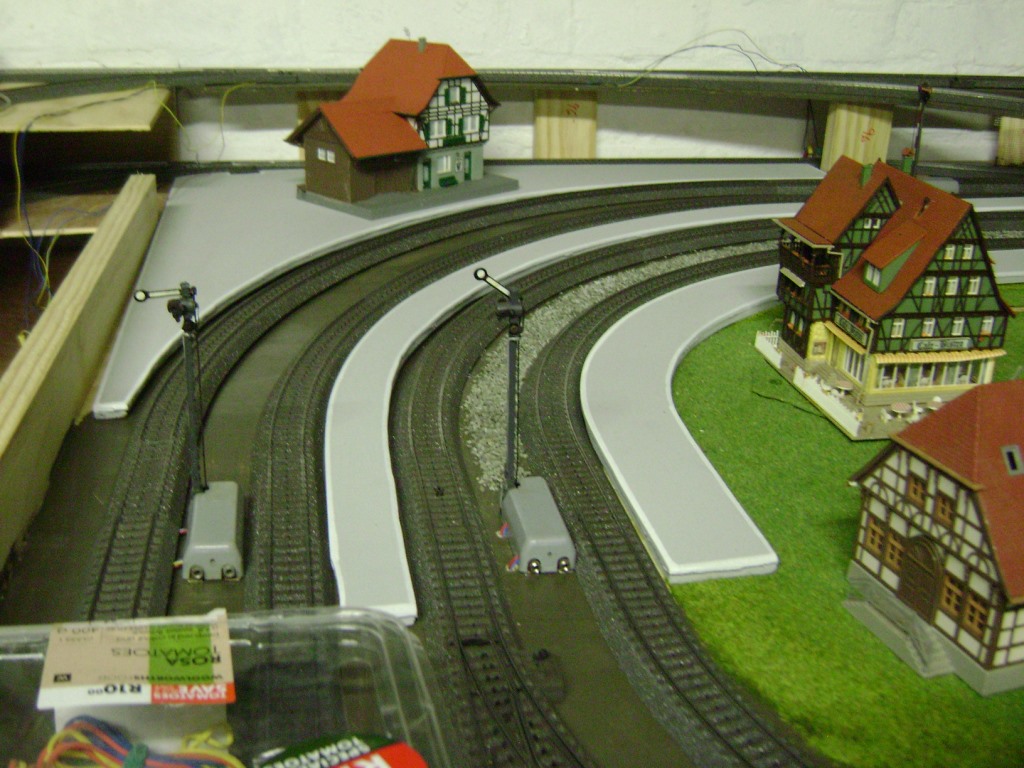

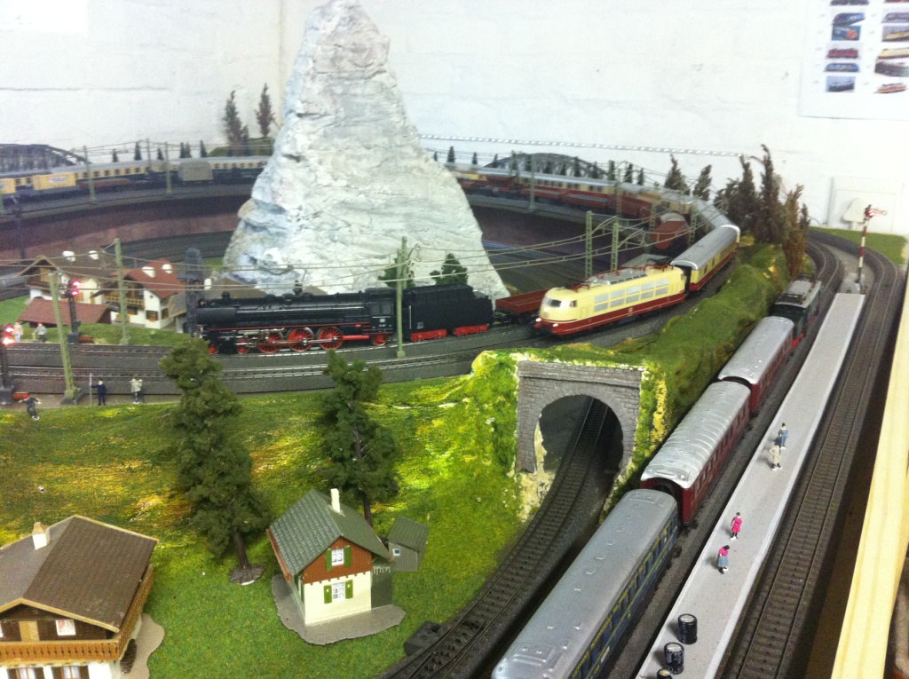

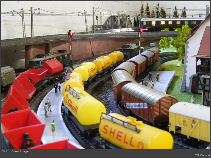

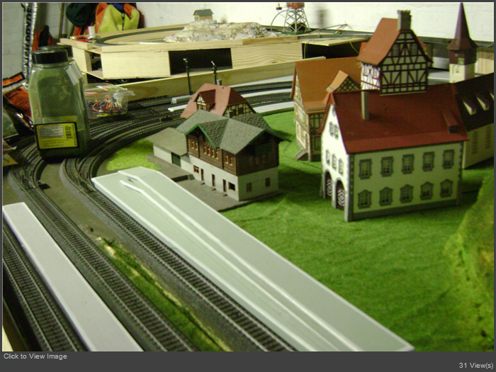

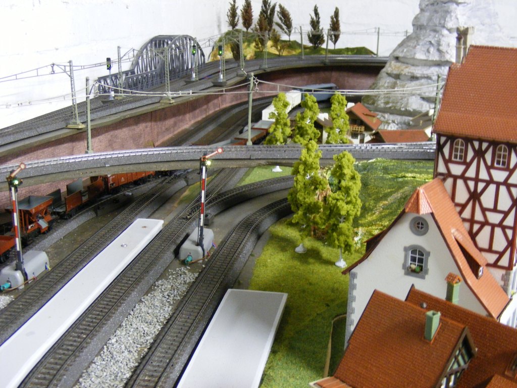

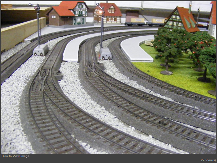

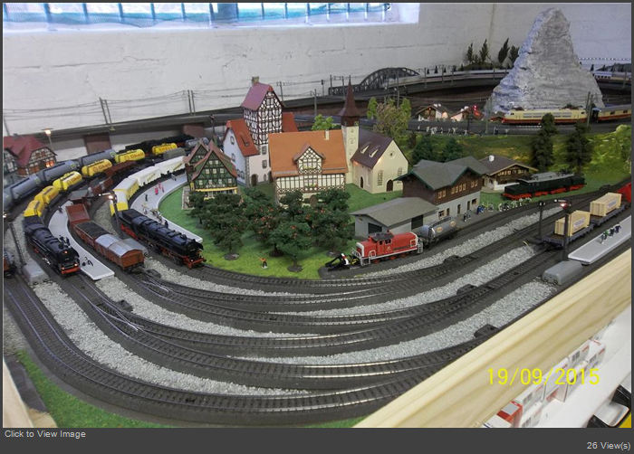

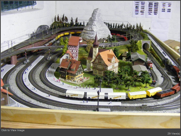

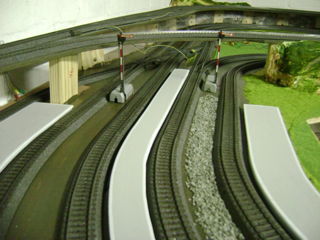

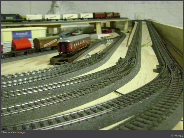

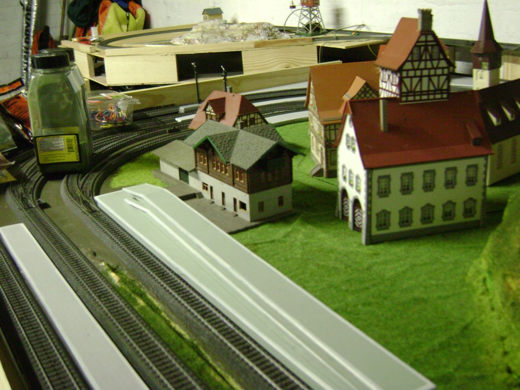

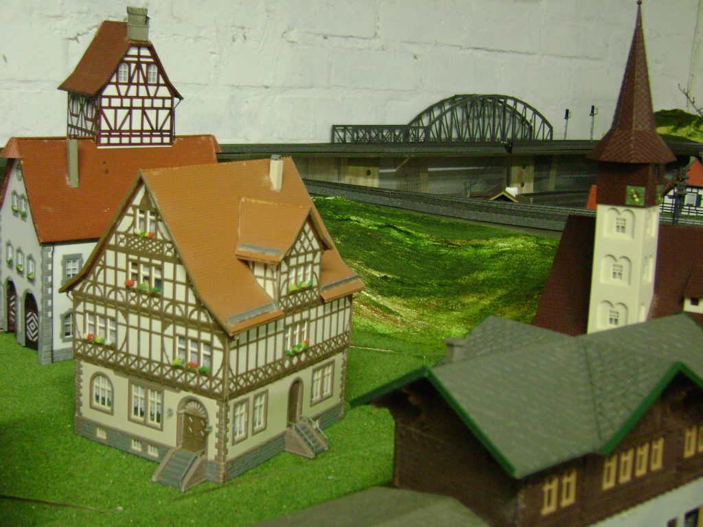

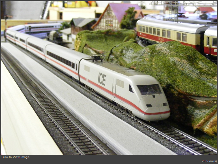

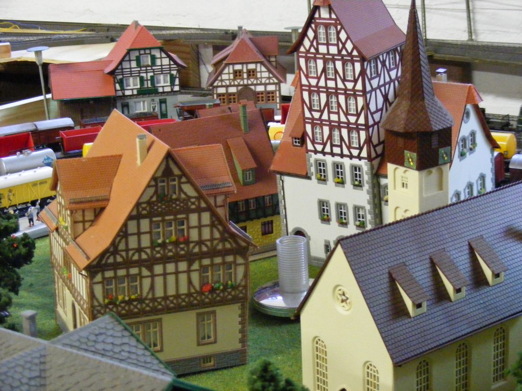

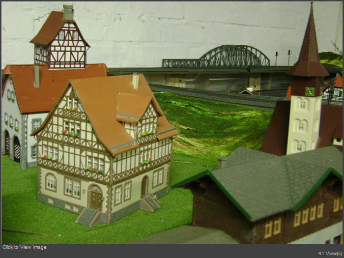

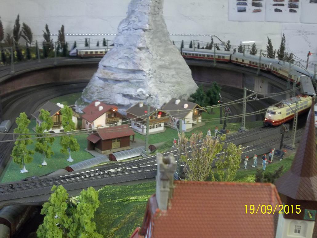

Time to update my story ...

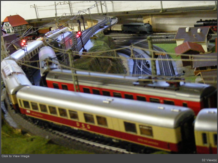

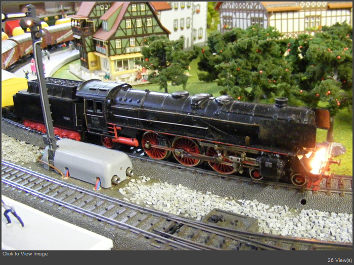

I have been working quite hard on my layout recently, first of all just running trains to see whether everything worked ok, and then to start building the scenery.
In the scenery building stage, I have removed all of the track, then done the painting, and now I am placing the track back into position.
My friend Terry especially cut the curved station platform area, using the R1 & R2 on the inside, and R3 & R4 on the outer side. I really think he has done a good job !!
My Matterhorn Mountain from my previous layouts has remained with me for this new layout.
I hope you enjoy the latest pictures ......Cool Cool Cool
Regards, BigGrin
thanks 22 users liked this useful post by Johnvr

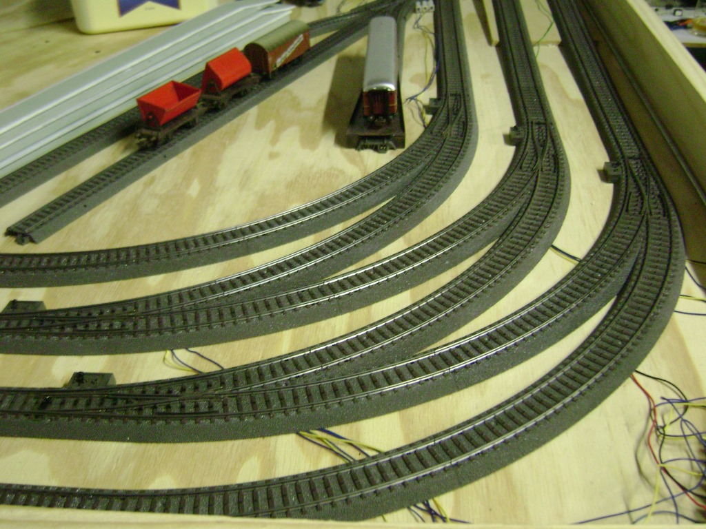

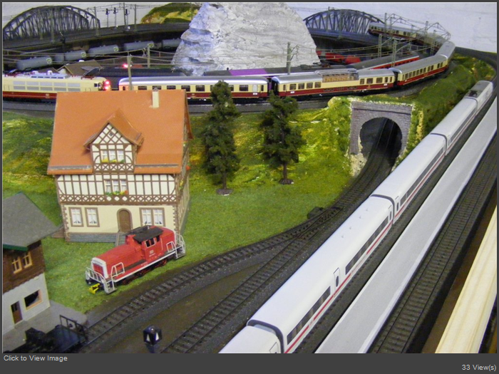

#23 Posted : 11 July 2015 19:53:27(UTC)
Johnvr
Posts: 1,307

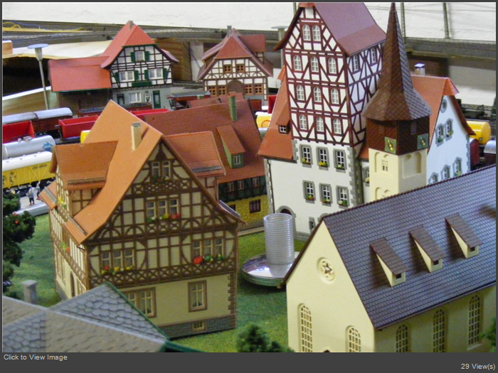

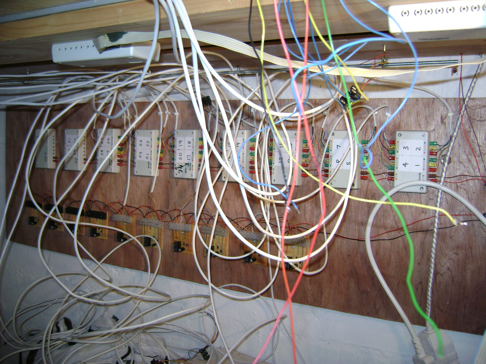

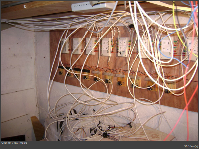

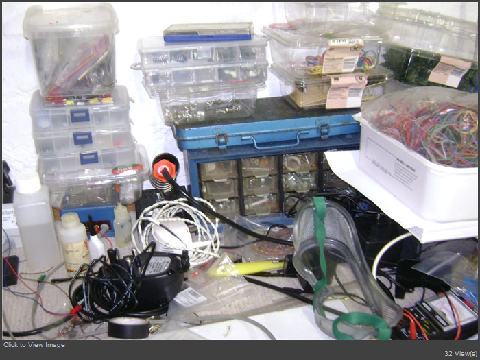

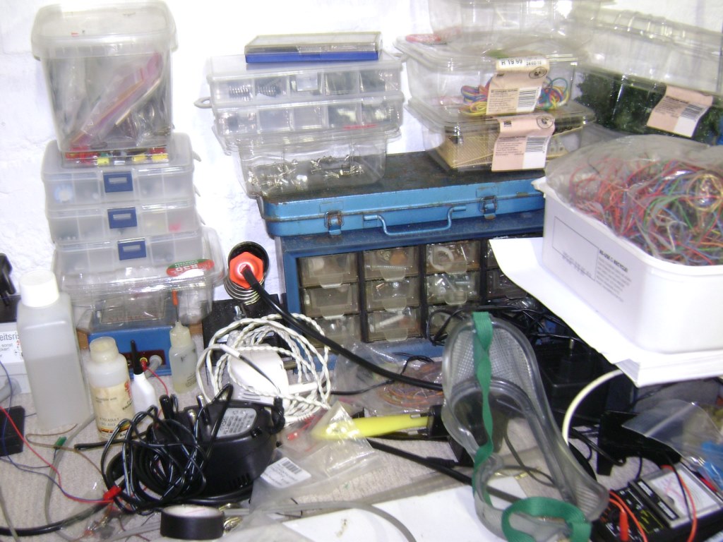

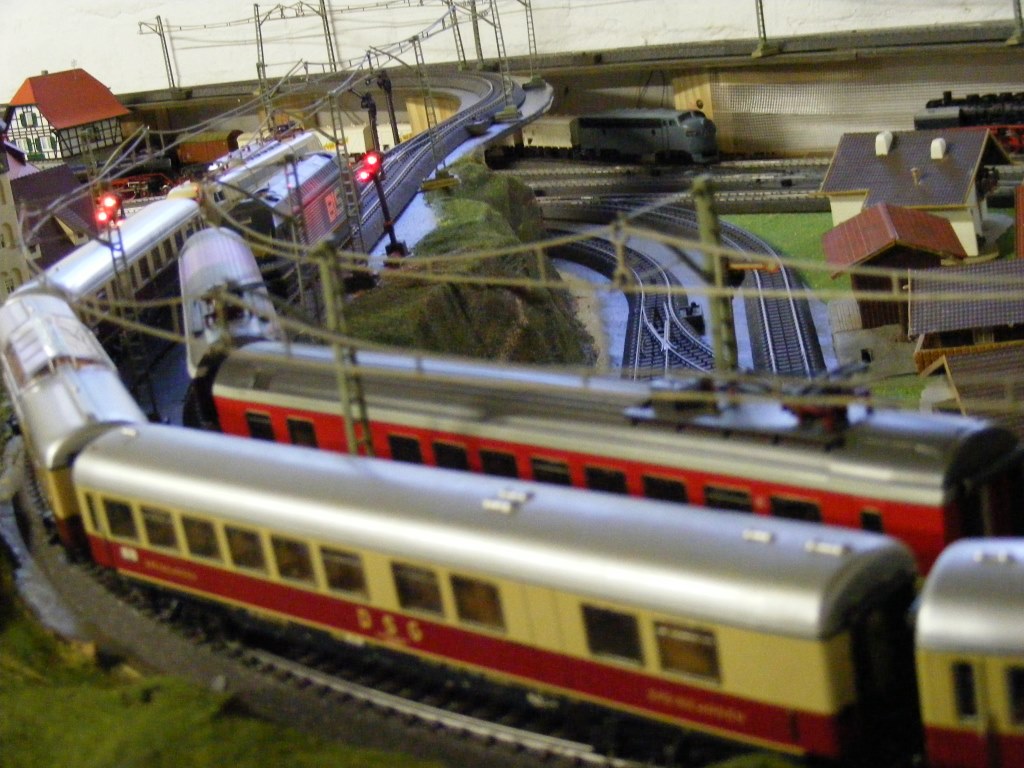

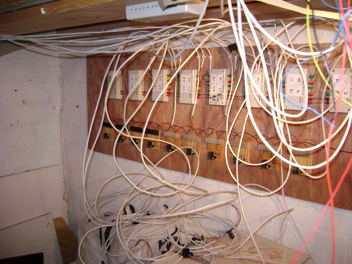

Some new pictures from today.
The progress looks slow because I am currently working on the wiring system Blink Blink
Have started to run trains, but this is only to check that everything fits ok. Still need to wire up the station signal and braking delay sections.
Regards,BigGrin
DSC00018 - Copy.JPGDSC00029 - Copy.JPGDSC00025 - Copy.JPGDSC00023 - Copy.JPGDSC00021 - Copy.JPGDSC00044 - Copy.JPG
thanks 19 users liked this useful post by Johnvr

John:
Everything looks great. Really nice work on the station platforms in those curves. Do you plan on wiring to have it as automated as your past layouts?
Chris

Offline Johnvr
#27 Posted : 13 July 2015 08:39:51(UTC)
Johnvr
Posts: 1,307
Originally Posted by: Chris6382chris Go to Quoted Post
John:
Chris
Chris,
Thanks for your nice comments on the curved station platforms. I have to admit two things : 1) they were made by my friend Terry in exchange for some work which I did on his layout, and 2) they look great !!! Using the curves R1 & R2 on the inner, and R3 &R4 on the outer.
Yes, layout will have lots of automation , including :
2 x s88 inputs, with 32 input triggers connected to 20 contact tracks strategically placed around the layout
10 x k83 with 40 output mechanisms, including 10 signals, 24 turnouts, uncouplers, etc
signals and braking deals of 1.2meters at each platform, for realistic braking into the platform and trains stopping at the end of the platforms
distant signals changing with use of "occupation detection" at various places.
CS1 control connected to 6021
various lighting systems in houses (lights flashing, disco lights in one house, platform clocks, etc)
I can't wait !!

Wiring jungle - not for the faint hearted !
All under control actually !
I decided to create an electronic board with all of my k83's linked together.
Also home made braking delays all linked together.
Useful 6 strand cables going out to pairs of turnouts, signals, etc
Has turned out to be a very easy wiring approach, all done on the workbench in the sitting upright position, before positioning in the current place.
Avoiding the upside down stuff !
Regards,BigGrin
thanks 16 users liked this useful post by Johnvr

My friends Joe and Terry and James popped in today to see what was happening on the layout.
So we ran a few trains and tested out some track running.
All went well, I am delighted to report.
There is still further work on the wiring and the s88 controls, so everything coming along smoothly.

Hello all,
I have been making very good progress !

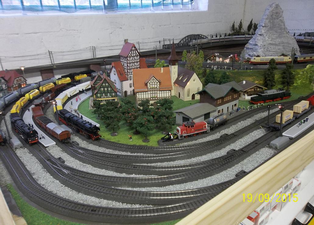

All of the wiring is connected and operating well. I have 2 x s88 inputs connected to 32 'flipper tracks' around the layout. The CS1 feeds these signals to the k83s and switched turnouts and signals on the layout. There are 10 signals with Braking Delays and about 20 turnouts.
I figures that everything works well enough for me to finish off the track ballasting and to decorate the layout with some more trees. Preisers and lights still to be added.

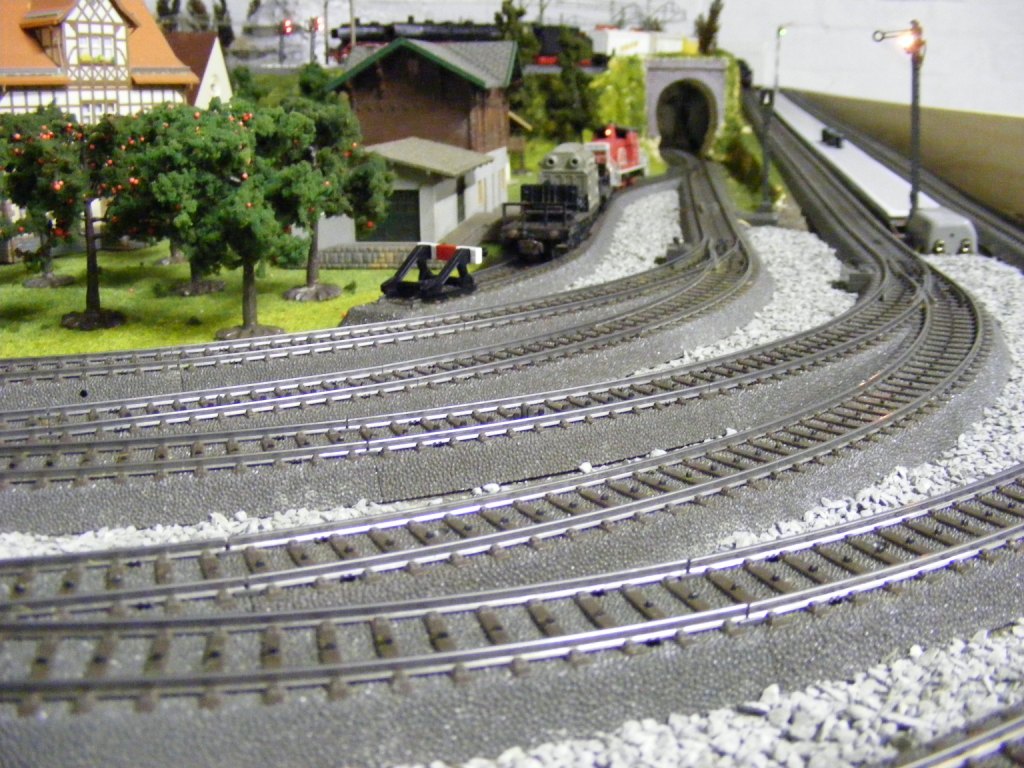

So here are some pictures from today :
Regards,BigGrin
DSCF3397 - Copy.JPGDSCF3399 - Copy.JPGDSCF3400 - Copy.JPGDSCF3412 - Copy.JPGDSCF3414 - Copy.JPGDSCF3402 - Copy.JPGDSCF3413 - Copy.JPG

The good news is ... I have been running lots of trains !
Especially older trains, older cargoes, older wagons.
Do you remember these wagons and carriages ?
They all run well on the layout !
I have been running seven trains on my layout, using CS1 automation.
4 trains in block formation, one behind the other, traversing upper level and lower leves.
2 trains on the upper level including the reversing loop twice around.
1 train on the lower level making a double-reversing loop and ending up where it started.
I am learning how to make a video using my phone device, and I shall post it shortly here.
Some pictures from this morning :
Regards,BigGrin
thanks 13 users liked this useful post by Johnvr

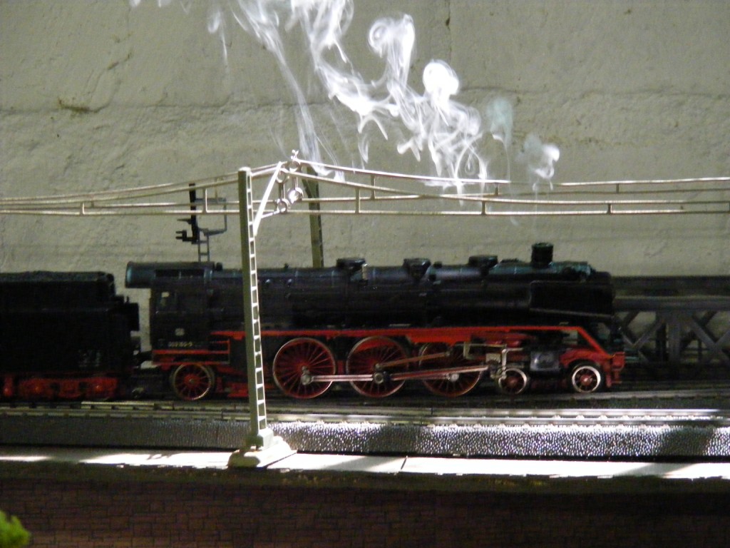

It's actually my "F800" featured in the video and in the picture above, but same loco chassis/body to 3048.
In fact, I have digitized all of the locos in the video.
All together, I have digitized about 35 locos myself, and only 2 of my locos came with digital decoders which I have not modified.
Regards,BigGrin

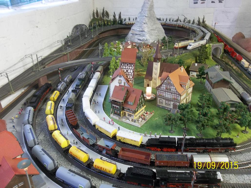

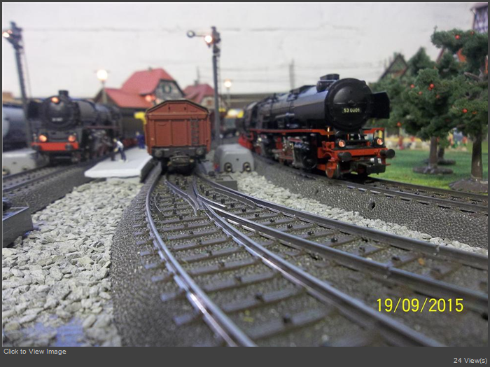

Joe and Terry came to visit my layout over the past weekend.BigGrin BigGrin BigGrin
We were running the trains using automated control, and glad to say, everything seemed to work well.
When visitors come to the layout, then I run some of my favourite locos : ICE2, Croc 3356 (14305), BR50, BR53, BR01, etc.
Joe took some pictures to record our fun :
Regards,BigGrin
JHB Apr2014 037.jpgJHB Apr2014 026.jpgJHB Apr2014 029.jpgJHB Apr2014 030.jpgJHB Apr2014 024.jpg

Looks like a lot of fun! What's the size of your layout?
I see an E94 in the grass, glad I'm not the only one offroading locomotives :)

The layout measures 2.6m x 1.5m in the area visible in the photos below.
In addition, there is a reversing loop in the lower left hand side of the picture, which measures 1.2m x 0.8m. There are two levels in the reverse loop for the upper and the lower levels, as per the picture below, and connected via a single line back to the main track area.
(PS This area is not yet finished !)
It is a lot of fun already !
There are plenty of reversing loops on both levels, and so I am running seven trains in automated mode.
In manual mode, I hope to run 3-4 trains easily, with a little help from the signaling system. Every signal has a switch track to switch the signal to RED after a train has passed, so that no train should catch up with another.Cool Cool
Regards,BigGrin

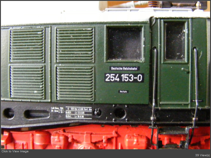

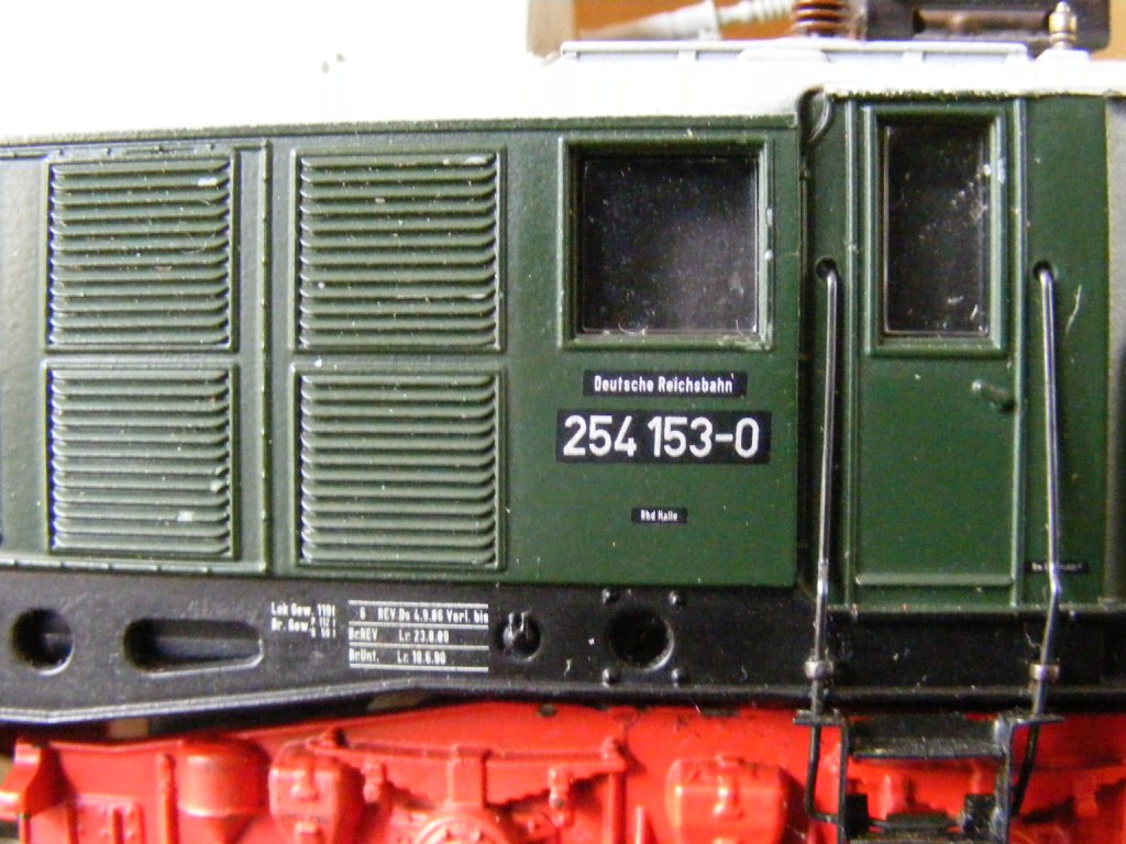

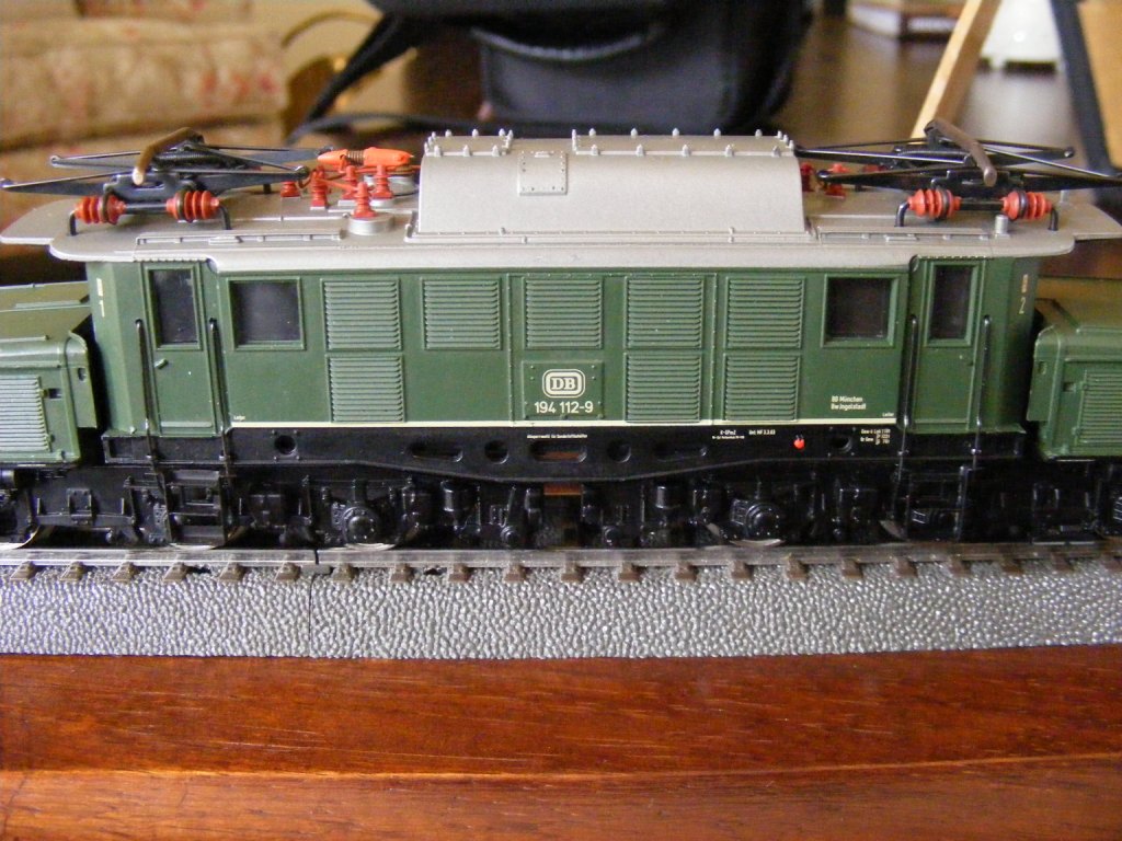

I would be interested if you could help me date the E94 locomotives in the video above.
The DB version (with the black wheel guards) came in a box labeled 3322 and it says "Made in Western Germany" on the box and also underneath the drive wheels on the chassis.
The DR version (with the red wheel guards) had no box when I purchased it, but it says "Made in Germany" underneath the drive wheels on the chassis.
As far as I know, the division between East Germany and West Germany began in August 1961 when the Wall divided the city of Berlin, and ended in October 1989 when the Wall was broken. I presume that Goppingen was always in West Germany even though it was outside of the Wall of Berlin, so where actually was the dividing line between East and West Germany ?
Regards,BigGrin

I have both of them. I bought them as second hand locos.
The "254 153-0" is Marklin 3335, but I don't know when it has been built. Mine is marked "Made in Western Germany" underneath the drive wheels.
Fabrice
