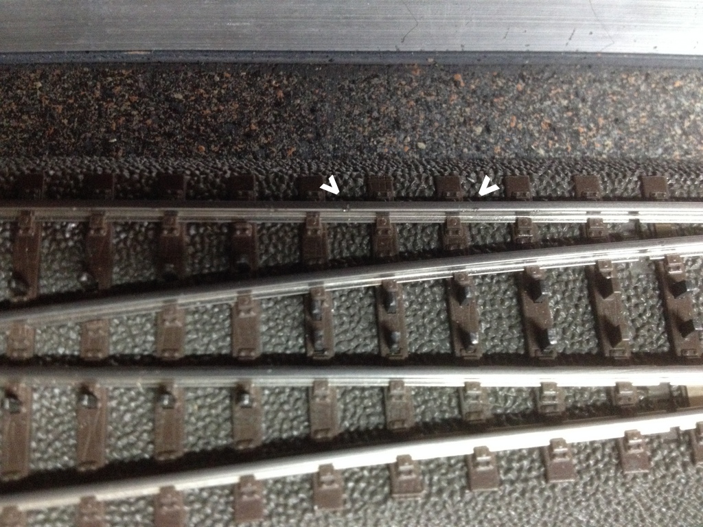

I have some old tin plate cars which are causing a short circuit on the 24711/12 turnouts.
As far as I can see, the wheels are touching the middle studs just after the metal frog at the intermediate railpiece. This would suggest that the distance between wheels is smaller than it should be.
I measured between 13.88 and 13.97, while wheels on newer tinplates cars are 14.3mm.
What is the standard distance between wheels on Marklin and is it possible that this changed over the years? My old tinplate cars date from the sixties!
(arrows indicate damage from sparks)

Thanks for your suggestions and replies.
I had some old wheels left and measured them all, substituted the smallest ones (the less than 13.9mm ones)
I also put some acrylic nail polish around the studs closest to the metal frog, to insulate the sides of the stud (sand the top a bit after it dries).
See photo, the six closest to the frog.
Et voila, my train and cars are running around for 15 min now, without drawing sparks on the 24711 and 24712 turn outs. Simple solution, a bit of insulation.
