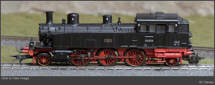

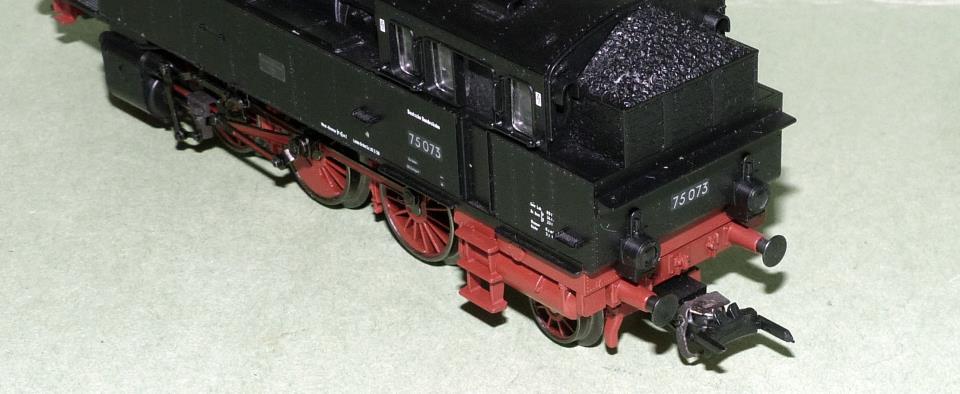

I have a 37132 BR 75 that has been modified with 177 993 Telex couplers front-and-rear. When running alone their release-tongues operate perfectly, moving up-and-down smoothly on command. However, the tongue won't move at all when connected to a car. The bases (coils?) of both couplers appear to be magnetized, holding the metal loop of an attached close-coupler too strongly for the tongue to raise. This occurs on both the front and the rear Telex couplers.
Since the tongues on both couplers operate well when the loco's uncoupled, I've assumed the wiring is correct. But . . . . . I've not tried to snip and reconnect the wires in another way, or to simply reverse them. Should I?
I'm considering buying another set of 117 993s for replacement. But before I do, I thought I'd search the Forum to see if there's an alternate fix, or if I've missed something simple & basic. I'd hate to buy replacements and have the same situation reoccur. In my search, I've not I've not seen a description of the specific symptoms I'm experiencing. Please tell me if I've overlooked any relevant posts.
Thanks for any suggestions -- Richard
FYI -- The loco couples well, with no unintended drops while running. It just won't uncouple remotely.
Additional Information -- After looking a bit further, I'm unsure whether the couplers are from Marklin or are Roco's equivalent 125 308 version. I'm also not sure whether that matters. If it helps, attached are two photos of the loco and its couplers.
Edited by user 06 May 2015 19:56:07(UTC)  | Reason: Additional info & photos

Hi Richard,
Is the Telex wired to the decoder common (blue ESU/orange Marklin) or the chassis frame ?
If to the frame that could be the problem...... not enough juice.

Shamu -- It's wired to the common & operates well when not coupled; e.g., the tongue moves up when powered, and stays down when unpowered. The problem is that the couplers are magnetized. In a simple test, both couplers will hold an extended metal paper clip firmly even when the loco is off-track and unpowered.
Thanks -- Richard

#16 Posted : 06 May 2015 21:41:12(UTC)
Posts: 15,879
This happens with some conversions where the couplers are fed pure DC. The metal parts of the coupler get magnetised permanently.
You could try removing the couplers and feeding them with raw AC for a few seconds to de-magnetise them. This is called degaussing.
I recall there were problems with the Marklin Br86 starter set locos which would get their rear Telex couplers magnetised by the field from the motor magnet. They would then not release their wagons either.

Ray -- Thanks for the suggestion. I assume direct connection to track power would work for the few second "Raw AC" feed. Correct? I'll try it this weekend. Best -- Richard

Originally Posted by: DumbGuy Go to Quoted Post
This happens with some conversions . . . . . You could try removing the couplers and feeding them with raw AC for a few seconds to de-magnetise them. This is called degaussing.
Ideally a connection to an analogue controller would be better, as a pure sine wave will degauss better than a square wave digital signal, but I guess it should work.
Don't keep it connected for too long as you might burn out the coil!
Ideally a connection to an analogue controller would be better, as a pure sine wave will degauss better than a square wave digital signal.
Hi Ray,
My "degaussing" experience & for others who may be considering the same approach . . . . .
I removed and tried to degauss the loco’s rear Telex coupler yesterday using an old Marklin blue-box 30 VA analog transformer for the AC feed. Started with a 5 second connection, then increased the time in 5 second increments, testing for magnetization after each attempt. (The coupler opened when power was applied.) The coil sparked and burned out at the 50 second interval. It remains magnetized.
Since the coupler was essentially unusable before I started, it’s not a great loss. I’ve left the front Telex in place temporarily (it still functions when uncoupled, but is also magnetized). I’ll remove it later, and keep both to test any alternate methods I may be able to find. The loco’s rear has a non-Telex close coupler inserted, which will work fine for now.
Other than these units, I’ve not physically held retrofit Telex versions from either Marklin or Roco. But from vendor photos & some YouTube videos, the couplers the loco came with are definitely not Marklin’s. I’ve ordered a set of Marklin 117993 Telex couplers for replacement.
I appreciate your advice. From my modest understanding of electromagnetic theoryFlapper , it seemed a logical suggestion that should have worked. A good learning experience.BigGrin
Thanks & regards -- Richard

These modern Telex couplers require special decoder settings to prevent them from permanent activation with "full juice". Maybe not a bad sign that it survived the 45 second degaussing.
Maybe the degaussing should be done with decreasing AC voltage - and surely for a limited period.

Thanks for sharing your experience. I'm sorry it resulted in the destruction of the coil. I guess it cannot sustain the current required to degauss it for long enough, so it is worth remembering that this method will not work.
Hi Ray & HO,
At the risk of TMI, I “sort of” tried HO’s approach during my degaussing attempt described earlier. My intervals up to 30 seconds first used constant accessory power from the transformer. Since the coupler remained magnetized, I changed to variable track power, increasing and decreasing voltage during several more 30 second intervals. I even tried applying a few higher voltage reverse-pulses during some of them. The coupler survived those trials, but remained magnetized.
After that variety of 30 second trials, I returned to using constant accessory power, increasing the interval in 5 second steps until burnout occurred at the magic 50 second level. I obviously over-stressed the coupler.
‘Nuff said. I’ll post a final update once I’ve installed the Marklin replacements.

Final Update: M-117993 Retrofit on my BR 75 . . . . .
Installed easily and works like a charm! The BR 75 now has a Telex close-coupler on the rear, and a non-Telex coupler on the front (photo attached). It will normally run in the forward direction with the Telex connecting to close-coupled cars. By switching its on-track travel direction, I’ll also have the flexibility to haul cars (in reverse) that have older Relex couplers.
I’ll reserve the 2nd Telex that came in the Marklin retrofit set to install on the rear of another loco (probably a nice BR 64) so I can use it with the same flexibility as the BR 75 now has. But at my current skill level, that’s a project I’ll postpone until I gain much more comfort with CVs, function changes, decoder connections, etc.
For more challenging fun, I’ll continue to look for & carefully try alternate ways to non-destructively demagnetize the one otherwise functional Roco Telex of the two that I removed. I’ll post here if I ever find a degaussing method that works. Advice still appreciated.
All-in-all, I’m quite happy with the outcome, and may be now just a tiny bit less “Dumb”.
Regards -- Richard
Options and Aesthetics: I have several locomotives with OEM Telex couplers – both old-style and new-style. I like them a lot. For locos without Telex, I use K83-controlled uncoupling tracks. Aesthetics -- Though it does function well, the retrofit’s appearance is bulky (right side of the photo) when compared with OEM, especially on a small loco like the BR 75.
DumbGuy attached the following image(s):
