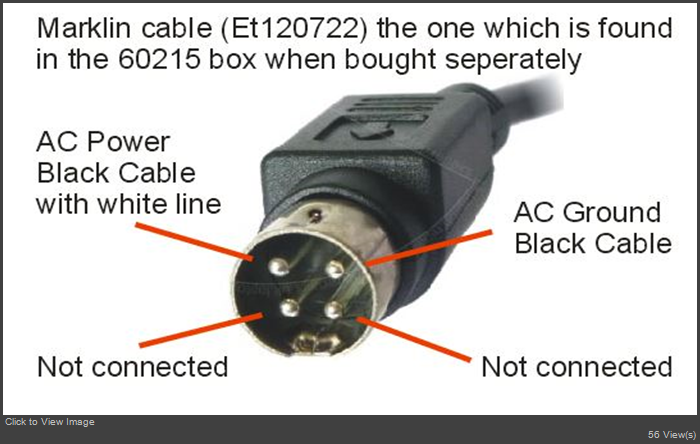

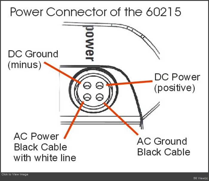

Here are the result of my messurements and the connections of the cable,trafo and CS
Cable Connections
Trafo Connections
CS Connections
/Kenneth
