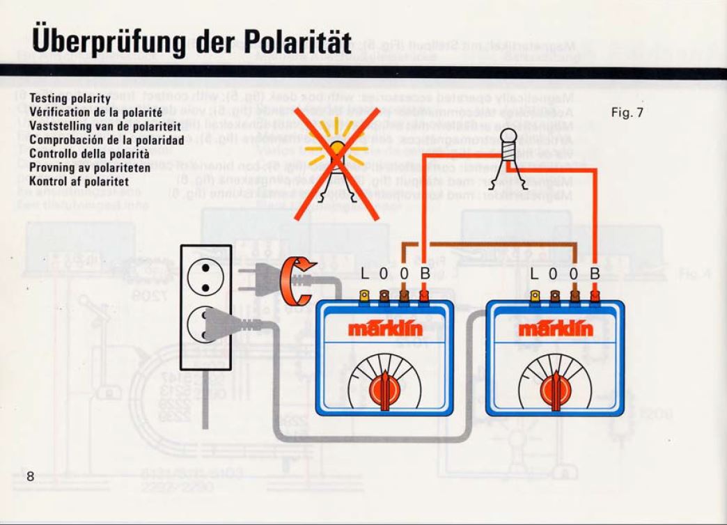

Offline Western Pacific
#22 Posted : 01 October 2013 17:03:21(UTC)
Western Pacific
Joined: 19/09/2009(UTC)
Posts: 841
Location: Lidingö, Sweden

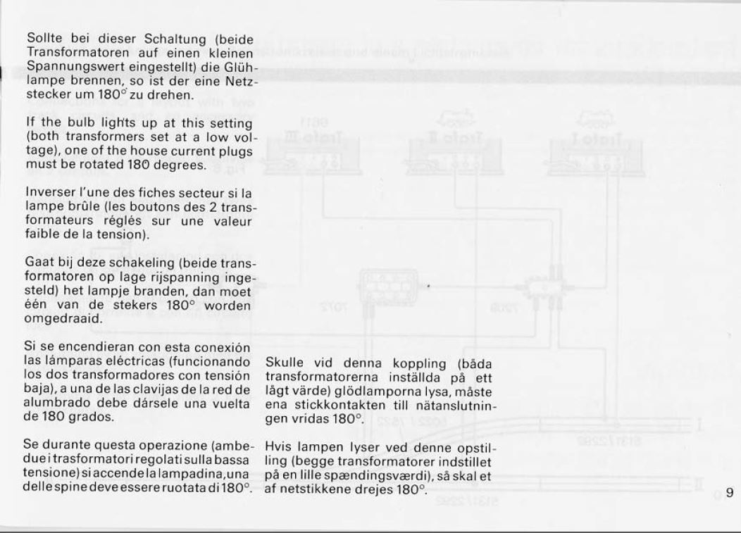

Regarding the phase difference. That is only an issue if you feed tracks from different trafos and the layout is designed for trains passing from a track connected to one trafo and then to a track connected to another trafo. The fellowing can be found in an instruction booklet for Märklin trafos:
"Checking the Polarity
When two or more train control transformers for different
track circuits are used on a layout, it may happen that
different polarities for the transformers may cause a strong
spark on the pickup shoe of a locomotive passing over the
separation point between two track circuits. In this instance
the plug on the power cord for one of the transformers must
be removed from its outlet, turned 180° and plugged back
into the outlet."
Another way than detecting sparks is to connect for instance a lamp of the type used for light in buildings between the yellow contacts of different trafos. The trafos are in phase if the bulb remains dark. They are out of phase if it lights up, in this case turn the plug of one of the trafos 180 degrees.
Attached for reference are the Marklin instructions for doing this procedure with analog transformers.

Thanks for your clear explanations & illustrations on phase difference & polarity-checking for an analog system. It was an important task, and pretty much what I’d done when I used multiple trafos to provide running power on an analog layout.
My concern voiced in Post #21 was if I needed pay similar attention to phase difference & polarity for a digital layout where all running power will be provided by ONE trafo, with a second trafo used only for accessory power (uncouplers & semaphores, crossing gates, etc.) – both transformers using a common ground.
From your comments, my concern appears to be a non-issue, and a polarity check is unnecessary. Am I correct?
Regards -- Richard
Regards -- Richard
Yes you are correct.

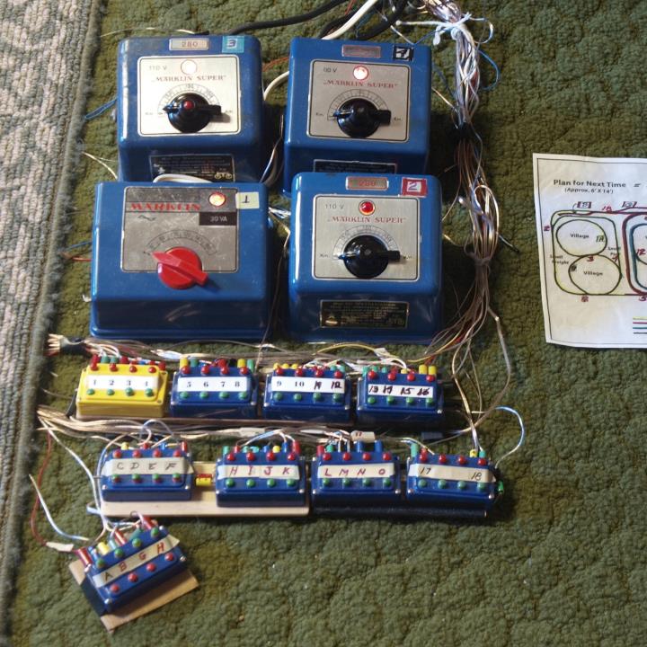

Yes, questions answered. My CS2 came with a 60055 at a very nice combined price. With a second transformer for accessories, power should be fine. I may do something more later, but that will wait until this DumbGuy has a bit more digital experience.
FWIW -- For nostalgic value, I’ve attached a shot of my totally in-phase M-Tracked Christmas Carpetbahn “Control Center” from several years ago. A fifth blue-box (not shown) was used for lights & accessory power. I’ve kept two of them – the others, along with most of my M-Track, found new homes through eBay. Ahhh . . . . . the charming fun of heavy metal, wires, buttons and knobs!
Thanks & regards -- Richard

Nothing I like more than a big block of analog transformers :)
Totally OT, but I've never seen a yellow control box like that before. Is it repainted? Is it a different brand? Or Marklin?
-Brandon

Gordon -- The yellow panel is marked “Marklin 7072” and is functionally the same as the standard blue ones. Not repainted & OEM, so it was perhaps made to highlight & use with especially important switches. I also have never seen another like it.
I have a bunch of 7072s, 7010s & 7011s, etc. Nearly all in excellent, non-sticky condition and they still fetch a decent price on eBay. As done with the old transformers, I’ll probably sell most of them early next year once I’m sure that control via the CS2, k83’s & Viessmann 5231’s satisfies me. But the old yellow panel won’t go away.
A related OT – I’d forgotten I had kept a photo of my old analog trafos & controls until I looked at archived files a few days ago. I like the memories and may even change my Forum Avatar to show it. But I also like my current Cat-Monster . . . . . . decisions, decisions.
Regards -- Richard

Very Cool Richard ThumpUp, That must have been quite the carpet bahn, there will always be great memories of my childhood associated with those heavy blue metal trafos.
The yellow control panel is actually a Primex item # 7156 made by Märklin in the 1970's, no doubt using the same mold as the 7072. Most of my control panels have gone to eBay as well but I will keep a few around for the nostalgia layout I hope to build some day.

So . . . Yellow = Primex. Nice to know & thanks for looking, Gordon. It’s still a keeper. As you have, I’ve also kept enough analog stuff to build a loop with a couple of switches & sidings if the legacy spirit ever moves me.
