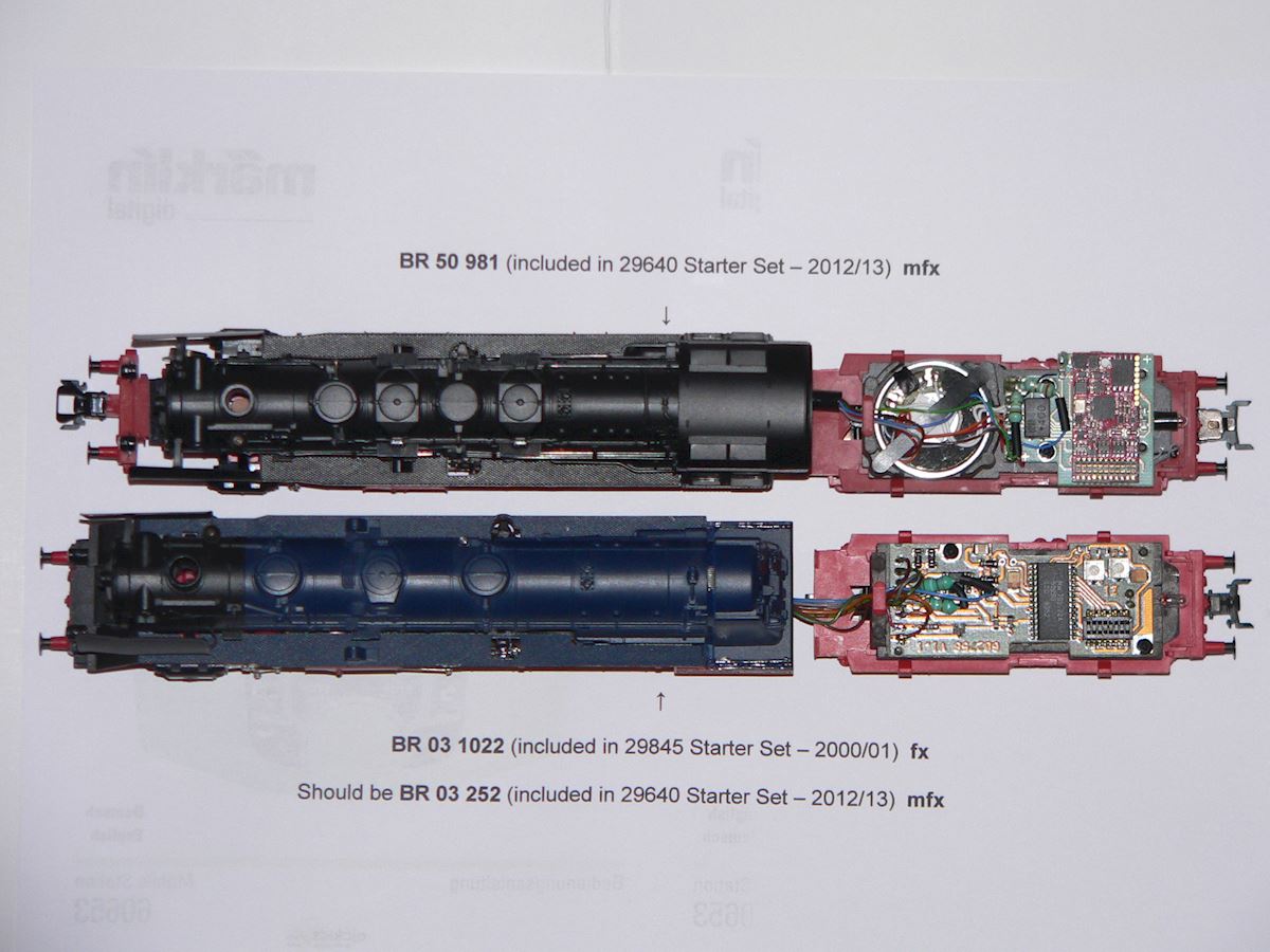

Please bear with me, I am brand new to Digital. I recently acquired a second-hand Starter Set 29640 "Era III" Mega Digital. Two steam locos with mfx etc. It was being operated successfully using a MS 60653 with 66361 Track Box and 66361 Power Pack. The MS powers up and displays and the 2 engines have previously been entered and appear in the display.
However, when I assembled the set-up, I found that the BR03 engine runs all by itself at constant speed around the track. The only function on the MS that the engine responds to is STOP and (non)STOP. No other control functions have any effect. Meanwhile, the BR50 loco just sits on the track, totally unresponsive.
Playing with all the buttons/knobs on the MS occasionally produces a display which briefly appears thus "Missing confirmation from mfx locomotive". Of course, there's nothing in the MS Instruction Manual that refers to this message.
I would be most appreciative of any help as my grandson is very disappointed (so am I).

#13 Posted : 09 August 2013 12:27:22(UTC)
nunk
Joined: 06/08/2013(UTC)
Posts: 66
Location: Logan Village, QLD
Firstly I deleted all the locos in my MS2. There were 7 listed, why I don’t know as I have only 2 locos. The locos deleted were:
BR 24 014
MM2 – 20
MM2 3
MM2 – 16
BR 50 981 DB
DCC- 0
BR 03
I don’t understand the MM2 and DCC references in relation to locos. The terms aren’t explained in the Instruction booklet. The BR’s are definitely locos.
Having now deleted all locos from the MS2, I set about reentering my two locos. I placed the BR 50 981 (29640) on the track and followed the instructions for:Entering a Locomotive with the resulting outcomes:
1. Registering an mfx Locomotive - No loco detected
2. Entering a Locomotive with a Locomotive Card - I have no card so could not action.
3. Finding a Locomotive (Select Find) - Loco found as BR 50 981 DB. Loco runs perfectly with all functions working. Excellent.
Note: This loco address is the same as the name set at the factory according to the loco Manual. This loco address is NOT in the Database. The Database lists 33840 BR 50 3448 but I found my Loco
did not respond to that address.
I removed the above loco from,the track and replaced it with the BR 03 and repeated the process with the following result:
3. Finding a Locomotive (Select Find) - Loco found as DCC – 0 (with f1, f2, f3). Loco responded to ON/OFF commands only. No control possible.
4. Finding a Locomotive (Select From Database) – 100’s of options available – couldn’t find the appropriate address.
5. Entering a Locomotive Manually - I couldn’t understand this section. MM2 Programmable, DCC, Domain. What’s that all about?? No explanation in MS2 Instruction booklet.
I then became suspicious about the BR 03 loco. After spending several hours with Professor Google, I concluded:
1. The BR 03 loco included in a 29640 “Era III” Mega Digital Starter Set is a 37957? BR 03 252 with name set at the factory: BR 03. ( I have the Manual)
2. The BR 03 loco that came with the so-called 29640 set I bought is actually a BR 03 1022. My research indicates that this is a 2000/01 model with fx , not mfx.
To confirm this conclusion, I removed the tops of the tenders from both locos and found the BR 03 has a 602758 fx(?) decoder. I could not locate a reference number on the BR 50 decoder but assume it’s the latest version mfx decoder.
I’m going to contact the vendor and try to get resolution to the problem of the substituted BR 03’s.
In the meantime, is there any way of getting the BR 03 1022 to operate on my set-up (MS2 and C-track)??
nunk attached the following image(s):
#14 Posted : 09 August 2013 14:17:56(UTC)
Posts: 15,466
That's an old fx decoder with DIP switches that set the address.
See this page under "Märklin-Lokomotivdecoder im Digitalsystem (Motorola)" for a list:
http://www.hamst.de/html/decoderadressierung.html
Find the current switch settings in the list or choose an address (e.g. 50) and set the switches for that address.
Register the loco manually as MM (there are two MM options - and MM programmable is the wrong one, use the other).
Starter set locos should be listed in the MS2 database with the starter set ref. number 29xxx.
The 03 1022 should be from 29845. BTW: According to the number it is not a BR 03, but a BR 03.10.

#15 Posted : 10 August 2013 06:22:53(UTC)
nunk
Posts: 66
Thank you Tom.
Firstly, I decided to search the MS2 Loco Database for 29845 which is the Starter Set that I believe my BR 03 1022 originated from.. I found and selected it.
The MS2 screen now displayed BR 03 and 4 icons: Headlights in f0, Smoke generator in f1, Running gear lights in f2 and what looks like a turtle in f4. I think this is for ‘Switching Range’, whatever that is. I can’t discern any difference to the loco running whether it’s on or off.
Now the loco will run and obey all available commands from the MS2 The only problem with its performance is that it runs in a continuous hesitant, jerky fashion. Not smoothly like the BR 50 does. This is not good! Any ideas why??
Secondly, I entered a ‘New Loco’ via Enter Manually/MM2 Coding Switches/Address 3 (according to the dip switch positions) and named it BR 03 MM2.
The MS2 screen now displayed BR 03 MM2 and Headlights in f0, plus f1, f2 and f4. I changed these latter three to the same icons as above, respectively.
Again, the loco will run and obey all available commands from the MS2 with the only problem with its performance being that it runs in a continuous hesitant, jerky fashion.
So there we have it. Definitely the incorrect BR 03 loco has been supplied with the set, I’m going to try and get this resolved with the seller. I’m not holding my breath though!
Regarding the number, my searches with Professor Google (Search, Images, YouTube) confirms to me that it is a BR 03 rather than BR 03.10. It has a black boiler and spoked front bogie wheels, if that's any help.
Neil

Re Motorola 03: mfx decoders support the fx protocol in the absence of mfx, so address 03 is correct for those with old controllers.
Re spare parts: two or three years ago Märklin switched from selling parts to selling "bags" and they introduced the leading E for spare parts (Ersatzteile).
Breaking off a buffer was not cheap in the spare part days, but can be really costly in the bags days (EUR 5 vs. EUR 20).
The locos from 29640 and 29845 should be from the same mould, but due to different colours, different lettering, and different ages (sound => speaker) there may not be many shared big parts.

I've now dismantled the BR 03.10 to get to the motor. Thanks to the larger detailed exploded diagram you sent, it made the job straightforward. What I found was that one of the brush tension springs had corrosion deposit on the coiled portion. This effectively cemented the turns of the spring together and prevented full tension from being developed at the brush. I carefully removed as much of the deposit as I could, put a tiny drop of WD-40 on the turns and it all freed up nicely. Cleaned the motor housing with compressed air and also cleaned the commutator (5-pole armature). Hardly any wear on the segments and there is still plenty of life left in the brushes. Reassembled, lightly oiled the moving parts and tested on the track. Now runs perfectly!!
I've yet to experiment with the ABD and Max speed pots. Of course there is no Volume pot that I can see on the 602758 decoder.
Also, I've now viewed the loco in daylight and you'll be pleased to know that the boiler is indeed blue, with the nose and wind deflector section being black. Almost impossible to spot that under incandescent/fluoro lighting.
