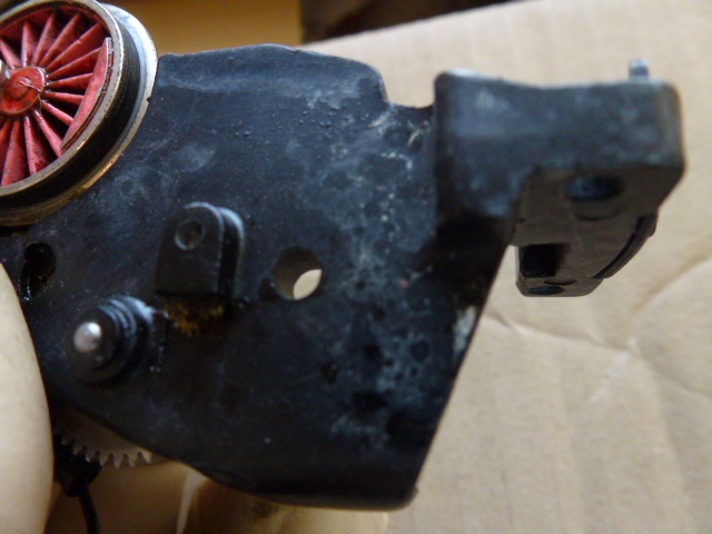

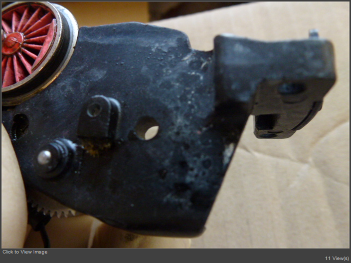

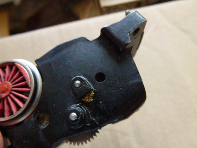

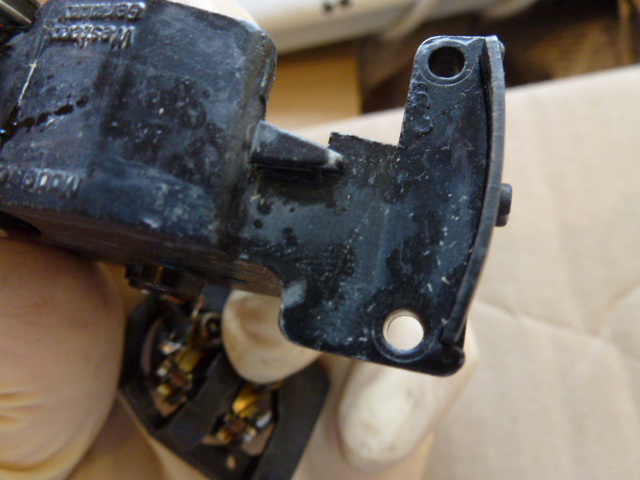

A little update on this is due. Yesterday I just couldn't take the greasy smelly locos anymore. I've took two for sacrifice in the name of knowledge. One a 3048 which wasn't perfect but not too bad and should have probably been spared. The other one a 3005 in terrible condition and much more up to the task.
First one was the 3048 immersed in a methylated spirits bath, other than the brush holder, lamp and a couple of cables all electrics were removed.
After a couple of minutes it was lightly brushed and dried out. My results: it was cleaned but still some of the oil and possibly wd40 linger in some crevices.
There was a light white staining residue left on the black areas of the chassis which later on was cleaned by using some car polish and that ended up looking quite neat. The main problem was that it did affect the red paint of the wheels and the rods. It made it go a bit lighter in colour in some place it started to come off.

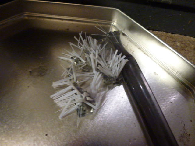

Since I wasn't convinced about that the 3005 was bathed in turpentine instead in this one the wheels were removed as well, the rest was the same as the 3048. Results: the turpentine turned dark almost immediately and the loco was cleaned by far more effectively. It has also softened the red paint of the wheels and the rods. However it didn't cause as much damage to the red paint as the metho produced on the 3048.
It was interesting to see the effect the turps caused on the toothbrush used for cleaning LOL which made check immediately the brush cover, 2 nylon gears and the few cables left. To my surprise none of them were affected but the toothbrush is a very good warning for removing all plastics. This method didn't leave stains behind.
My conclusion: while I am not disappointed because the two engines were not presentable the way they were. I will only repeat this on locos that have serious problems or that I am considering to refurbish quite extensively. No good engines should be put through this. After this I am more keen to try the ultrasound method.
Just a brushing with hog hair or plain plastic wouldn't have done. There was oil in the brushes cavities, in between the contact plate and the sky pick up and everywhere else you can or can't imagine. Below you'll find a couple of photos of the 3048 with the stains and after the car polish you can partially see one of the wheels and some of the damage. If I repeat this I'll go directly for the turpentine because it caused nowhere near as much paint damage and it was a much better cleaner.
