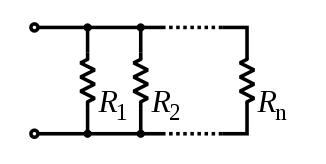

Hi Walter, I am a little puzzled by your question.
When you ask about wiring in Series, do you mean like you would wire several lamps - ie one lead from the power source to one leg of the first lamp, then the other leg of that lamp to the next lamp, continuing on with the final leg of the last lamp going to the other lead back to the power source?
This method means that if you had a 16v supply, and you had 16 x 1v lamps, they would all glow at their correct brightness, but if a single lamp fails, none of them work. This is generally how older Christmas tree lights are wired. You had (for example) 240v going in, but each lamp was 12v, therefore you would normally have around 20 lamps - 20 lamps x 12v = 240v
In Parallel, both legs of each lamp are wired to the same two wires from the power source. The lamps must be rated the same as the power source, but if one fails, the others will still glow.
So if you are talking about wiring each decoder from one to the next in Series like the lamps, I'm afraid it simply won't work, a digital signal must be direct from the source, Red to Red & Brown to Brown, which is indeed Parallel and is the only way it would work.
But if you really are concerned about use of wire, you could tap the Brown for each Decoder from the Track outer rail because there is always going to be track nearby, and simply run the Red as a separate wire. The original 'dream' was that there would be no separate wiring for any decoders, they would all just be connected to the nearest track, but the reality of course is that many people preferred to power their decoders separate from the track to keep maximum power for the Locos and on larger layouts Boosters would be used.
Or have I mis-understood your question?
Steve
NZ

Each decoder has red and brown on both side. You can connect the first decoder to the track (e.g. on the left side) and connect the left side of the second decoder to the right side of the first decoder.
If you have 10 decoders, the current to the last decoder will flow through 38 plugs and 9 decoder PCBs while the current to the first decoder goes through 2 plugs only.
Actually the decoders are in parallel, but they are chained. The alternative is direct connection of each decoder to a power distributor.

This is what I'm looking (one of them).
Walter
waorb attached the following image(s):
#11 Posted : 24 July 2013 01:06:06(UTC)
Posts: 4,013
So, I will ask for opinions: Which is a reasonable number of k83 installed in series? Is there a theoretical max number of decoders in series?
Hi Steve!
Walter
Ah ok, gotcha now. Blushing
I remember seeing that diagram now but couldn't recall it when trying to understand your question. And I could not imagine anyone trying the Serial method I first queried. Confused
I would normally have referred to the Serial method as "Daisy-Chaining", like you can do (in theory) with USB, SCSI or MIDI, into one device and out onto the next. The reality is the signal loss quickly adds up for devices that don't have separate power and a Hub or Signal booster/replicator is usually advisable.
So, in a digital sense they are essentially the same, but I would tend to think there would be more reliable connections from the Parallel method than Serial but only if fewer connectors are used.
ie; if you used the small Marklin distribution blocks, then they are probably much the same. I can see the Series method being more useful when you have several Decoders very close to each other, and it would also look very neat and tidy.
The Parallel method may suit better when Decoders are spread further apart.
Thanks for the image to understand your question.
I'm thinking that this is the best solution...
Yeap.
Like Tom also said, the power distributor can be used...
I think I'll "merge" both diagrams... using 2 or 3 decoders in "series", in a diagram of 3 or 4 in "parallel" (in this case, all connected in power distributors, directly connected to the power source).
I have 13 decoders in total. So it's not too much work...

All K83 decoders should be wired in parallel so if one goes faulty the whole lot are not lost okay
old toot
#21 Posted : 27 July 2013 08:00:08(UTC)
Posts: 9,301
Hi Steve!
Walter
I use contact plate(Brawa) to feed out to all decoders and to the tracks too.
Also to feed digital power to the turnouts motor(Tortoise) to feed frog of the turnouts(polarity + or -).

The real problem about connecting digital system is to connect as a ring,because it interferes with digital traffic.
I have read this before and still not understand it….
Some DCC expert says your wire bus should never be in a loop.
Ok, that may make sense but what about the simple oval track running above? Isn’t that also a type of wire bus which is a basic loop?
Never heard any recommendation from Marklin that should isolate your oval digtal track layout?
Brgds - Lasse
#24 Posted : 27 July 2013 08:48:21(UTC)
Posts: 15,474
I don't understand this either.
Can we have a link to the source of this information, please?
#25 Posted : 27 July 2013 09:24:47(UTC)
Posts: 9,301
Marklin did told this information to customer when connecting digital wires as power feeder.
Sorry...i don´t have source to links.
By the way...why only to show up series or and parallel???
If there is no interupt of connect digital wires as loop or ring...why not show this as results???
#26 Posted : 27 July 2013 10:17:58(UTC)
Posts: 9,301
