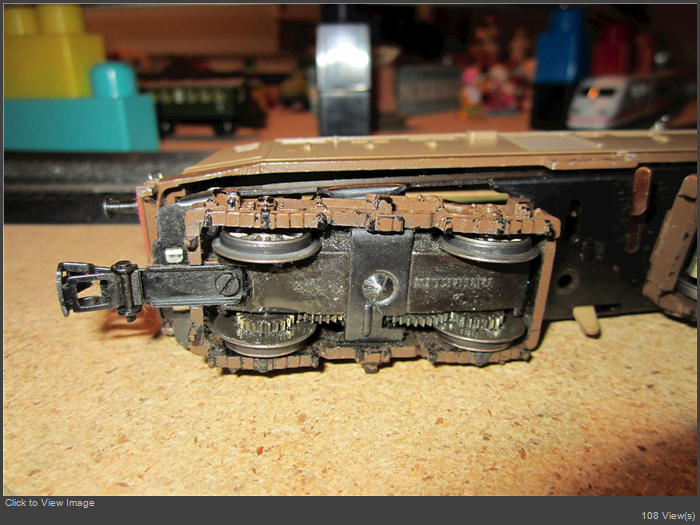

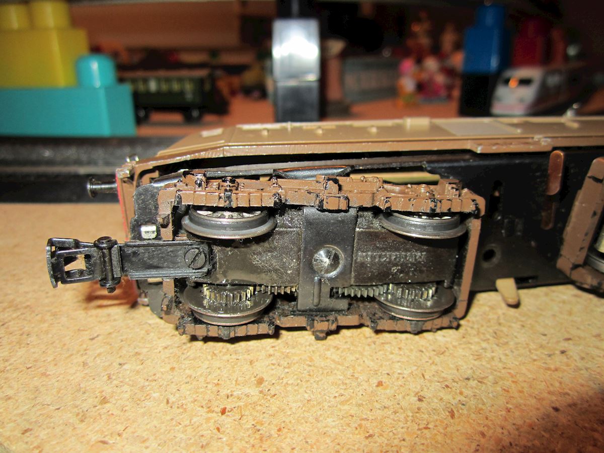

Offline baggio
#12 Posted : 18 May 2013 05:52:37(UTC)
baggio
Joined: 21/09/2012(UTC)
Posts: 1,730
Location: Toronto
Thank you all for the very helpful feedback. BigGrin
Here are some pictures of the loco and my rough layout.
baggio attached the following image(s):

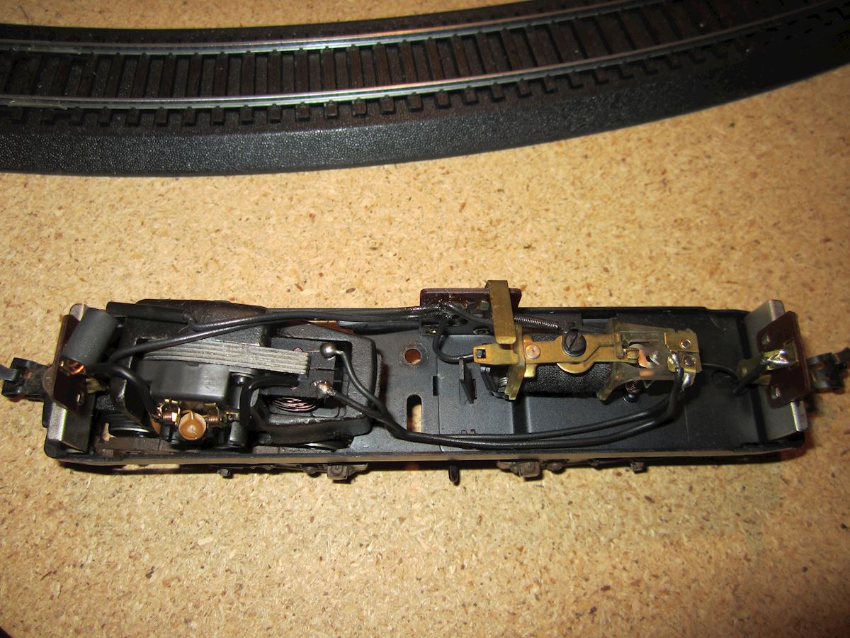

Offline abisel
#14 Posted : 18 May 2013 14:46:05(UTC)
abisel
Joined: 07/12/2012(UTC)
Posts: 139
Location: St. Charles, Missouri
Yep, a good cleaning is in order.
Picture 8 of the drive bogie tells all.
Picture 4 shows the earlier motor shield with the older carbon brush (left) and wound wire brush (right). The wound wire brush appears to be worn the most. And I suspect the flat contact surface of the armature to be worn with carbon build-up and arching. You may need to replace the armature unless you can polish the contact surface flat again.
Still, disassembly is the same as described before.
When you get the drive bogie clear of the locomotive chassis, you will be able to get the motor shield screws, motor shield, armature and field winding free of the drive chassis without de-soldering the wires.
Take some more pictures of the drive bogie after you get it disassembled and before you get it cleaned. The armature too.
