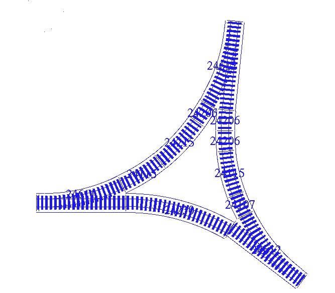

I could not find how to make a 'Y" junction with C track on the forum but after help from a web link given on the forum (http://hoexbroe.tripod.com) which is a very specialist track site - I write to the site owner who gave me the key pieces needed by email.
I then put them together on Wintrack and attach here for anyone who wants to see which C track pieces to use.
Please note - there are 4 tiny curved pieces - at each end of the curves 24230. Their marklin C track number is 24206
Greg

#2 Posted : 04 May 2013 12:30:57(UTC)
Originally Posted by: Gregzim Go to Quoted Post
(http://hoexbroe.tripod.com) which is a very specialist track site - I write to the site owner......
That's forum member hxmiesa's website.

Greg,
Ok, interesting !
But don't you think it is a little bit funny with a middle rail which goes nowhere ?Blushing
It is a pity that it is not easy to make a figure of 8 in C-Track.
I think a lot of people with restricted space would like to make a figure of 8.
Using the 'Y' would be one way of doing it.
In Marklin M-Track, there was a 30 degree angle crossing, so it would be possible.
Unfortunately, with C-Track angle of 24'58" (or something like that) it is not possible.
In a way, I wish that Marklin had made the C-Track angle 22'30" , because then that would be a 3/4 of 30 degrees, and then it would have worked.
Think about it !
Regards,BigGrin
thanks 1 user liked this useful post by Johnvr

Hi John,
Y tracks were installed ubiquitously at stations all over the world, to reverse locomotives where no turntable was installed. Of course a straight extension is required on what they call the stub end.

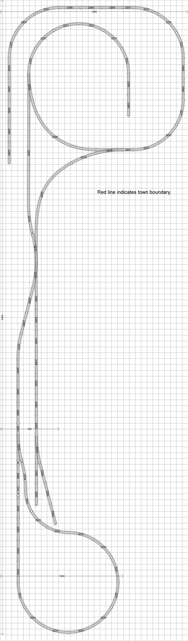

Hi everyone,
This is another example albiet a small one of a manufacturer not realy thinking about the market it serves buy picking fractional amounts for point angles it stuffs the geometry they realy
should give better consideration to such things as we are adults and understand the design principles that go into these things.Sad
However I have just spent a few weeks doing a design for a layout and have managed to design a wye using the 2271 points and the flex track but while it may look good on paper,
actually constructing it may prove otherwise.BigGrin
I unfortunately don't like the C track.Razz
I forgot to add that NSW has several such wye's Orange East Fork is one but thier are several others (Regents Park - Sefton Road ) - Goobang -
Granville - Merrylands this is the the newest one and Lidcombe - Clyde
Lidcome - Clyde and Regents Park - Sefton Road form the Metropolitan Goods line and allow direct access to Enfield Marshalling yard.
Edited by user 05 May 2013 06:21:17(UTC)  | Reason: Not specified

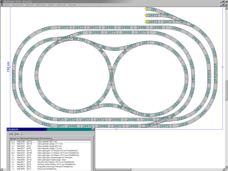

Greg,
Think about it !
Regards,BigGrin
Ok, I decided to think about it myself !
In fact, I thought about it all night last night !!
It dawned on me that a Figure-8 is possible using the short crossing 24649.
And if you work the tracks you could make a "Wye" with some modification.
So now those of us with restricted spacial area can make a Figure-8 Cool Cool Cool
See attached diagram and track requirements :
Regards,BigGrin
Johnvr attached the following image(s):

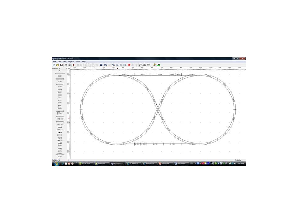

I finally found an 8-shape C track design. No bends at all!!!
It actually is not my success, because I foud it in a German site: http://www.stummiforum.de/
Here it is:
http://www.stummiforum.d...pic.php?f=24&t=55294
It's the perfect one, and can be build with just 1x24624, 20x24230, and 4x24215, if you take all the turnouts out of it. Simple and perfect!!!
thanks 1 user liked this useful post by Demau
#17 Posted : 08 November 2014 07:24:47(UTC)
Posts: 15,475
This one?
