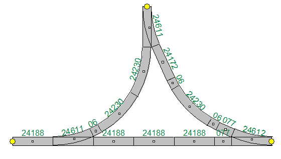

Could someone tell me the combination of c track to make a y turn around?
#2 Posted : 21 September 2014 22:10:36(UTC)
Posts: 15,475
Welcome to the forum!
Are you looking for something like this (instead of 24230 you can use 24130 for a compacter version):

Here is what I quickly came up with SCARM software. I'm sure there are other combinations but without a 2 way Wye switch it is more difficult.

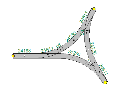

Thanks to you both, I am trying to make the Y off straight line, tight as possible. Hope that kind of explains it. I am new to this, and model rail.
So maybe rather like this:

Posts: 15,475
Three-way turnouts can cause problems with some trains, but allow an even compacter Y:
