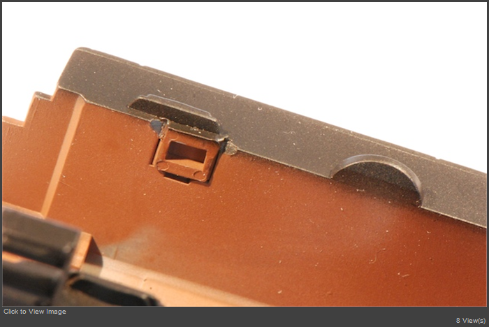

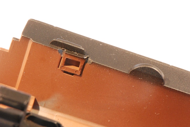

On some models of the crocodile the front and rear part of the body shell are really difficult to remove. The body parts' slots click into the mainframe. You could try and gently push a small piece of wood in between
the body shell and the frame. Said connection is next to the main drive wheel. See pictures below. One picture is of the frame and its "wedge" shaped part that clicks into the body shell. The other picture is a close-up of the inside of one of the body shells. The pictures taken are that of my newest croc the 3956x type, however the construction of the older type like the one in the 26730 ( loc 3756 ) set is identical.
On the other hand I don't think it is really necessary to remove the body in order to get access to the axles. When you remove the plastic part which Svein already mentioned, you have better access to the axles, especially the axle that replicates the drive unit. Not only is this plastic part, that models the brakes and sanding pipes, held into position by a screw but also by eight tiny plastic wedges that click into the frame. It may prove difficult to remove this part without the risk of damaging it.
Hope this helps.

If you want to remove Crocodile front or rear hoods you dont need any tools in newer (smaller) Crocodiles. Just press the hood outwards. It can be quite stiff to remove, but should be possible without help of any tools. In older bigger Crocodiles (CCS 800, 3015, 30159, 36159, 31859 and 31860 green and white versions) there is a screw securing the hoods.
As far as I can remember the hood (front or rear body) must be removed to be able to remove that plastic part near wheels and blind wheels. It was quite simple thing to do anyway. If someone can post a exploded view picture of Crocodile it is easy to see what is needed to dismantle it.

Guus' photo shows the little pins that have to be pressed in to remove the snout of the crocodile. Once I can get the cover removed, I can see exactly what will be required to fix the drive wheel so that it rotates freely and allows the rod and axles to turn freely. In any case, I want to be able to remove the shell and protect the wiring/electronics before I break out the Loctite to flush the oil/dirt out from inside.
