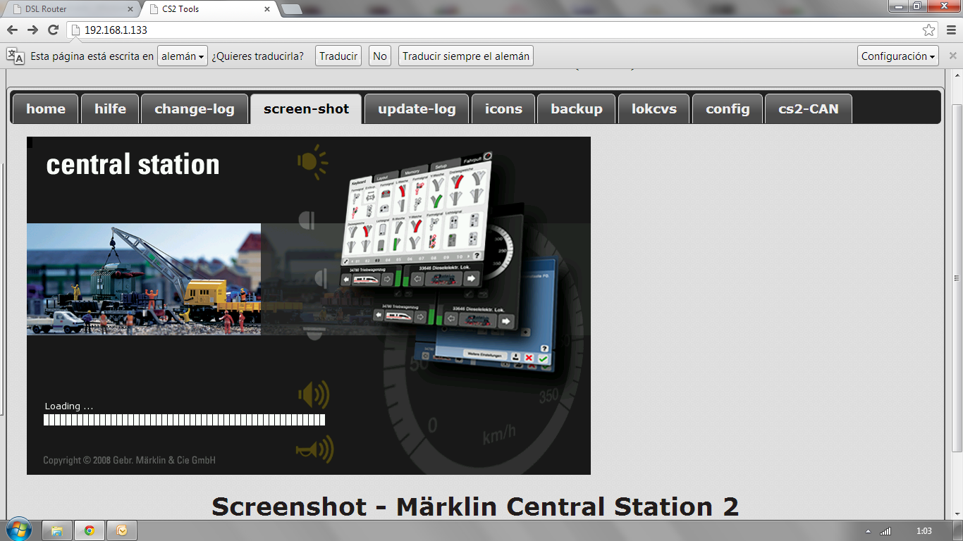

This is not a problem with the power supply. It is a problem of software. When the CS2 started it made the conventional starting process, but it never started with success.
Several minutes after plugged-in the power supply the screen comes blank. We can access to CS2 by a PC computer and make a screen shot. But here is what we see.
The CS2 hangs and never started the main program. It stayed in this state for hours and never, never got-out from that state

looks like you might have had a spike hit which has scrambled the software
so contact Frank Meyer at Marklin service
I would say it will have to go to him for a reload of the software

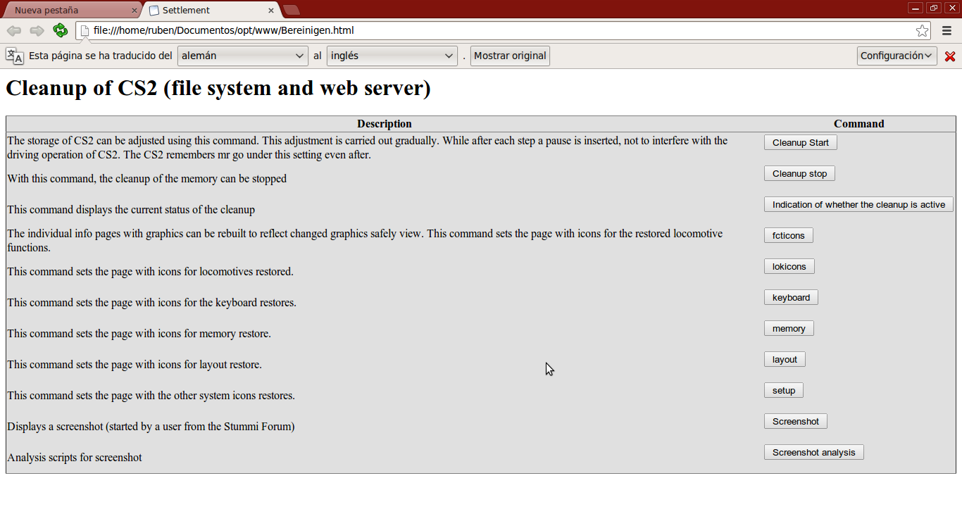

I have opened the update file (tgz extension) for the CS2. Into the folder OPT I have found another folder named BETATEST where is placed a java-software named CS2analyse. This program can make a communication with the CS2 and send commands but I do not know how it works. I thought maybe it is possible to send an update command to the CS2 to make the update or reset the device.
Also, you can find another folder named www where is a file named bereinigen.html. As I saw with this file it is possible to send commands to cleanup the CS2 but the files that should have been used for this are not present in the folder that they must be (cgi-bin).
Someone knows anything about this?
