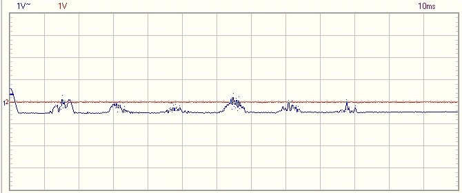

In case you are interested, below is a graph of what the pulses from the Central Station look like coming out of the full wave bridge rectifier when there is NO capacitor. That would make the LEDs flicker.

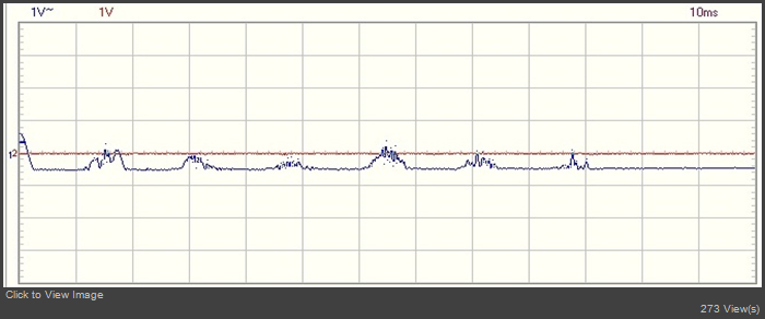

And then when you add the capacitor it looks like this. It is much smoother and the lights do not flicker:
