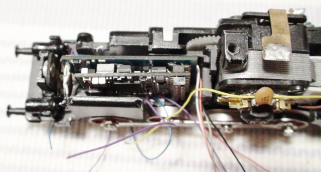

I'm just in the process of doing such a convertion including Led's, in fact I like to overhaul the whole loco
a.) brake pads
b.) connecting rods with screws
c.) 4 Auxillary functions
d.) Telex coupling
e.) 3 Leds's front & rear (incl. markerligthts)
f.) ESU Sound decoder
so far I have gone as far:
installed the leds,
installed an ESU adapterplate 51968
added screws to an extra wheel (drilled a hole into the siderod
added Telex coupling
the challenge will be finding the room for the speaker but I'm confident I've found the space for it.

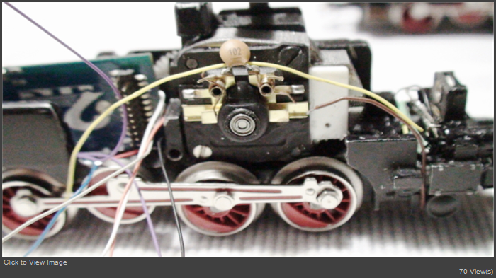

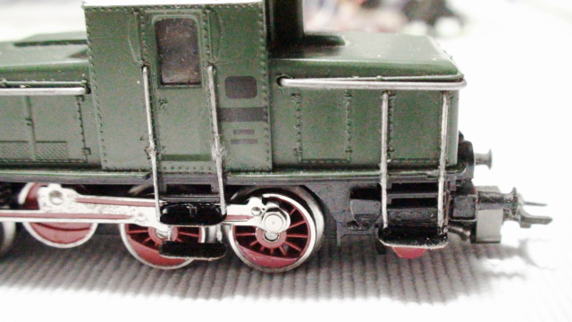

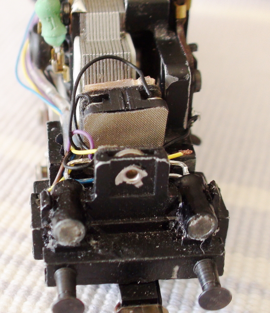

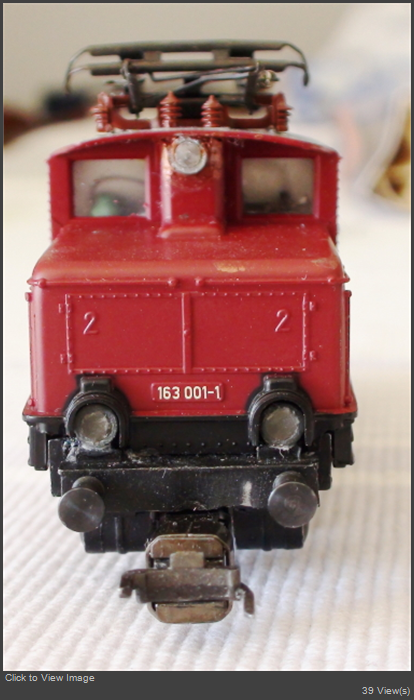

#6 Posted : 20 February 2013 16:12:04(UTC)
Posts: 14,876

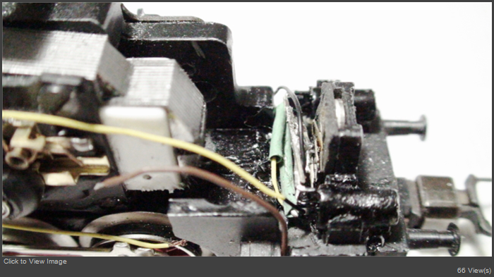

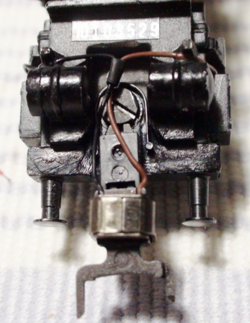

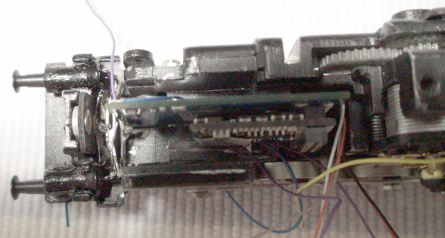

Hi everyone,

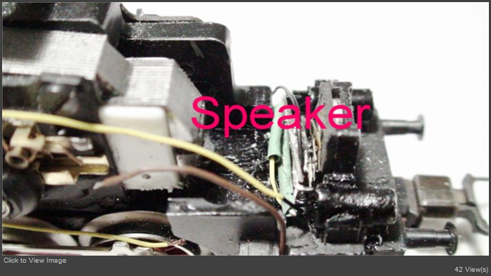

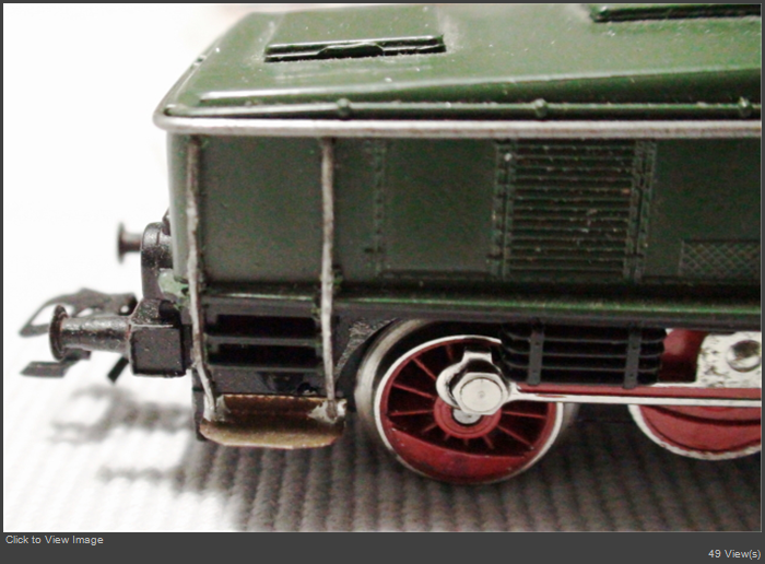

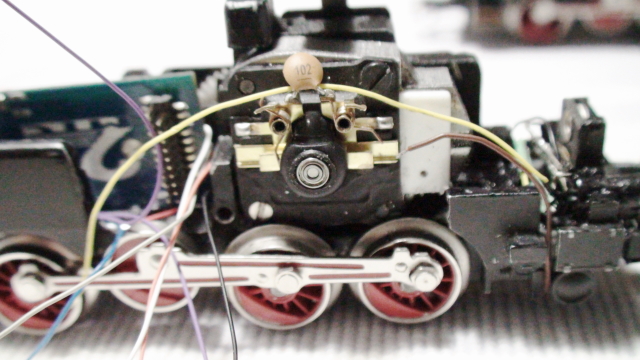

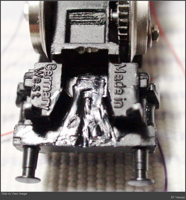

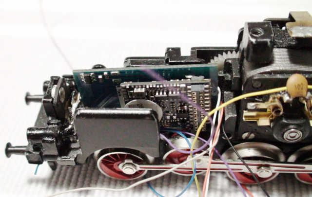

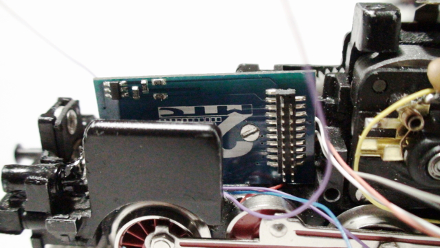

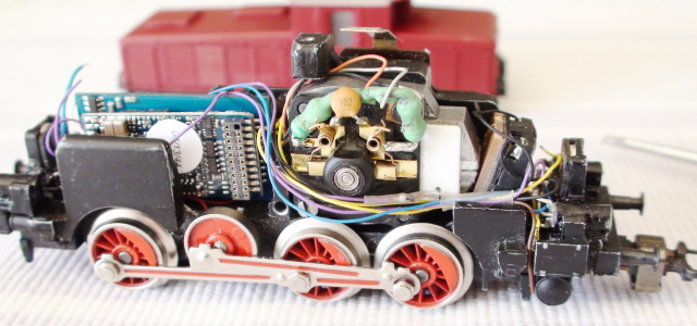

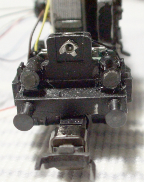

Here are the first photos from an atempt to convert a Märklin 3001, 3002 loco from analog to digital.
2 photos have a lokpilot inserted (21 pin), 1 photo has already an ESU sound decoder installed.
1 Photo shows you the ESU adapterplate 51968 (4Aux functions), Ive drilled a hole through the adapterplate and it fits nicely with the screw hole behind it (loco frame), a small thin plastic washer has been place between the adapterplate and the frame
1 Photo the Roco telex coupling
1 Photo each shows the led's,
ballbearing, here you can see there is some room behind the perm. magnet and I hope the small speaker fits into this space and this is it, there is more room for anything else.
5 pole highefficiency motor
2 photos show the handrails and footsteps
1 photo shows the other under side (doesn't look good ) but this where the 2nd Roco trelex coupling will be placed.
When I first look at the loco I didn't think it all would turn out as it has, there are improvements and new ideas with each new conversion to use the space and wire connections as wise as possible.
although some solder pads from the adapterplate are so close to a specific connection I've waved the idea to use hard wire because the smallest movement rips the solderpad off the circuitboard.
again there will be 2 micro connectors for the top lights and I hope I can work this one out as well (space)
Because the wheel frame is the same distance as from a BR 191, I'm trying to see if I can add the brake pads on this loco as well
regards.,

Nice pictures John.
I have converted one with a LP 4.0 and also LED front and rear, it works well, of course to that point you dont require major modifications of the loco.
The couplers are a great improvement for that shunter, but, where do you plan to put the speaker?
Francisco

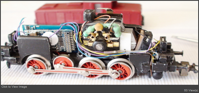

#8 Posted : 21 February 2013 03:09:07(UTC)
Posts: 14,876
Francisco,
thanks for your respond

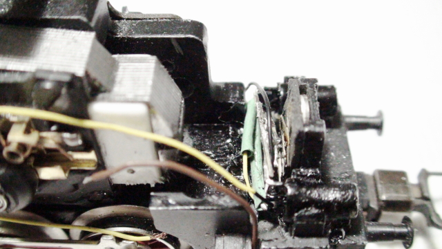

ESU has bought out a new square loudspeaker, especially for locos where room is an issue.

Hi John and all,
I have converted a couple of mine, but did not at the time add the telex coupler...now you're giving me new ideas!
One issue I had after removing the original inversion relay (replacing with the decoder) was that the loco became "unbalanced" and when pulling an heavier train in "forward" (i.e. with the traction tires aft) , it would have a tendency to lift its front wheels and derail.
Cure was found by adding a (mouldable) lead ballast where the relay used to be.
Thought you'd be interested to know!Cool

Jacques, thanks for the tip but I haven't experienced it with mine.
I'm almost finished with the conversion and yes a loudspeaker does fit behind the perm. magnet.
the crucial part was the adapterplate from ESU, being able to drill a hole through it and finding it lined up where the previous screw hole from the reversing unit was, one needs a bit of luck which you altering locos like this.
regards.,

#13 Posted : 27 February 2013 01:59:24(UTC)
Posts: 14,876

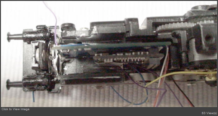

Hi everyone,

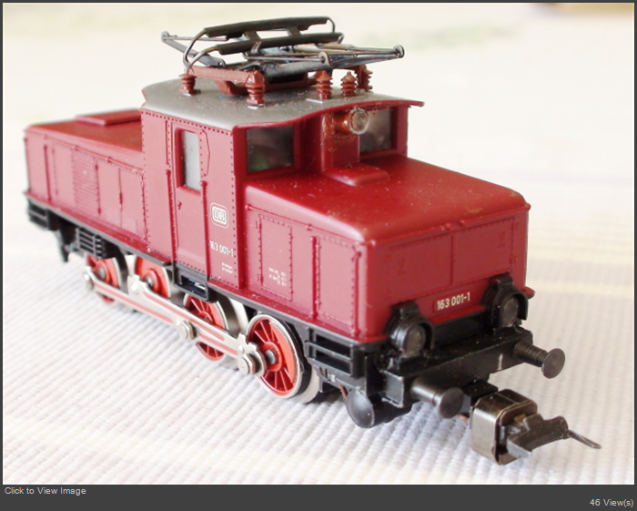

today I've almost finished this loco, sound decoder has been fitted, loudspeaker has been fitted and the sound volume works fine.
I'm waiting for micro plugs and sockets to connect the top light on both sides and have to fit the 2nd telex coupling from Roco.
I also like to add Handrails and additional steps and a prototypical pantograph
Video will follow.

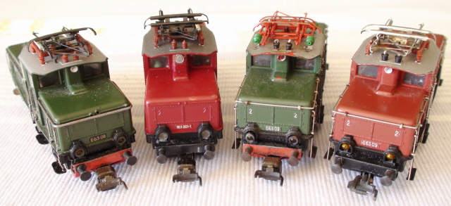

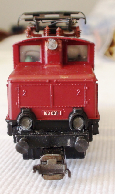

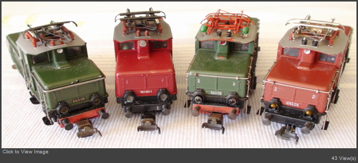

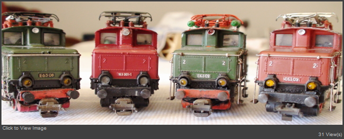

here is the rest of the family:
2 Märklin, 1 Hobby, 1 Primex (E 163, (sound)
#16 Posted : 27 February 2013 02:50:08(UTC)
Posts: 14,876
Hi John, looking great!
we need a video to see the sound working!
it maybe tempting...
Thanks Francisco,
Here is the rest of the family:
2 Märklin (E 63 02), 1 Hobby (E 163 Sound), 1 Primex (E 6308)

#18 Posted : 27 February 2013 09:02:57(UTC)
Posts: 14,876
Mark,
thanks for your comment.
at the time there only had been 2 on the market Krois and Roco. Roco had trouble producing them because of patent rights, Märklin new version telex coupler came much later so I can't tell you which one is better or more suitable.
Roco's coupler however picks up every little bit of metal you may have lying on the track, on one side a good automatic cleanup tool but on the other side it can prevent the coupling of working.
another must is for the opposite coupling to be compatible and the same height. Roco's counterpart coupling (40397) works well
regards.,

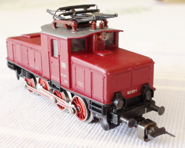

#19 Posted : 27 February 2013 15:22:33(UTC)
Posts: 14,876
Here is a short video from our newly converted DB BR 163 001-1 (Hobby) with an ESU sound decoder and the benefit having a Roco telex coupling
