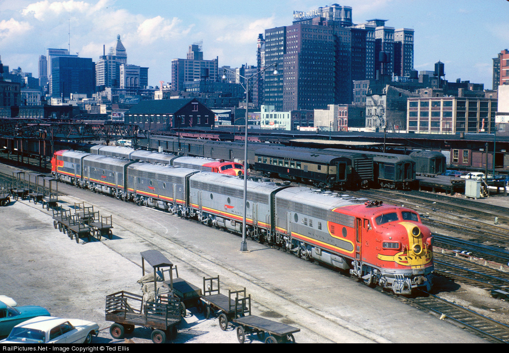

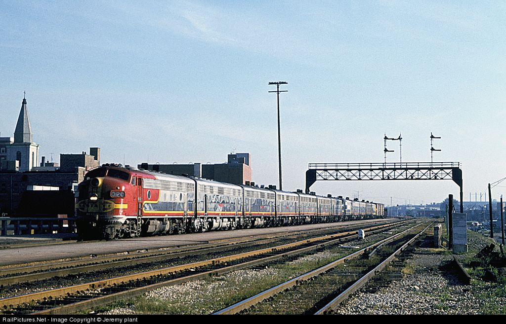

I have seen quite few pictures of A-B-B-B-A on the ATSF, but how about 12 units? one of my favorite classic shots.
A-B-B-B-A
12 F units
Gordon
thanks 3 users liked this useful post by 3rail4life

Originally Posted by: 3rail4life Go to Quoted Post
Hi Paul,
A-B-B-B-A
12 F units
Gordon
Thanks,Gordon,great pictures!
The top one must be in Chicago,right?
Do observe that the Santa Fe prototypes have an aluminium look over them whereas the Maerklin model is silvery colored.
12 units means 12 times 1,500 Hp equals 18,000 HP!
With such a power display they would tear the spikes out of the sleepers,right?

Posts: 426
Location: Northern California
Cool Paul, Glad you liked the pics, yeah the first one was taken at the now gone Dearborn Station in Chicago, July 1965 and the second shot a westbound freight passing through Joliet, Illinois, July 1973. I am so glad the photographer captured that magnificent site, I would have never thought it to be possible,Woot it's crazy. I think They used stainless steel on the sides of the locomotives which gives them that shiny look.
Gordon
