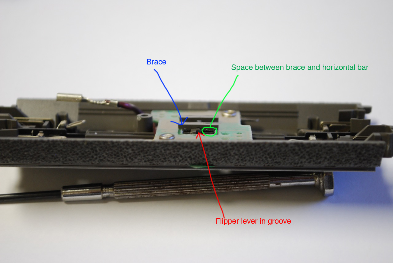

Hi All
As some of you know I got my layout up just in time for Christmas (still have Photos to post of the final assembly) Christmas 2012 Layout
The layout is essentially three independent loops with trains stopping and starting at the station yards. Two of the three track loops have the loco's run digitally (MS1) the third is totally analog. All the signal blocks are controlled in an analog fashion with circuit tracks (with the little flippers). The layout is c-track.
I have had quite a time with the flippers sticking on the circuit tracks (some even brand new that I needed to return). There have been circuit tracks that have been working fine for 3-6 hours a day for many days only to fail the next day and stick.
I have been pulling my hair out trying to fix them.
I think I have come upon a solution finally.
The circuit tracks seem to have two micro switches that are depressed by the flipper (one in each direction) and for some reason the spring loaded microswitches cannot always 'flip' the flipper lever back and the micro switch continues to be depressed and keeps sending out an impulse jamming either the signal it controls or the track turnout switch it controls freezing it in that state/position.
Upon carefully taking the circuit track apart and tinkering, I have come to the conclusion that on some of these flipper switches the friction of the flipper lever moving is to much for the small spring loaded micro switch to over come and return to the neutral position.
My solution has been to gently loosen the brace that holds the flipper in position making the flipper lever easier to move.
So far I have taken a couple of the sticky circuit tracks off the layout, loosened this brace and put them back where they are now functioning Ok. Only time will tell if this is a long term solution.
Below I will post photos of what I did
Laxman
The first photo is the bottom of the c-track circuit track ( 24994 straight circuit track ). It has been deconstructed. You can see the two braces in the upper left and the filipper lever in the upper right above the track. The flipper lever sits in the groove in the bottom of the track in the hole in the circuit board. The little micro switches sit under the circuit board (between the circuit board and the track--not seen in this photo). The two braces fit onto the two horizontal black plastic areas with the two small holes (one on each side of the groove that the flipper lever sits in). It is these two braces that I loosen up to allow the flipper lever to move easier.
Note--to do what I did, you DO NOT have to deconstruct the circuit track like this and remove either the braces or the flipper lever.
Laxman attached the following image(s):

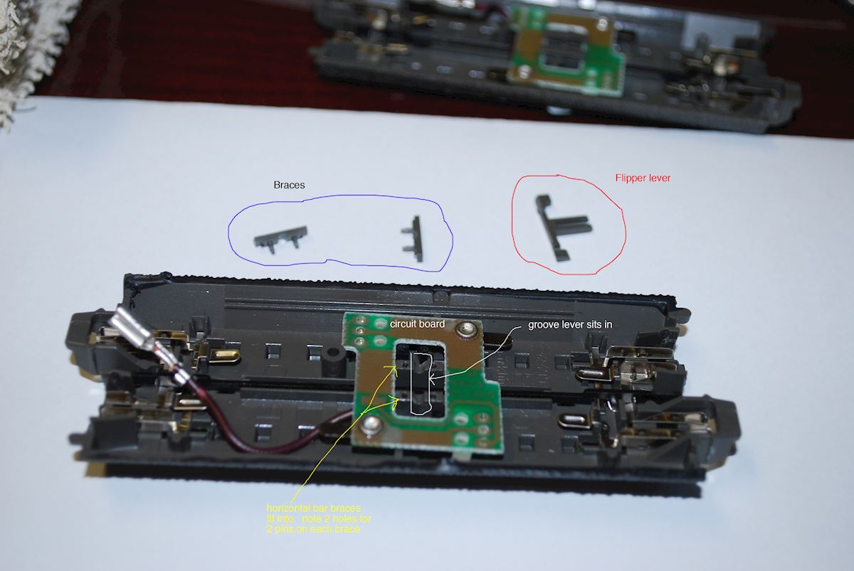

This photo demonstrates the circuit track assembled ( the way it comes from factory)
You need to identify the gap between the brace and the horizontal black bar which is circled in green. May need good lighting and magnification to discern the gap.
Gently place a very small flat blade jewelers screwdriver into this gap and gently pry apart a very small amount (1 mm or so).
Do this to each brace.
What you are doing is loosening the pressure of the brace rubbing on the flipper lever as it turns in the groove.
Now when you gently loosen these braces the circuit board will also become loose as the edges of the braces overlap the circuit board and hold it into place.
Don't worry we will fix that in the next step

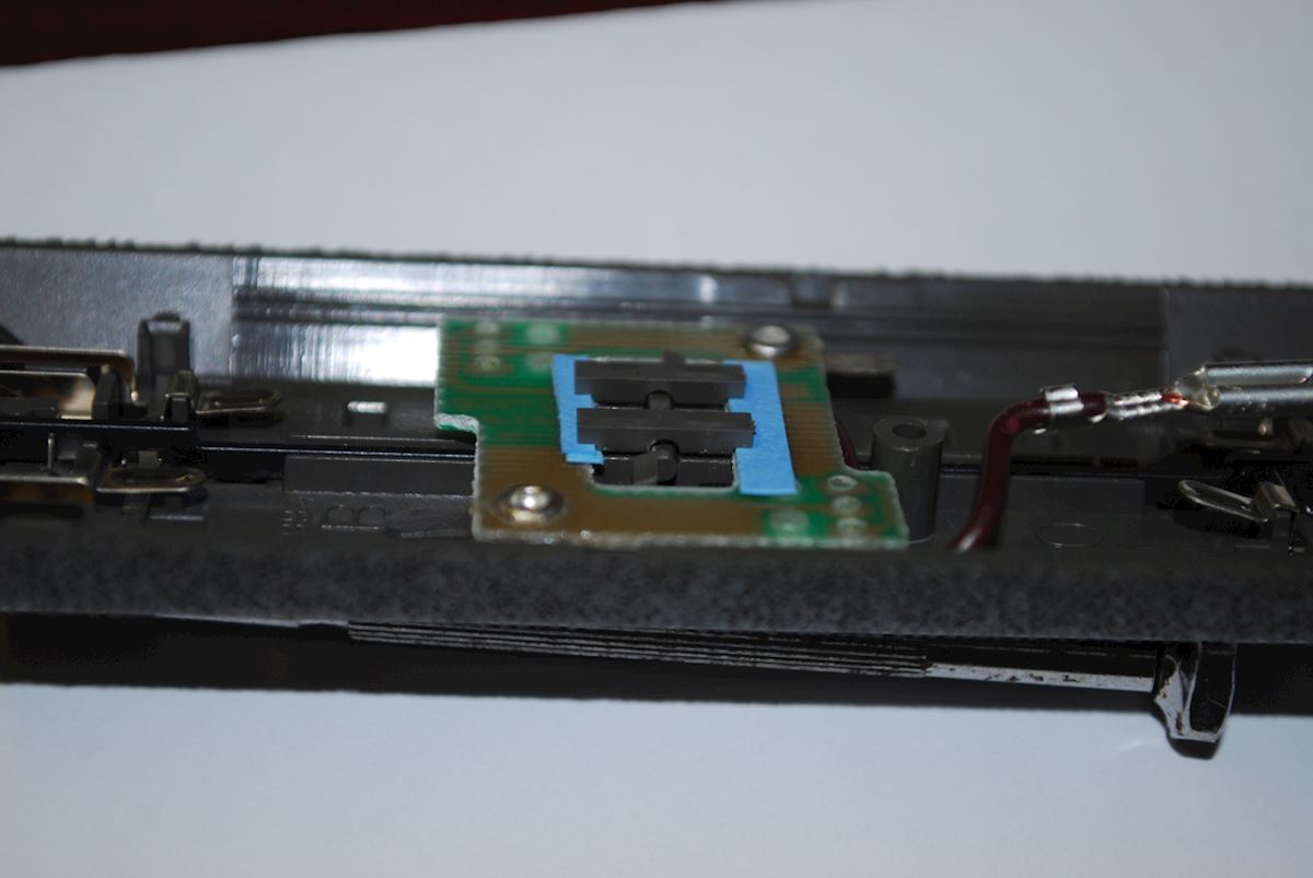

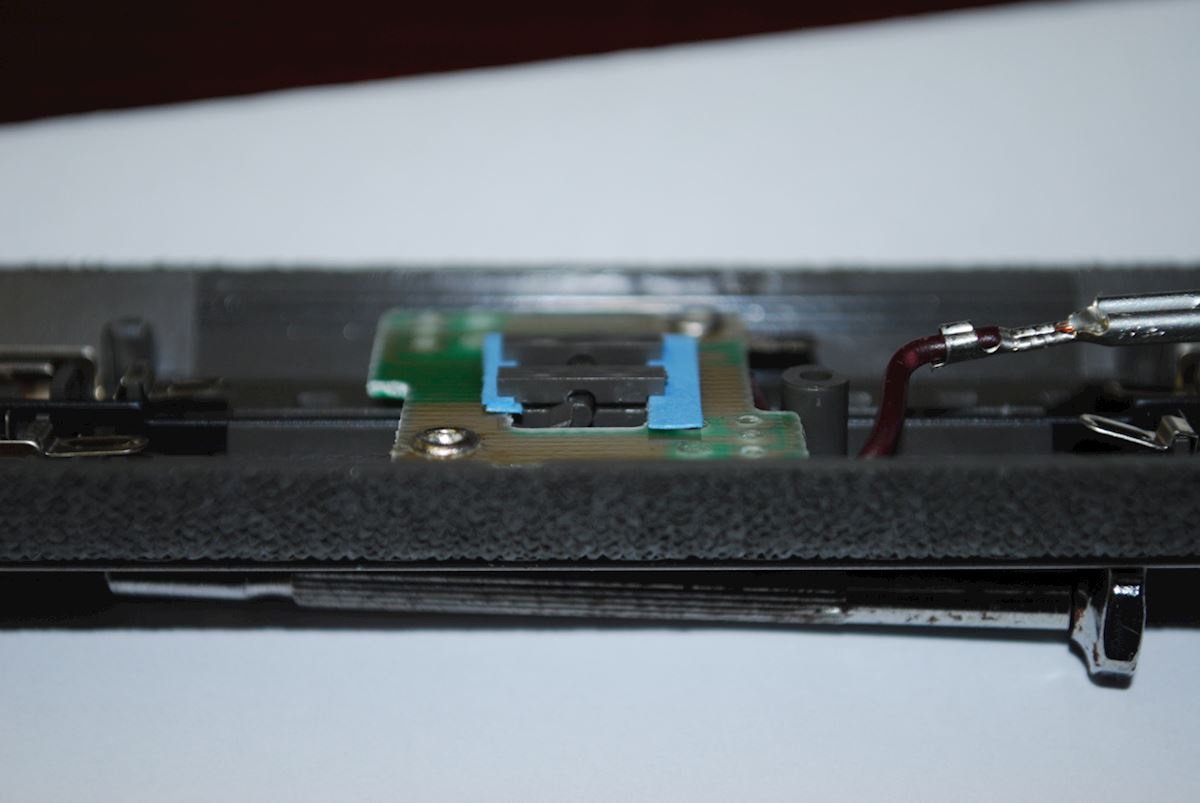

Now you will cut 4 very small strips off a regular 4 x 6 inch file card (I used a blue one)
Coming in from each side you will slide two strips under the end of each brace--(between the brace and the circuit board)
Gently press the braces down sandwiching the two strips on each side between the brace and the circuit board. This will have the effect of raising the brace up off the flipper lever (lying in its groove) and allowing it to move more freely and easier. The braces with the two strips will now hold the circuit board down.

The hope is that by raising the braces up a bit, you will take some friction off the flipper lever in its groove allowing it to move more freely and being more likely to be returned to its neutral position by the small spring loaded microswitches
I will report back if this does not continue to solve the problem of the finicky, sticky circuit tracks
