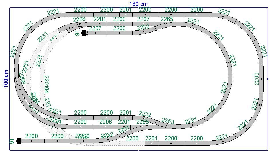

I'm getting ready to lay some tracks on my layout I want to put a braking module on my signals but some things aren't quite clear.
How many signals can I run off of one brake module?
Can I use the same piece of track, such as a turn out for the first detection track for two signals? or should these be separate from each other?
What else do I need to wire up the track besides a K83 decoder, the braking module, a signal, and track isolators? I'll be using a Viessmann semaphore signals.
I also have a CS2.
This is my track plan. I want to use the 2268 turn out on the left as the transition track. Is it to long if its more then the length of the pick up shoe or is this simply a minimum and not a maximum?
Further round I want to use the 2265 turn out and the 2232 above it as my isolated safety zones.
The two sidings will have signals but not braking modules.
Both hidden stations will have signals as well but they shouldn't need barking modules either.
Thanks in advance for any help you might be able to give me.
#2 Posted : 26 January 2013 10:36:31(UTC)
Posts: 3,555
Hello Johnny
I am using Bogobit "Bremsmodul Classic" for the following reasons:
- In kit version it costs only 11€ per unit
- It does not need a 3 track sections (interface, slowdown, emergency stops) but rather only one.
- it accomodate the temporary connection of the DC section (bracke section) with the digital section by the current pick-up shoe.
- because of the above, it can be used for multiple signals (not a huge quantity of course).
So, to make it short:
- all you need per signal is an inverter contact to connect the section in front of the signal with either the normal digital signal or with the DC voltage to make the braking.
- the same Brake module may be used for multiple signals but I recommend to group signals that cannot be used at the same time and to limit the number to 2 to 4 signals (especially if you have lighted trains).
Attention : this works only:
- if you use only digital loks with a faily recent decoder (that recognize the breaking section- not very old delta decoders))
- if you adjust the bracking "speed" so that all locos stop before the end of the signal section
On this video (my carpet train) you can see the braking modules in action:
Video-Click me
If by "signal" you are referring to circuit asscociated with each braking area - then 1 (a block home signal could have a preceding distance signal)
Conceivably - but you should not, in order to cover all situations.
If you don't have the manual .. refer ..
http://medienpdb.maerkli.../1/pdf/72442_betrieb.pdf
Note: disclaimer, I don't like the concept of these units (marklin or otherwise).
On your layout make sure you understand the limitations of running trains in both directions.
Hi Clapcott,
I agree with you, but I did away with the emergency stop section and replaced it with another transition section, this allows braking in both directions, just make sure your acc/dec are correctly set to prevent trains from "jumping" the red light!
BigGrin

Location: Lindome, Sweden
I certainly agree in disliking the concept of standard Märklin brake modules, that is, using transition sections etc.
Several reasons:
- cannot be used well in "both directions" as said.
- may cause a slight jerk when doing the transition, depending on how sensitive your loco is.
- Unneccessarily expensive.
The concept to conditionally switch to DC when the loco is well within the section is far better IMHO.
Note that Viessmann have some smart light signal control units with this functionality built in.
/l

the ide of using DC to brake smothly is as old as digital railroading, AFAIK, it was included in very early docoders designed by Lenz for Märklin. But it's true that some of the cheaper decoders thereafter have bin lacking this feature (some Delta, but not all).
Not also that the principle ofthen work also with DCC. As I run a mix of locos, with Multiprotocol, this is important. European decoders of other makes also make a gentle brake when getting negative DC. DCC states thats locos should brake but not necessarily gently. I've got that problem with an early Lokpilot if I remember correctly, and am suspicious towards US decoders.

I've ordered two of the Marklin modules from Lokshop.
I'm not worried about the extra cost over these other decoders, but I don't much like the idea of not having a safety zone at the end.
Oddly enough the Lokshop website had a better photo of the top of the module which was almost self explanatory as how to wire it up.
