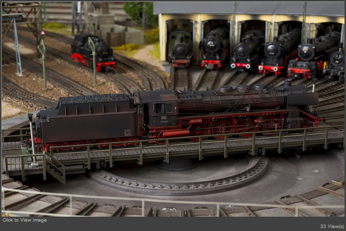

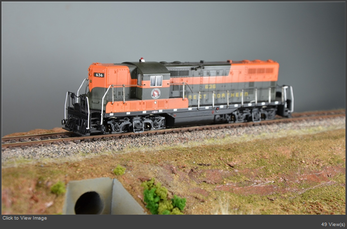

If you are not satisfied with the quality of say , Loco photos there is some software out there that Focus Stacks the picture. Ed MultiFocus.
You take a number of photos of the loco with a different focus point say 12 or more . The software picks the focus points and combines them into one glorious photo.
One piece of Software (Free) but does take some mastering is
FREE Multifocus
another simpler to use but Costs about $110 with free upgrades is
Helcon multi focus
examples. the last is the finished article. using the helicon software. (Not mine got this from a friend.)
Use tripod, shutter release, manual focus and just change the focus point, upload the photos, run the software and in a few seconds a composite photo all in focus.
Great for those of us who are not photographic geniuii.
nevw attached the following image(s):
thanks 6 users liked this useful post by nevw

I do want to detract from your post, focus stacking is a great tool especially to overcome shallow Depth of Field (DoF) from macro and close up photos, but judging by the position of the loco I would be surprised if you could not get a better image with the loco as shown in focus, as the plane of the loco is angled to the plane of the sensor, as say opposed to being at 90 degrees.
I downloaded one of the images and would note that the image has been shot with an Aperture of F8, I see you are using a Nikon 18-105mm lens which I am not totally familiar with but will have a minimum aperture of F22 possibly even lower.
I would suggest using your tripod, take some images with the aperture set at F22 instead of F8 and this will greatly increase the depth of field available in your images, and should deliver an image with the whole loco in focus. As has already been said by 'DigitalNZ' DoF operates to the one third / two thirds rule, so ideally your focus point should be a third of the way along from the front for optimum DoF, but as you are using digital not film you can experiment a little. I am not sure how many selectable focus points the D7000 has but failing that you can always manual focus.
I would add a cautionary word on autofocus; autofocus works best in good light, when there is clear colour or pattern differences, or different surfaces of textures for it to 'lock-on' to. I have found often when photographing models the focus cannot find a 'lock' and will sometimes because the focus is searching, it is possible to take an image which is off focus. Likewise I have found with my Nikons that when I chose a focus point which the camera fails to lock it will offer an alternative which might be at the part end of the model resulting in the other half being out of focus. I always check focus point and focus lock, before taking the picture. I also always shoot a few spare images to be sure.
If using the tripod I personally would reduce your ASA settling down from the 400asa these images were shot at to either 200 or 100asa, and hopefully you will seen a slight improvement in the colours as well.
The picture below (is slightly cropped) but I would feel is a similar distance to yours (distance from camera to subject was about 70cms) with a loco at a similar angle, and the whole loco is in focus, this was shot with a (35mm equivalent) 60mm Nikkor set at F22, AutoFocus, Matrix Metering manually overridden, I think on 100asa.
Experiment and enjoy.
