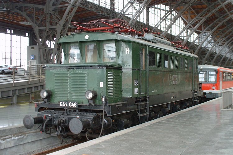

I've seen photos (like the one attached) where an E44 is clearly capable of operation without overhead catenary. Does anyone know for what approximate distance or time period can they do this?
dick_in_sd attached the following image(s):
#2 Posted : 15 January 2013 00:24:45(UTC)
Posts: 15,870
I'm not sure if this is meant to be a serious question. I don't mean to offend.
Electric locos have no means of moving without power. There are some types that can collect power from a third rail, much as the Marklin models do, but as far as I know this is not possible for an E44.
I'm pretty sure it found its way onto that turntable having been pushed by a small shunting loco.

No offense taken, but the question was a serious one. I know from drawings I have that there are batteries in an E44, and, in addition to the photo I attached the first time, here are a couple more where it seems like the locos are in service, and are in locations without catenary. I therefore came to the conclusion the batteries must provide capability for (probably limited) self-motivation. Granted, these could be static displays, but I'm still curious whether they can move at all on the batteries.

This could be a interesting topic but I hate to inflict any hope that they can move on batteries. The batteries usually only supply DC power to the the relays associated with supply pump up the Main resevoirair supply & auxilary items such as cab lighting untill the pans are raised to supply Catenary power which will cause the Air Compressor to cut in & then pump up the Main Resovoir to supply air to all operate all contactors , relays & brake pipe functions when the engine is cut in for service. Sometimes a small auxilary compressor is used to raise the Pans or even a foot pump used.
If a Elok needs to be moved with pans down usually a small diesel engine is used or a road tractor instead, on a turntable normally a winch is used to pull dead engines into place . I should say that I am going on Australian railway experience but most railways are very similar in their operation in this regard even to the point of doing a swifty at night without prying eyes of management where a Elok due for its standard maintance check would be run down under the wire with the points[switch] set for the required dead road & the pans dropped at a cruicial moment to allow the Elok to roll in with no power available & relying on the brakes for a safe pull up.
Tom in Oz

Many turntables do not have electrical wires that follow the rotating platform, but do have wires that run the length of the tracks that are attached to them. This means that the pantographs have to be lowered for operation of the turntable. When entering or leaving the turntable, the lok will use the leading panto as the trailing one would snag on the loop in the middle where the wires are all attached.
The batteries are there for power to the cab, lights, pantograph motors, horn, etc and maybe to the brake pressure generators, etc. There is no power to the motors

A bit off topic, but was this photo taken at Leipzig?

Electric loco's require 12,000 volts AC from the overhead wires in Germany,there is no way you can generate that voltage by means of batteries.
Neither is there a way to move 100 tons of steel by means of some batteries only.
Electric loco's are being pushed on the turning table (Drehscheibe in German) by a smaller diesel loco,i have seen that happening at Bochum-Dalhausen.
If you find electric loco's with the pantographs down they are either static and not moving or being pulled by a locomotive under power,in Holland we call this "opzending" ("in despatch").

To add to what has been said already, in some areas electric locos will rely on their momentum to bridge a gap in the catenary. This is done for example where bridges are not provided with catenary for clearance purposes. Enginedrivers will drop the pantographs before the bridge, coast over the catenary-less section and then raise the pantographs once there is catenary overhead. During this time batteries will take over the essential functions like lights and auxilry power.
On some border stations where two diffrent electric systems meet, the catenary system changes over halfway down the station track, and an engine would come into the station under power, drop it's pantographs while coasting to a halt undr the "foreign" catenary. A Diesel would then take away the loco, after which another loco that runs on the new system will come in and couple up to the train before departing.
Finally, in some cases, especially in the first half of the century air reservoirs and batteries did not last as long as they do now, so hand pumps were provided to manually raise the pantographs if the loco did not have enough air in the system to operate the pantographs.
Looks like the museum track at Leipzig. They have so many platforms there, they can use one to display historic rolling stock.
History electric locos are often displayed on tracks that have no catenary.
BTW: nominal catenary voltage is 15,000 volts in Germany, Austria, and Switzerland. Motors are often operated at lower voltages and those old locos have AC/DC motors similar to those used by Märklin
Here's a picture of a battery powered loco:
http://home.arcor.de/akkuschlepper/42.htm
That small battery-powered orange shunter just hauled the big diesel loco out of the shed. So it doesn't seem impossible to include this in a regular loco (but AFAIK it was never done for E 44 or E 04 or other German locos of that era).
"Drehscheibe" is the German word for turning table.
I believe the old adadge applies here; "dont believe anything you are told and only half of what you see " Wink
The '44 on the turntable was likely shunted there after, or before, being stored or worked on, in the roundhouse, or perhaps thay simply wanted to turn it.
I was fortunate to be in Chiasso, the Swiss/Italian border town south of Lugano, in the company of a few list members of this forum, prior to the 2005 M Treff, to witness how the change over of electric systems is handled. Some trains stopped at the platform and ELoks were handled, and replaced, by E shunters as it seemed the current could be switched on some platform tracks, but the Cissalpino Express Railcar Trains, from Milan and points South, could clearly be seen lowering a panto as they came into view, coasting for a few 100 meters, then raising a different one, obviuosly connected to a different transformer, and carrying on their way into Switzerland, some bound for Germany too.
We also got shunted around the platform by Uniformed Italian officials with barriers, keeping us on the "Swiss side" of the border which depended on where the train was going to. Jacques Vuye was there, if he's reading he could elaborate on this whole Elok self powered or not business. Smile
Yes that indeed is Leipzig. The Museum Loks are all parked on track 24. Track 25 is now an indoor car park. Track 1 and 2 on the other side of the building are being reworked for the new S-Bahn City Tunnel.
