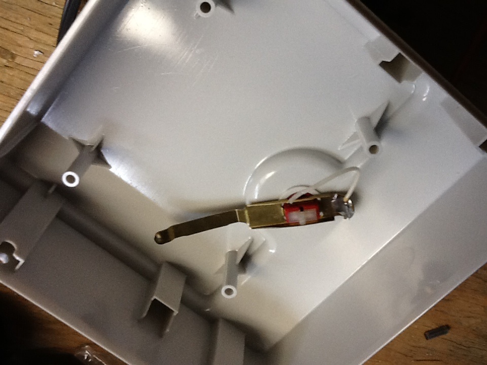

Alright, I think I found the problem.
A broken wire - just on the backside of the red dial that is the throttle control. There wire runs through an anchor point to avoid rubbing, but when throttle is adjusted to maximum position it probably create an extreme angle (add in a three year old son who frequently ( and rapidly) adjust speed) and this may be enough to create premature fatigue .
I'll include some pics.

I've got a 6646 that behaves this way as well. Were you able to fix it by mending the wire? Excellent pictures.

I haven't had the chance to work on it yet. I need to go through my bin of wires to find a nice, small flexible piece to patch in. I don't want to solder the original back together just to have it pinched at the solder point. Perhaps I can attach it via another means ( looks as thought that white rectangular clip holds the wire in place so it doesn't fall down onto the contact copper).
I may have to get some smaller solder - I want to use minimal heat and a few heat syncing alligator clips so I'm not overheating any sensitive components. I don't want to creat additional problems.Confused

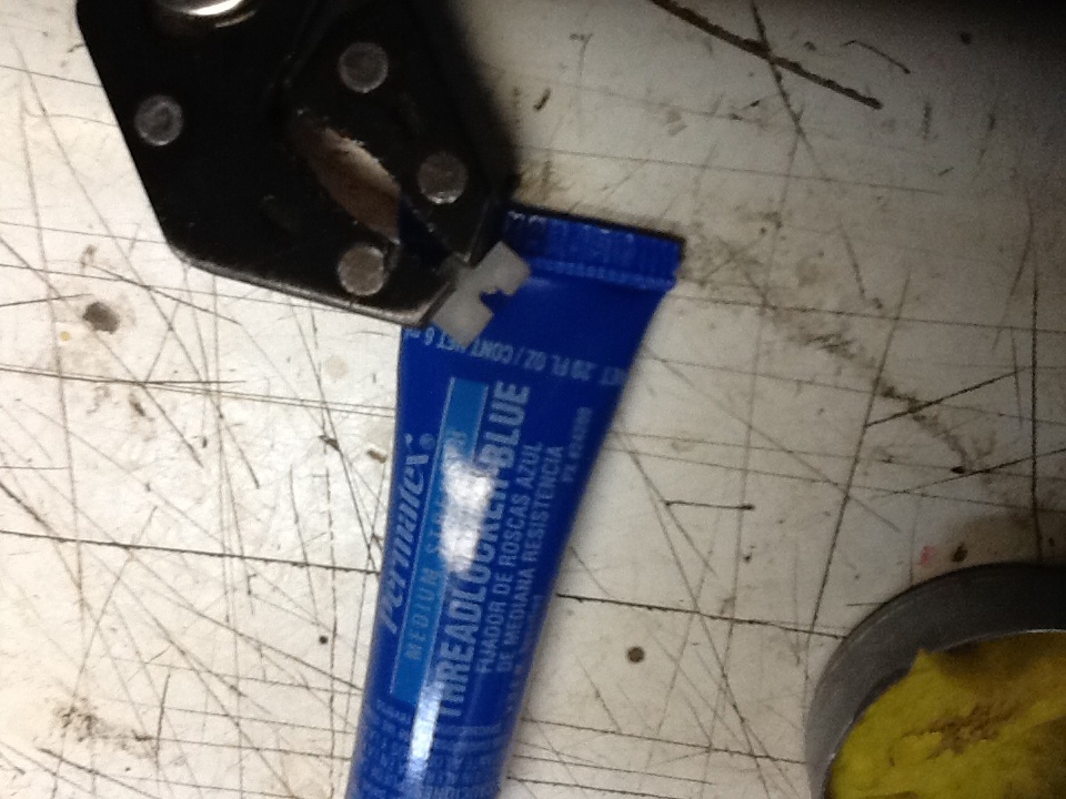

TRANSPLANT SUCCESSFUL
I FOUND SOME WIRE I THOUGHT WOULD BE SUITABLE. THE INSULATION ON THE NEW WIRE WAS SLIGHTLY THICKER SO I SHAVED OUT THE NOTCH IN THE WHITE PLASTIC RETAINER SLIGHTLY TO FIT THE NEW WIRE DIAMETER.
I HAD TWO OF THE ORIGINAL PINS INTACT SO I USED THEM TO FASTEN THE COVER BACK ON ( the other two snap out while I was drilling them out). I JUST WRAPPED THE SEAM WITH SOME GOOD QUALITY FLEXIBLE ELECTRICAL TAPE. IT DOESN'T HAVE TO BE COMPLETELY ORIGINAL FOR ME.
ANYWAY THANKS FOR THE HELP, WE'LL SEE HOW LONG IT LAST UNDER THREE-year-old TESTING!
